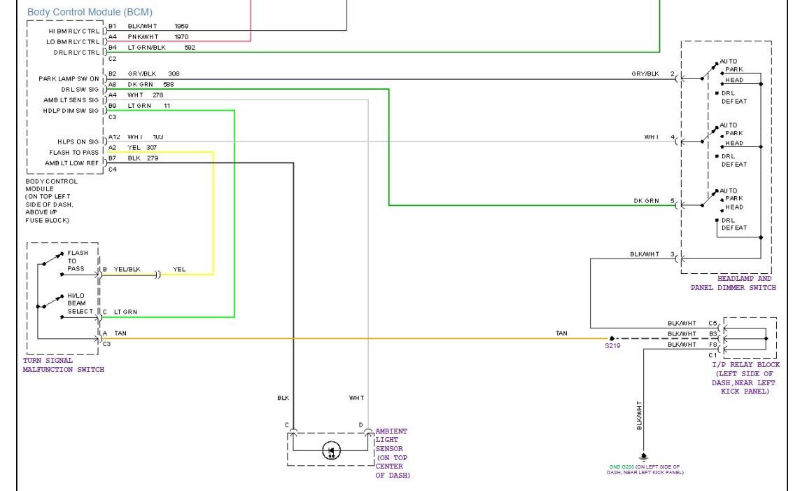

Quote from the Owner Manual,
The DRL system will come on when the following conditions are met:
  • The ignition is on,
  • the exterior lamps control is in AUTO,
  • the transmission is not in PARK (P)
  • the light sensor determines it is daytime
Refer back to the diagram posted earlier and notice unplugging the Headlight Switch is same as putting it in Auto, try this to eliminate the switch as a possible problem.
Next easiest would be to check/replace the Ambient Light sensor.
After these try RobertDez's suggestion which relate to the transmission being in Park (P)
