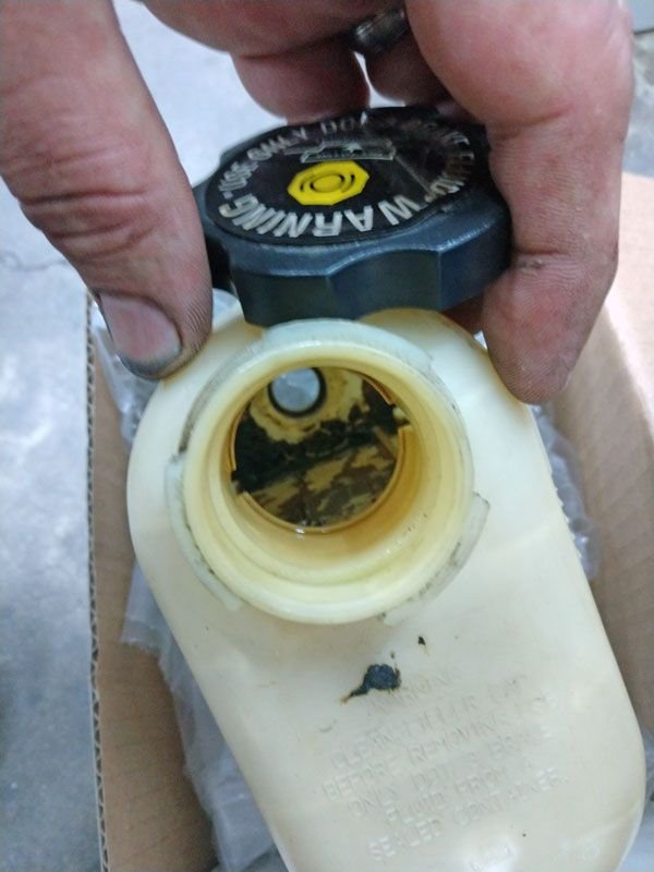

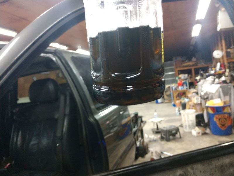

What I found on the reservoir is that it is compartmentalized inside which makes it near impossible to get all the sludge out. Probably could be done but in my case the low cost of a replacement outweighed the amount of time and frustration it would have taken to try. Plus the old reservoir was so yellowed and darkened with age that even with fresh fluid it still looked old and burned. I took a few pics... Looking down into the reservoir you can see an internal wall toward the large part of the tank.

Indeed yours is really bad, mine is probably 10% of that.

Re the Brake Fluid Reservoir, as I said mine was not as bad as yours. Since I had to come off anyway, I cleaned it out using IPA (Isopropyl alcohol - widely used in industry) which I don't think attacks this type of plastic and wont damage the float sensor. It did a real good job of desolving the residue, in fact it looked like new. Worse comes to worse I will buy a new one.
