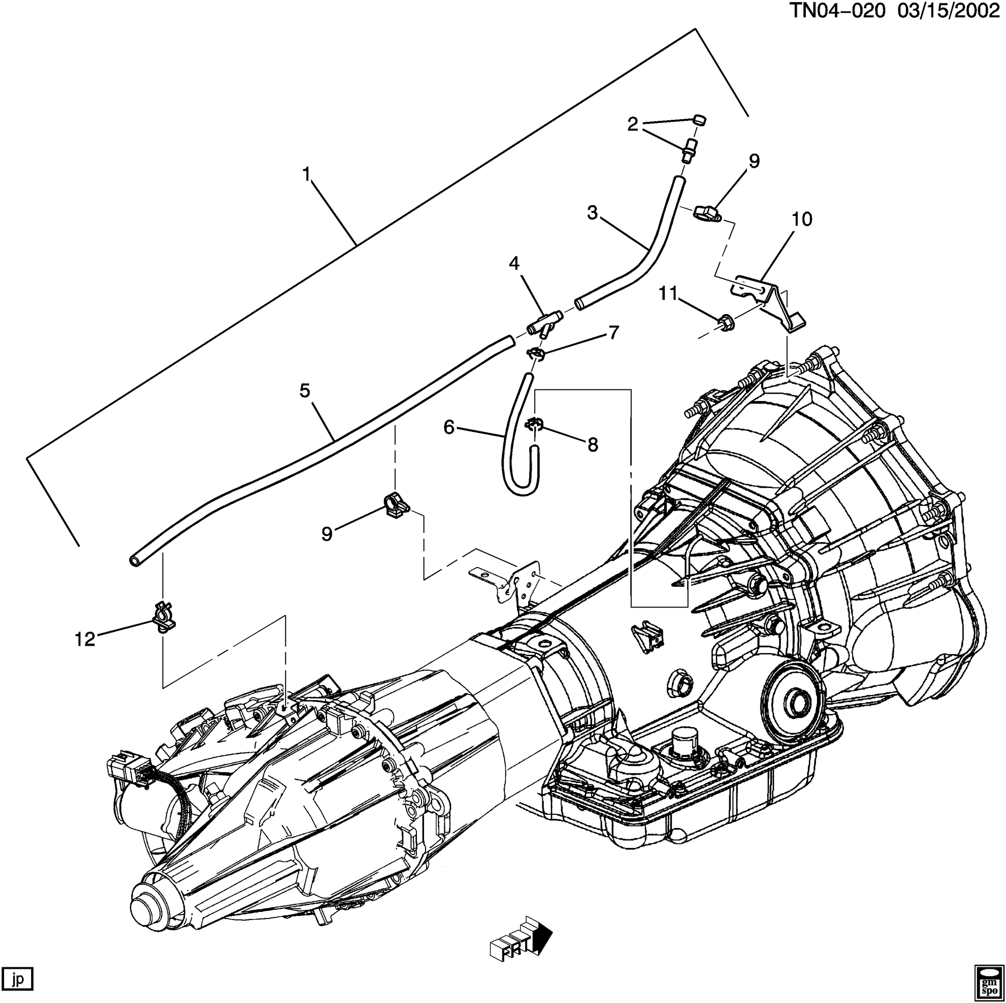

I may have found the answer in the below diagram...it would suggest that vent hose goes through the plastic clip at the top of the transfer case.....which I do have.....and is just open to the air? Connects to nothing?

That vent hose is connected to something. Otherwise it would draw water into the trany when fording deeper water. Find it!
The diagram is obviously incomplete, as is typical gfor the GM cartoonists.

I have about an hour just looking around for any possible connection for that vent hose. Driving me crazy. Rear main seal repair complete, I now have no leaks anywhere :-)
Talked with the local GM dealer about the vent. He's 'pretty sure' the hose runs from the upper bellhousing to the top rear of transfer case where it is open, and the tranny vent should have a loop where it T's off to prevent water entry when fording. The reason it's open? He suggested to let water drain out either from condensation in the line, or fording water deeper than the top of the bellhousing. That was his theory when looking at the diagrams at his end. He shows it open, no connection, but there has to be the loop before it goes to the tranny vent connection. Bizarre. Would like to confirm with someone who can visually check theirs. Thank you Neal....I will await your findings.

Well mine has no vent hose at all, maybe remembering form another truck.
I can see the vent tube coming out of the tanny but no hose connected, there are brackets with plastic retainers on top of the T-case/tranny with nothing in them not sure what happened, maybe prior owner.
Looks like I'll have to start looking for the parts to get it put back on.
Neal

spent some time looking around on the inter-web and it looks like the 08/09 6L80e is different than the 03/07 vent tubes
08/09 trans tube GM 24256930 , trans case GM 25819262, it looks like they have separate vent tubes for the T-case and the trany
I could see the metal vent tube on the trany with no hose attached, I'll put it back on the lift and see if the T-case tube is there and if it has a hose on it
Going to order both and see what I get,
Neal
