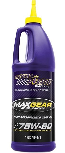

Posts: 9,014
Do more research!
Btw, I only use:
Always remove the fill plug first, if you remove the drain plug first and for some reason cannot remove the fill plug you are stuck.
It is best to drive the vehicle for a mile or so before changing any fluids, as this suspends any contaminants in the fluids and ensures they will drain out with the fluids, and not sit in the bottom of the case. The fluids should not be hot, so don't drive too far.

Do more research!
Btw, I only use:
thanks i really like royal purple and trust it! however i always see people bash rp for no reason.
kinda of annoyign when they do that.
fan boys only think redline and amsoil are above the world

I don't care what others think, I stick with what works for me, mobil1 in the engine and rp in the diffs, never had a reason to switch brands. After 40yrs driving, I'm brand loyal.
