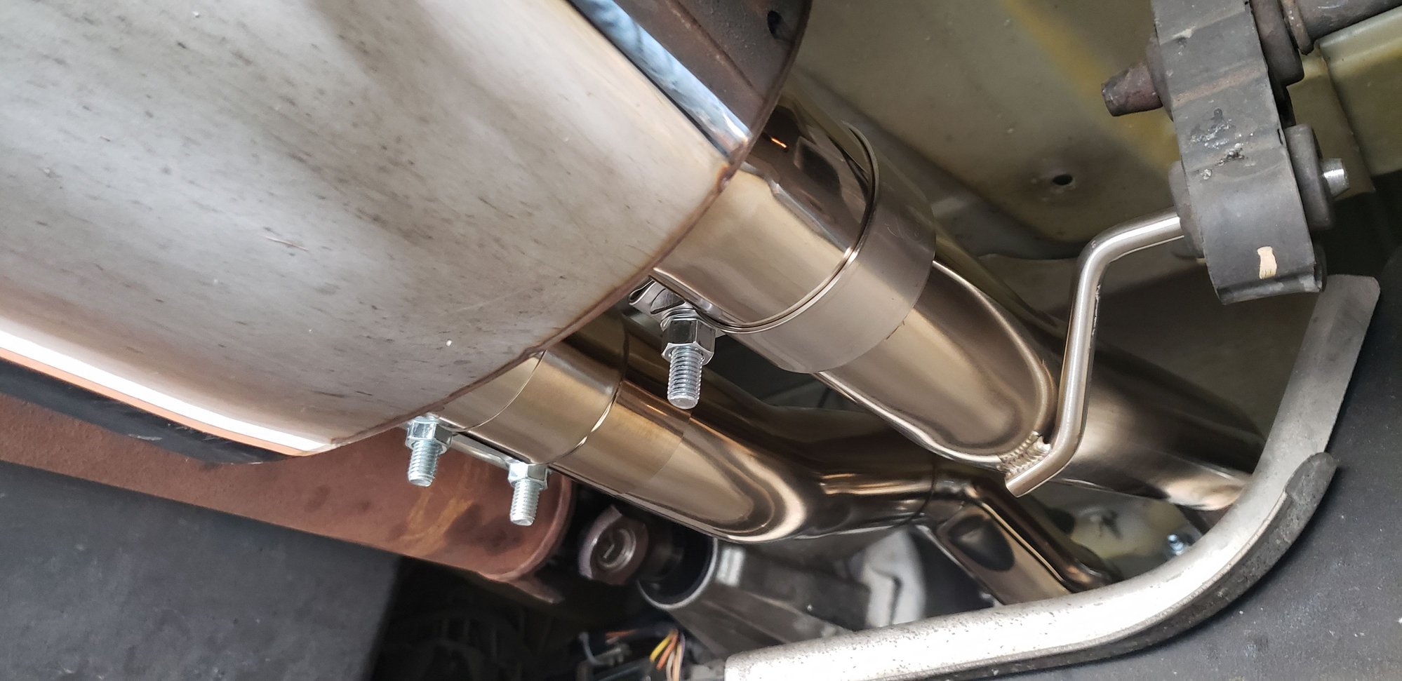

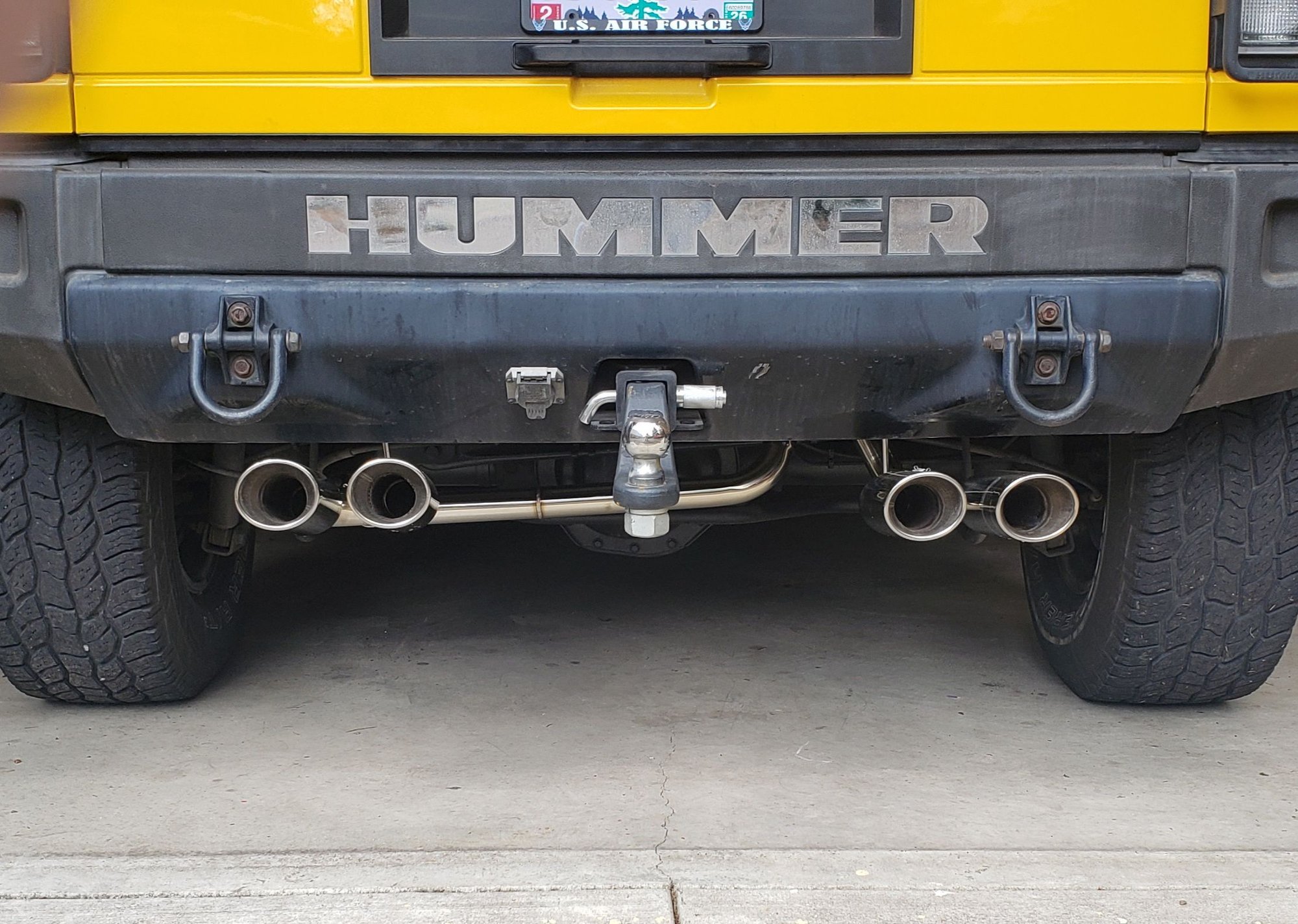

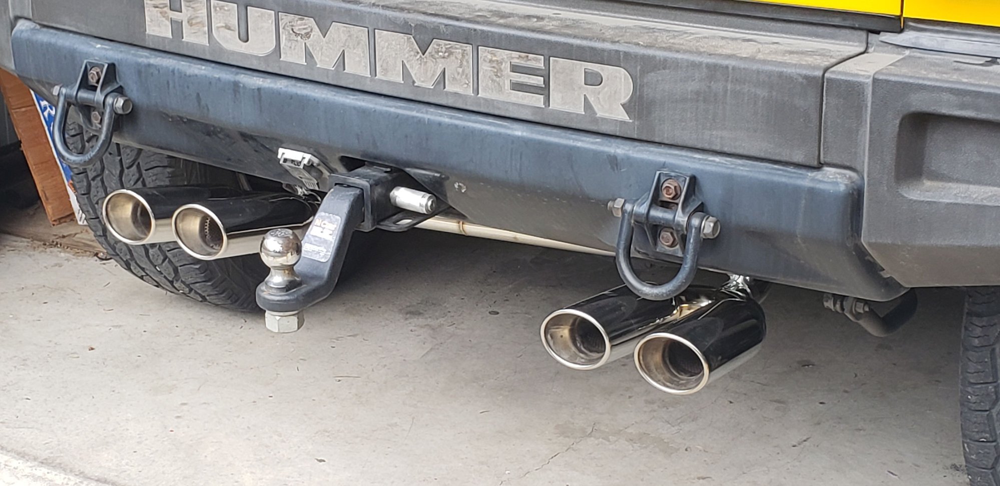

My AFE cap back system that was probably installed by the previous owner 15 years ago or more, was as loud as straight pipes and had to go according to the wife

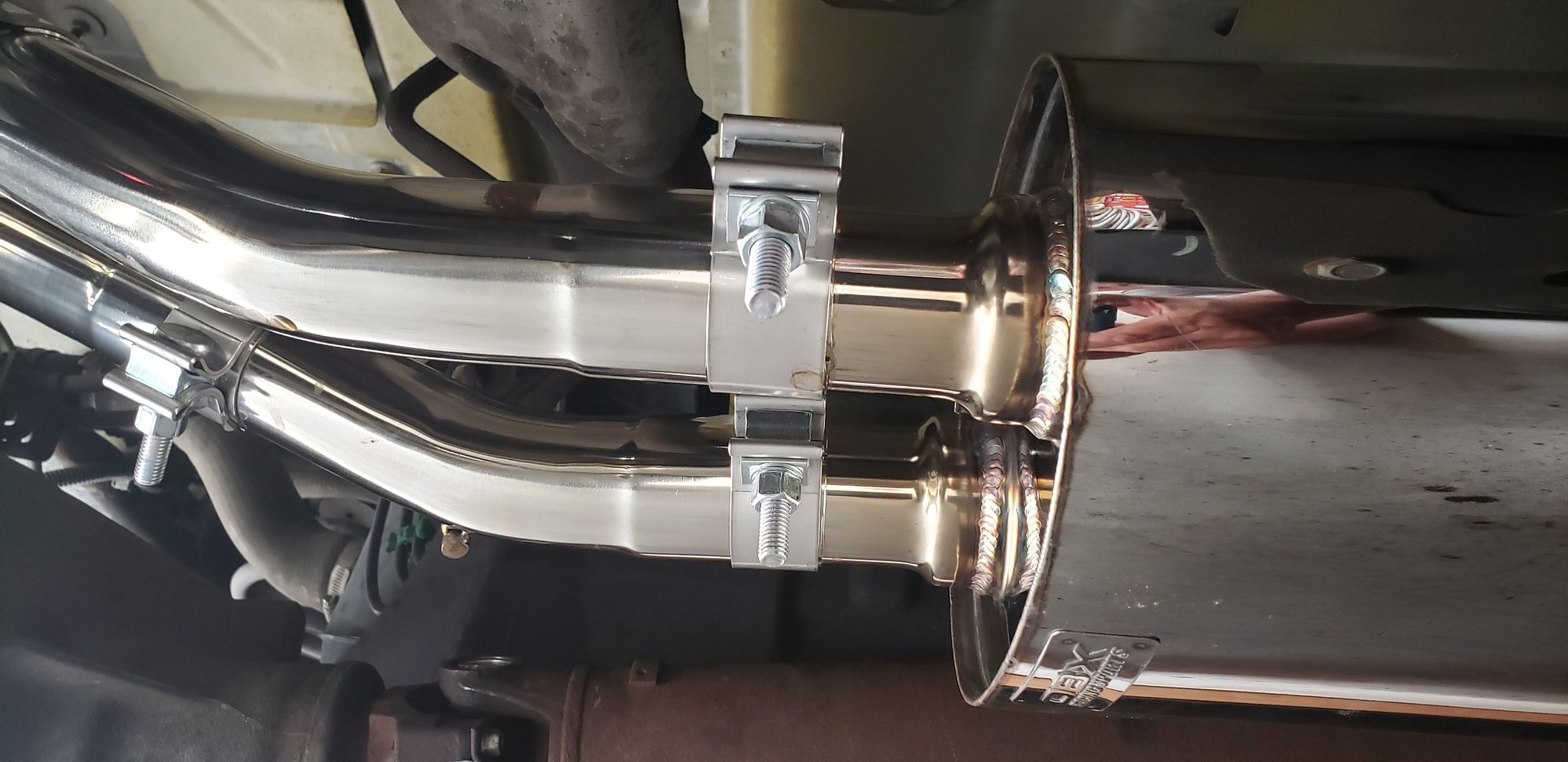

I was leery of a deal that was too good to be true on the OBX system that has the Dual in and dual out Muffler, plus two sets of twin pipes coming out the back. All stainless steel. When I talk to OBX they said the retail price depending on the vendors between 1100 and 1200. Yet I found it readily available on Walmart.com as well as on eBay for $209. I think shipping was about $60. So I took a Gamble and ordered it and it showed up looking really good. No flaws in the welds. The muffler is the stock 24-in long, the AFE that I removed was 16 in Long. And the hanger brackets welded onto the OBX system lined up perfectly with the Factory location. They give you a bracket to bolt on the driver side rear for the other set of tail pipes, using an existing hole on the rear body mount bracket. Only involves relocating the ground and inch lower. The OBX muffler has two straight through pipes with perforations down them. The AFE pipe I removed look like it made an X inside open in the middle also with perforations. Started it up and it sounds like stock. For the first time I could actually hear the engine fan sucking air through the radiator at idle. No instructions included, but none were necessary. Went together really easy. Full Throttle is a little bit louder than stock, slightly louder than our 2014 Escalade. I tested the fuel mileage on a 40 mile round trip at 60 MPH which I ran last week with the AFE system at 13.7 miles per gallon. With the OBX I ended up 14.3 miles per gallon. Quite pleased. The preformed pipes were worth well more than the $200 price tag, in the event the muffler turned out to be crap. But everything's just fine.
Old Jun 15, 2024 | 01:41 PM
RobertDez's Avatar
Joined: Feb 2024
Posts: 549
From: Oregon
Default Pipe connections
Note: the clamps for the pipes I used were aftermarket from Summit Racing. Evil energy brand. The ones provided we're not very desirable, being the u-bolt type.
