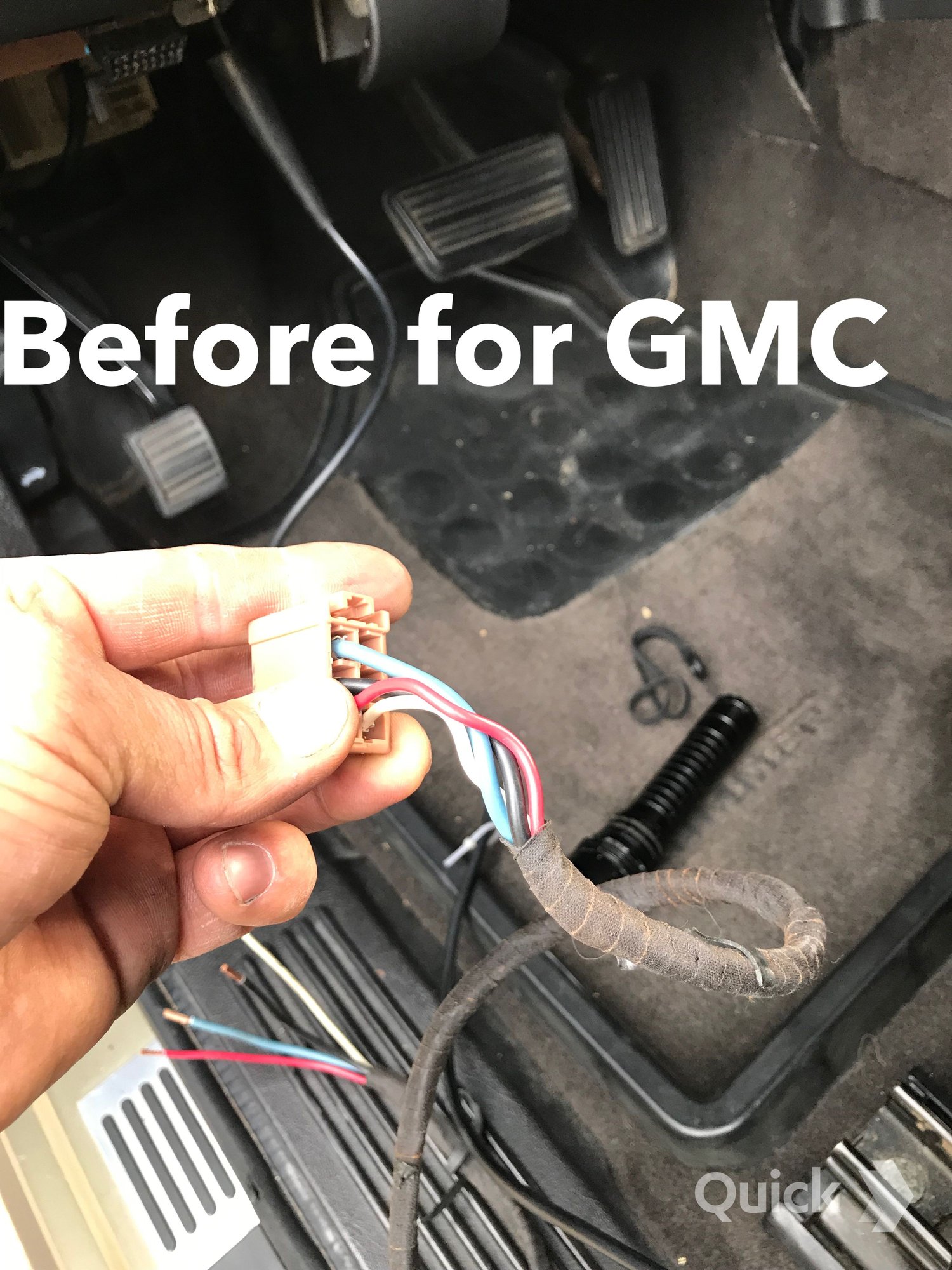

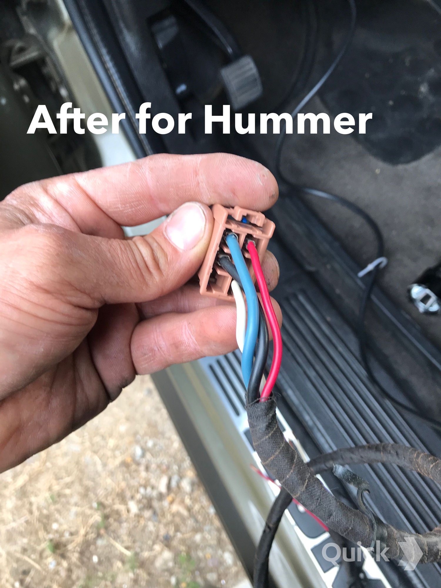

Should be plug and play with a GM brake Controller Harness. Mine needed some wires relocated in the harness, once done just plug it in and mount it.
GM Harness
Wires reconfigured for H2
