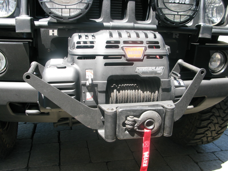

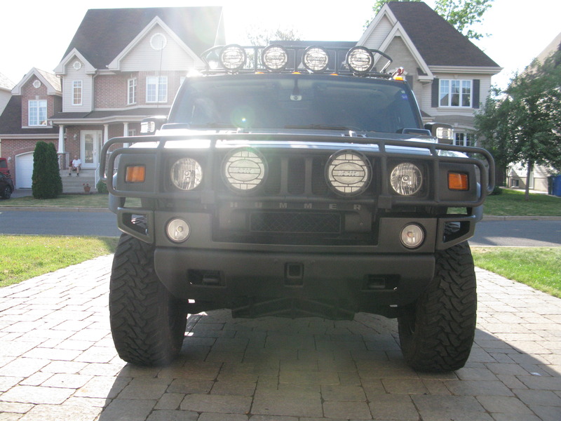

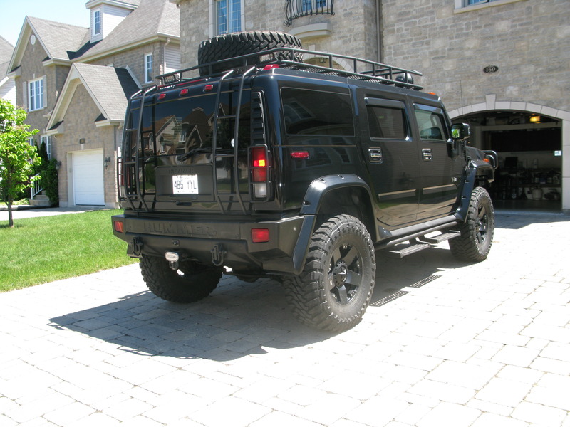

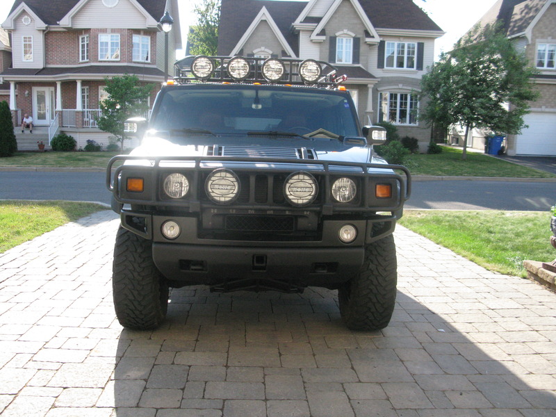

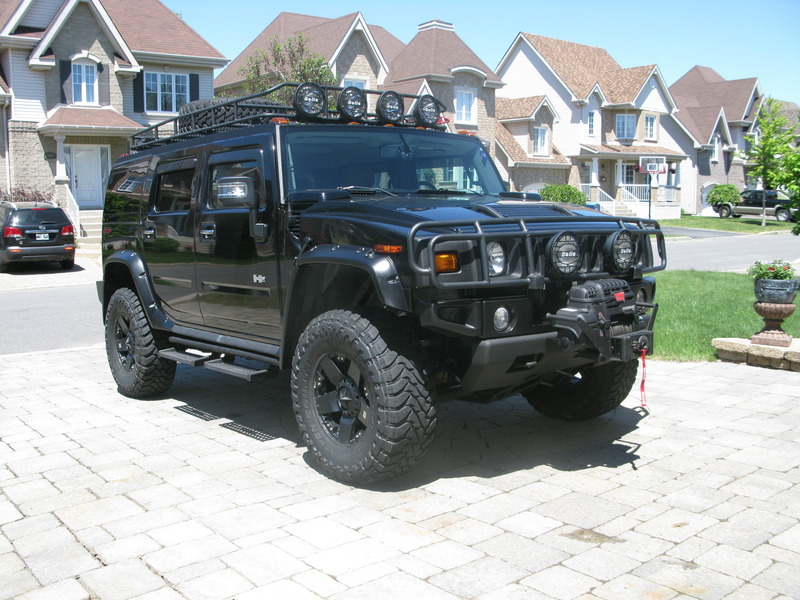

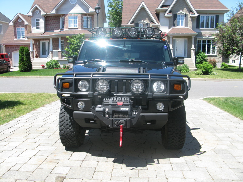

Painted black the silver front and rear bumper lower lip, u steps, rock rails Rockstar center caps and removed underbody rust. I used Rust Check Rust Paint and top coated it with Dupli-Color Bed Armor. Lot's of grinding and sanding. Still have to do the mid underbody sections and front winch.

Nice job. It looks great.

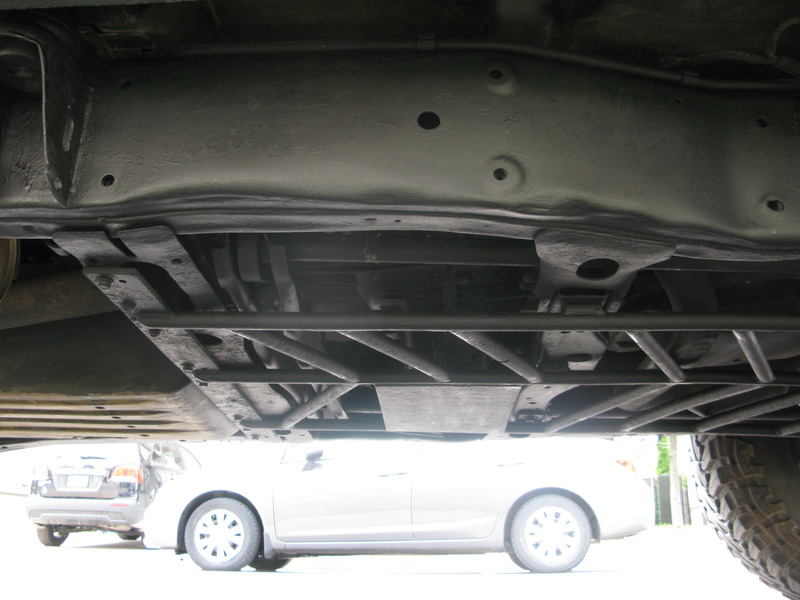

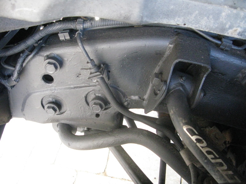

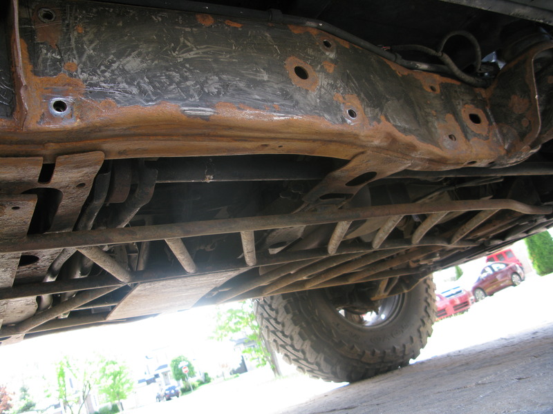

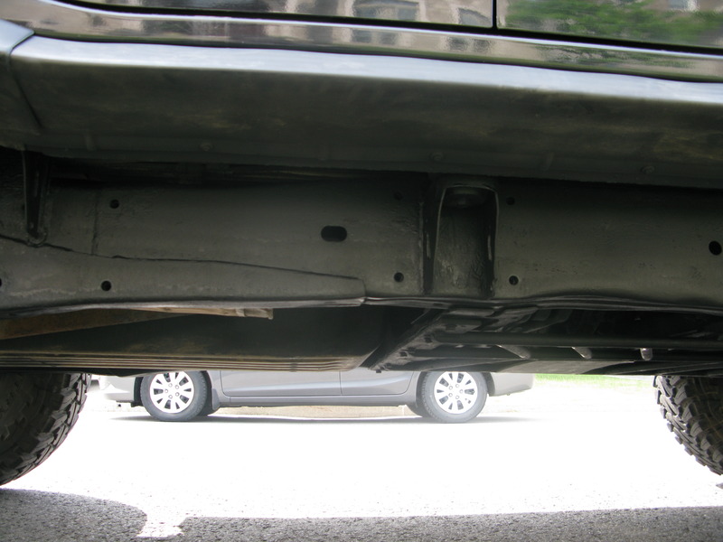

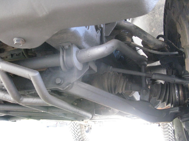

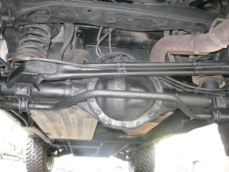

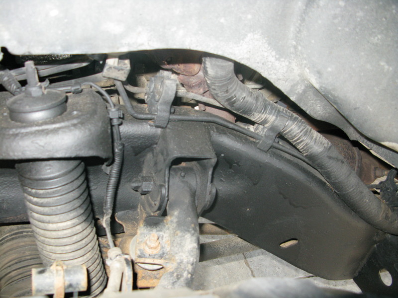

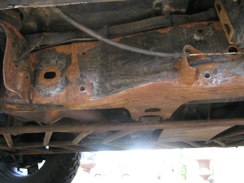

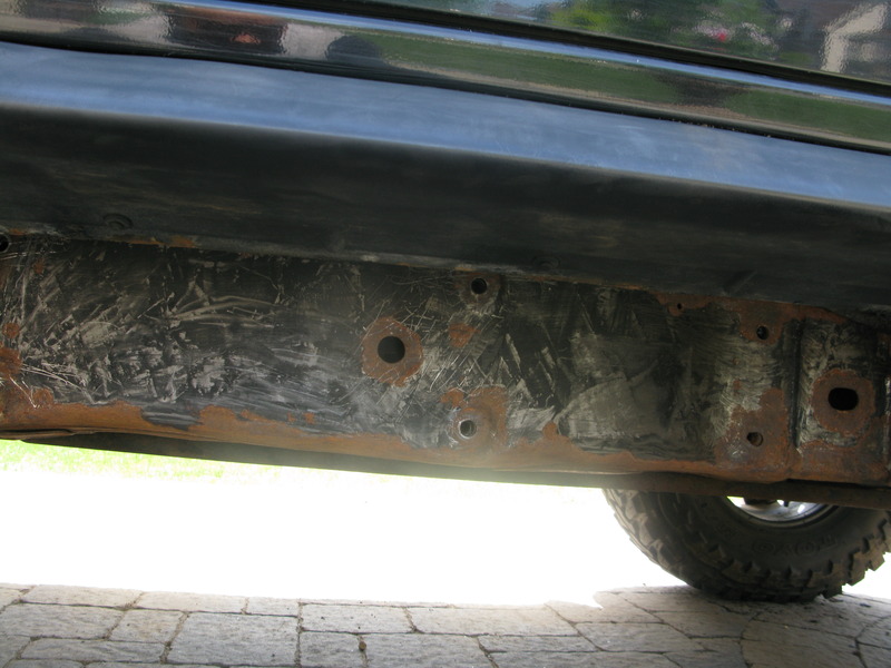

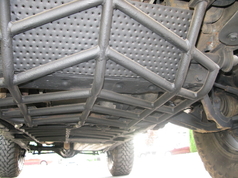

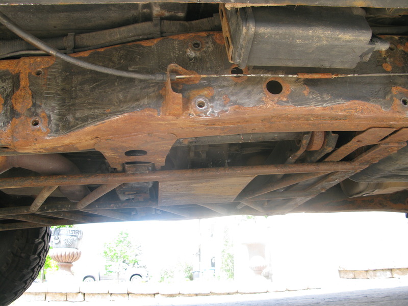

Just finished tackling the underbody.
Before

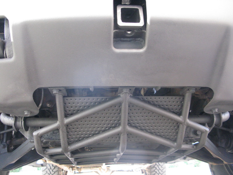

After

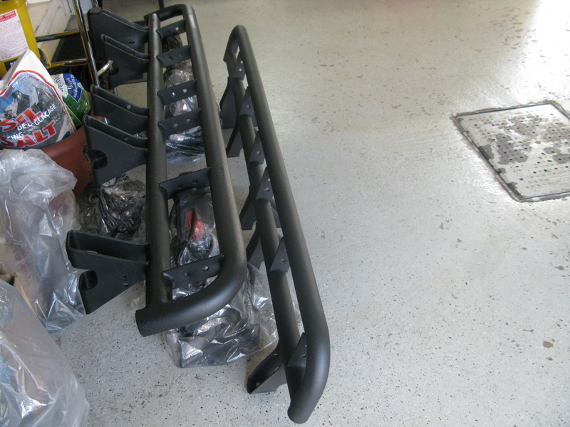

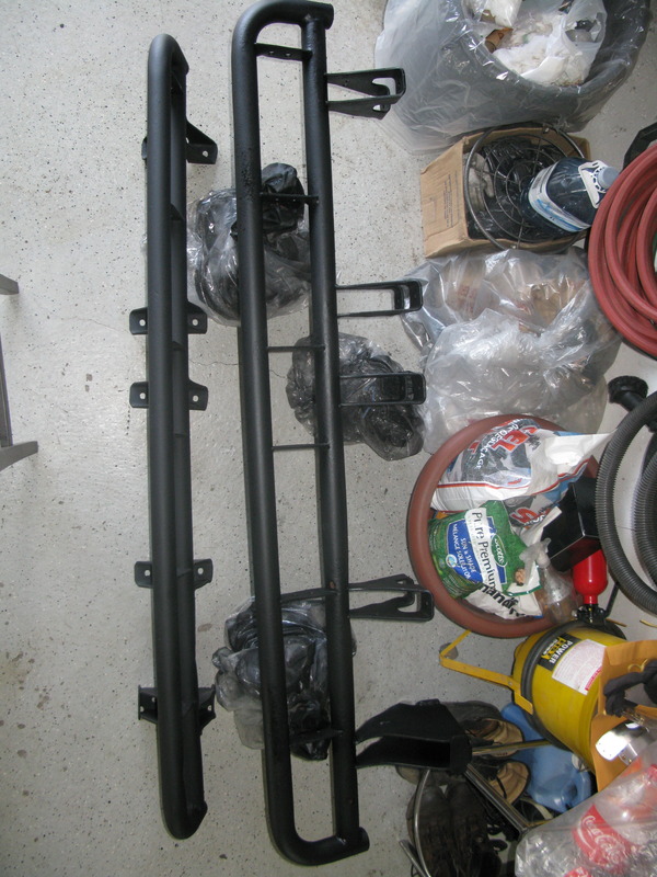

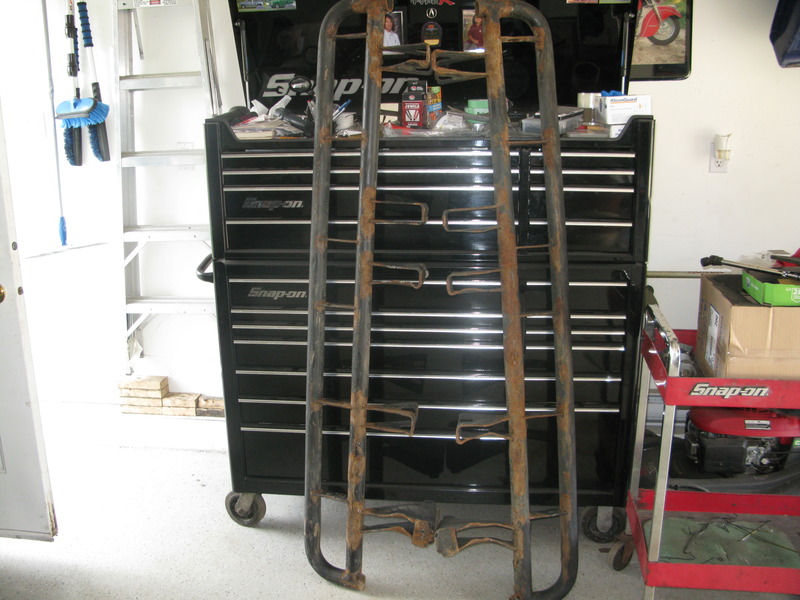

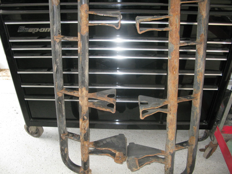

The rock sliders have seen better days, i might sand and paint it or buy a used one.

Thats a lot of work- but man your truck looks great! That is a chore i need to start working on. Mine looks rough. Thanks for the motivation!

From: Lodz, Poland
Great topic. I'm about to do the same thing with my H2. What kind of sand paper did you use to remove the rust and how many coats did it take to get that look?
Old Jun 6, 2016 | 06:54 AM
citiboy's Avatar
Joined: Oct 2008
Posts: 290
From: Delson, Quebec
I used die grinder with wire wheels, metal brush, scrapers, hammers, lot's of time and patience. I sprayed 2 coats of Rust Check Rust Paint and 2 coats of Dupli-Color Bed Armor.

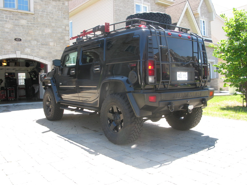

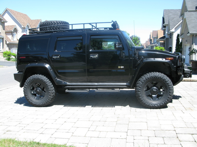

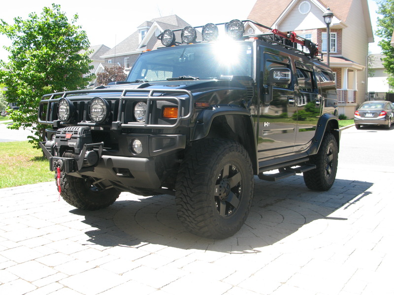

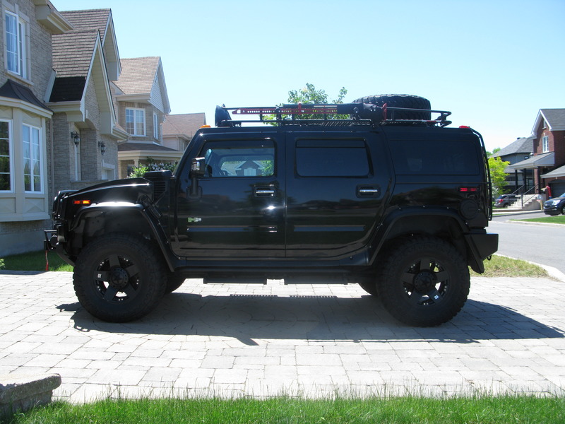

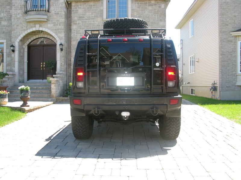

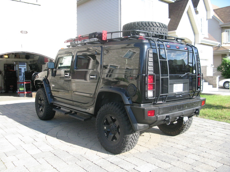

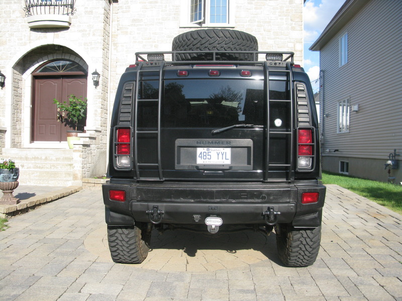

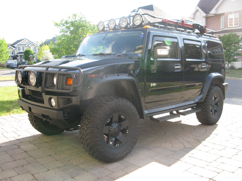

Just finished my rust removal and prevention project. Washed the 2 and cleaned the interior. Never seen my 2 this clean \m/

How are the ladders working out when you need to open the rear door?
