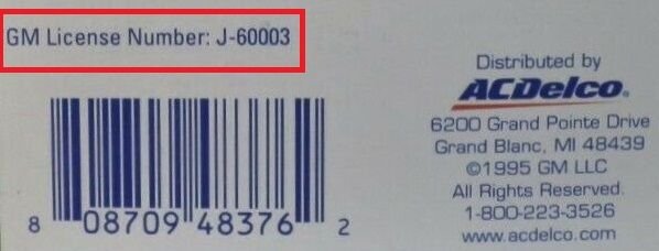

10-9030 GM license J-60301
10-9243 & 10-9244 GM license J-60456
10-9394 & 10-9395 GM license J-60003
Mine are all ACDELCO, and I buy when the price is cheap, however understand the fact that ACDELCO is just a DISTRIBUTOR! Just go to your local auto parts store, check the label on the back, and look for a GM LICENSE NUMBER.
GM or not GM ?,,, that is the question
I've requested the data from the manufacture,r but I already know their answer, they are going to say their product is made to GM Dexron VI Specifications, which it does.
The spec sheet is long and laborious, so I'll get the real stuff later. It costs double the fluid price in shipping, which is to be expected.
There's some ACDELCO DEXVI available an hour from you in Wellingborough. Dexron VI Automatic Transmission Fluid - 1 gal 10-9395
