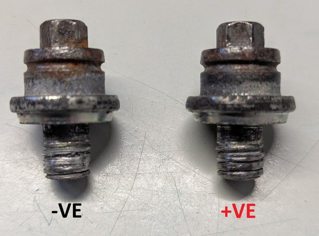

Battery terminal post screws badly worn.

As can be seen, the old terminal bolts were badly chewed-up after years of disconnection and reconnection, they pulled-out easily using vice-grips and an unscrewing action.
Once removed the insulating plastic can easily slide off to fully expose the terminal lugs and wires.
Fitting new posts was easy, again using vice-grips to push-in using a screwing-in action.
After wire-brushing the wire lugs, battery posts and new terminal bolts, the battery tester read a lower battery resistance also the engine cranking seemed much improved.
Thanks again for all the help and links 🙏

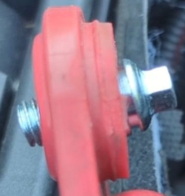

Does anyone know where these can be purchased from?
Actually just need the black protective screw cap on RHS, mine is missing.
There were some on eBay but they're now sold out.
Knowhum?
