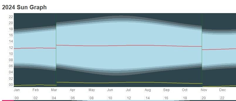

Where did you get your ganja?
Photocells are simply an on/off switch controlled by light input. I have them in my rides along with many in lights around my home. When darkness falls, all lights trigger on, no matter what time it is!
Check here for daily updates in your area>>>>Sunrise, Sunset, and Daylength

Funny Ganja is from Vietnam ...Brought some home years ago. Also Photocells varie output by light levels. Just because it's light does not mean a cell is at full electron flow or at peak voltage output. They are not an off on switch when hit by dim light. They can be made to hit a threshold you want. When hit with a bright light they will reach max voltage output. If you notice the cover over the cell is not a clear lens. It is tinted and has diffusion points and is dome shaped for the application
By the way....Great chart ...thanks..
