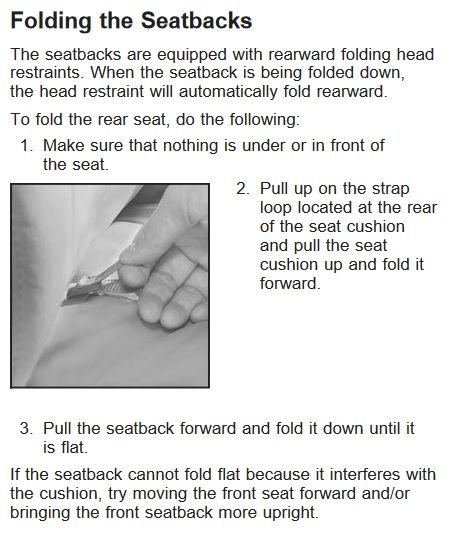

My husband passed away in February. We own a 2004 H2 and I can’t find where the latch is to fold down the rear seat behind the driver. I can’t find a video online or anything showing me where the release is and what it looks like.

there is no release you just pull the back of the bottom seat forwards like the passenger side.
Old Apr 27, 2022 | 03:46 PM
Should read the Owner's Manual before posting on a forum.

Her release cable could be stretched or broken like mine. I have to reach to the bottom left of the seat back and manually pull the release lever.

Obviously you also need help:

i had issues at first with my rear passenger release cable. it wound up being a small plastic bush had broke that spaces the L end of the cable to the lock release lever.
