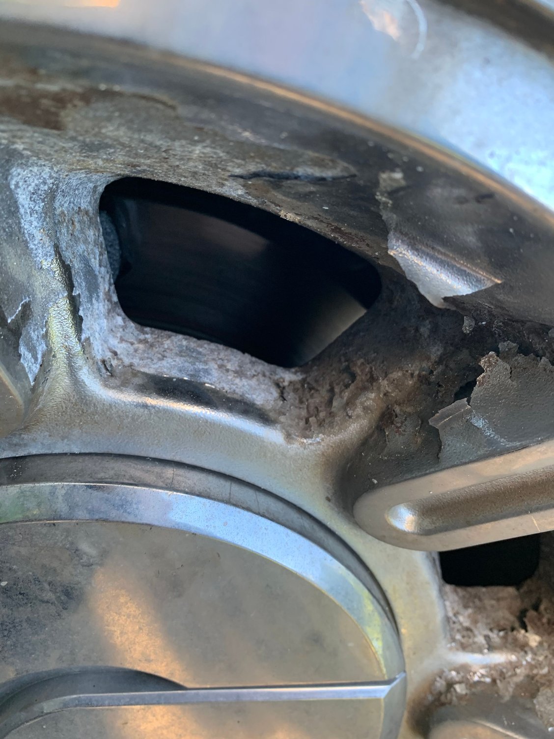

Hi Guys,
The chrome on my Aluminum H2 OEM wheels is flaking so bad. I would like to remove and repaint. Any suggestions on how to do this at home on a budget? I heard sandblasting is not recommended on aluminum.

mine are in real bad shape. Any reason why should use plastidip vs rustoleum or a gravelguard? Primer first?

mcu just like yours, mine were as bad if not worse, so I replaced them with the "alloy" version in the same Hummer style.
Have to say, that although alloys are more resilient, they still suffer corrosion, but for me were the best-fit, most cost effective solution, around $250 a corner.
This is what I found/concluded (in the UK):-
  • Shot blasting is difficult as chrome is harder than alloy, so the softer alloy gets blasted away 1st .
  • De-chroming is not allowed in the UK/Europe as the chemicals are banned, however you may find facilities in the US or Canada
  • Having said "banned" I did find a "back street" company that could de-chrome, but its quite expensive, the quality risk is high, so there's no guarentee on end results,
  • Flaking and corrosion on the insides causes air-leaks and tire deflation, so in the end you have to do something.
  • Any re-chrome would 1st require shot-blasting, or some other kind of surface preparation, followed by copper or some other pre-plating process. So in essance it's a multi-step process and likely to be expensive.
  • There are many alternatives to chrome, such as nickle-chrome, sliver powder-coat, etc, etc, which may be more durable, but nothing beats the look of chrome in my view.
  • Chrome rims do come up for sale now and then, but again the salt will eventually get to them and so in the end it will be back to "square one"
  • There are lots of aftermarket rims, but they do not compare to the original Hummer style, again in my view.
So I have a set of corroded wheels sitting in my garage looking for a solution, one day!

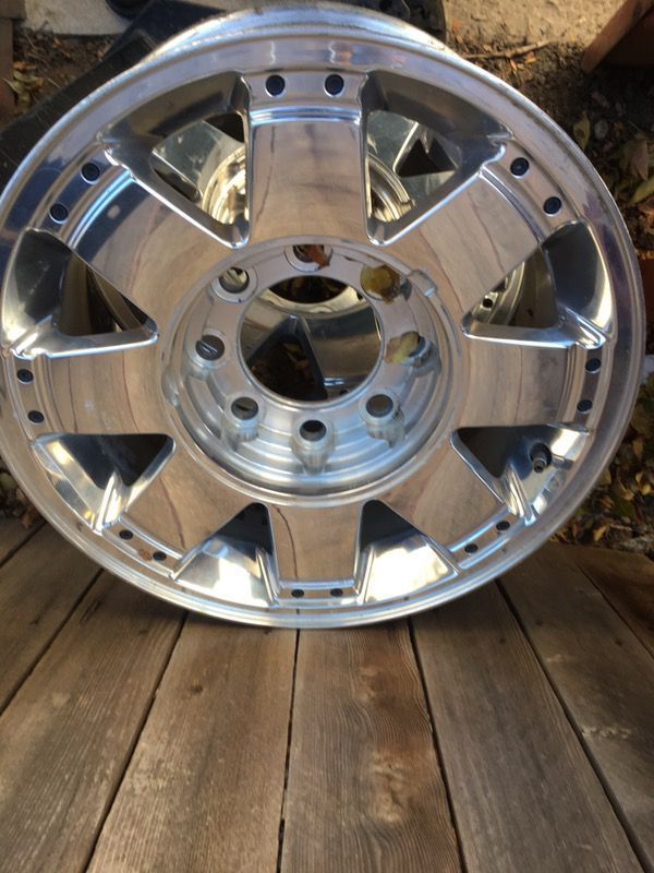

That looks like a lot more than minor flaking to me on those ones on eBay. That will only continue to get worse and worse. In my opinion, the best compromise to actual chrome are the factory optional wheels that were offered for about 2 years that are made by Alcoa (top of the line wheels) with a polished and clear coated aluminum finish. Alcoa wheels are well know in the big truck industry for their finish being near bulletproof if taken care of. That specific style are very rare to find and are not cheap though. If I had not scored a deal on the forged Weld wheels I have they are what I was going to try and find.
Pic of the rare special edition Alcoa made wheels... I've seen them posted on here before too. Can probably search for Alcoa on here and find more photos of them.
