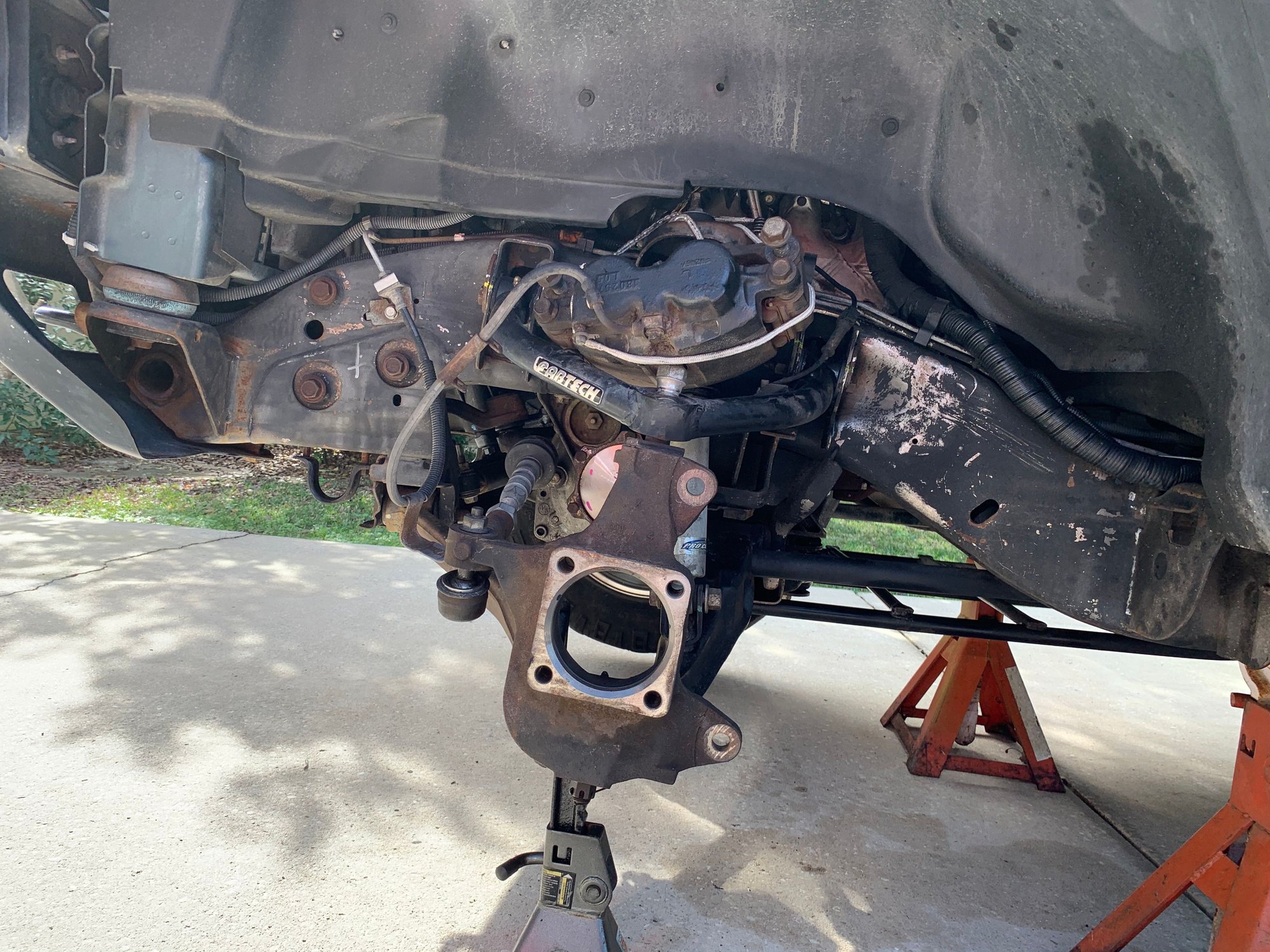

A pic of what the UCA’s look like at droop.

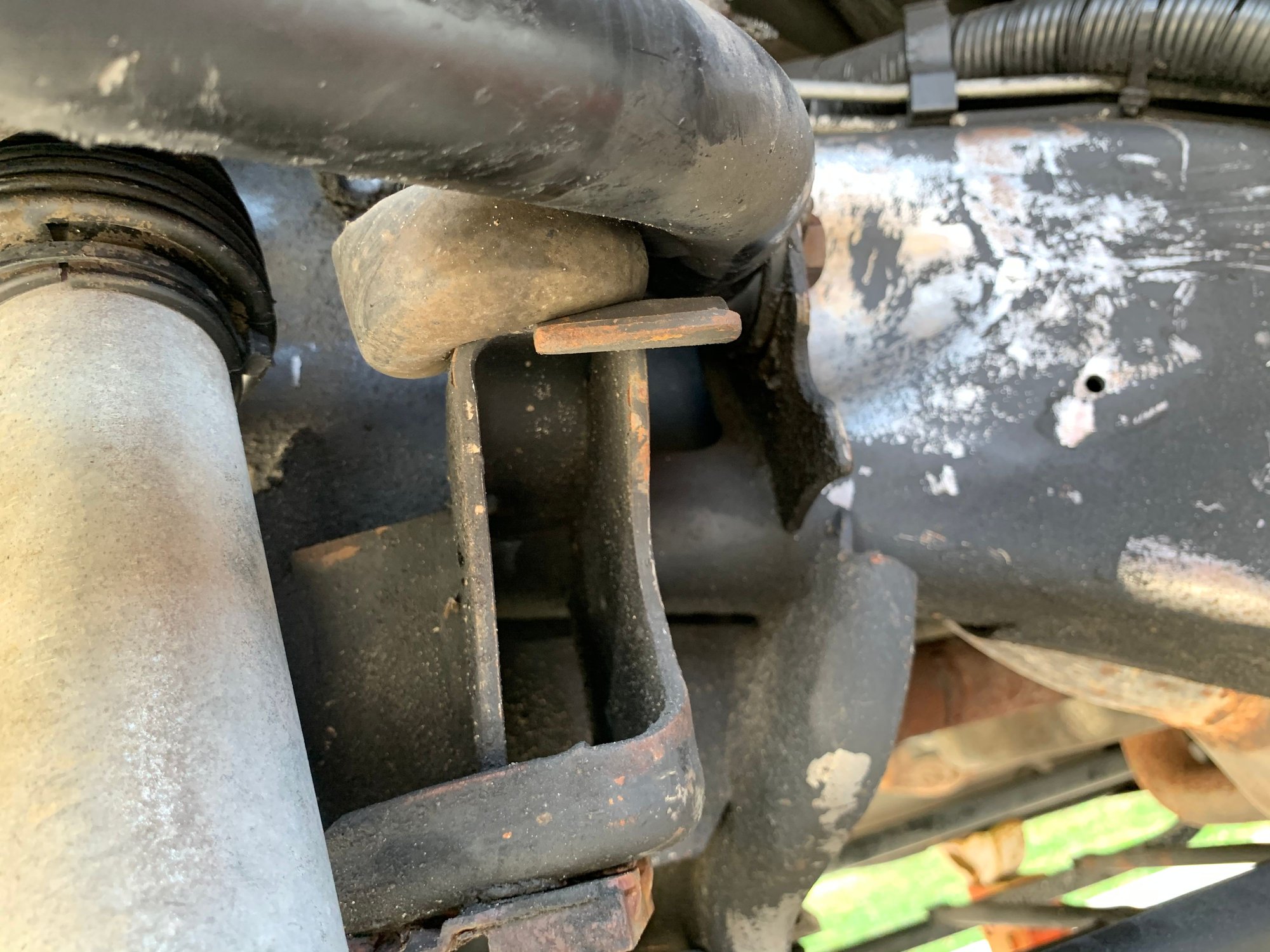

The bump stop for the Fabtech UCA that contacts the upper metal tab. I have never had it come in contact while driving/off-roading, but working on it right now you can see how it provides protection.

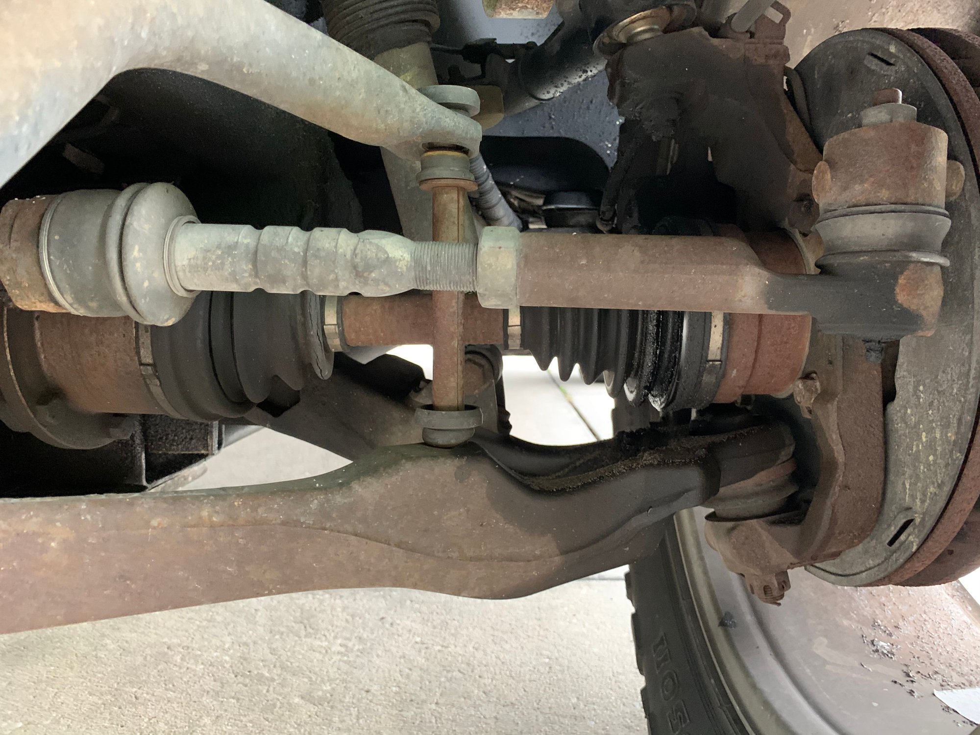

This is the angle on my suspension. Everything is nice and parallel.
Here’s some pics of the Fabtech UCA’s on my H2. The Cognito UCA’s are exactly the same and both brands are very good IMO.
