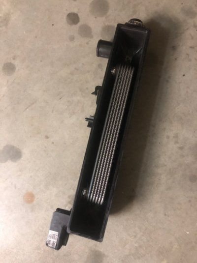

common misconception. The oil and trans fluid does not run through the entire radiator. Only coolant goes through the core the tubes and little fins are. In each end tank there is essentially just a tube with an inlet and an outlet for the oil coolers and coolant flows around the tube. It’s largely ineffective and really does more warming than cooling.

I would advise against just bypassing these unless you have an aftermarket solution like a trucool 40k transmission cooler and another solution for the engine oil cooler. Both will need to be custom. Though it isn’t hard. There are a few guides on the forum if you search.
personally. I have a 40k for the transmission and I left the engine oil cooler in the radiator because the new aluminum engines need a higher oil temp to prevent piston slap. I did switch out the leaky factory lines with some custom ptfe -an hoses.
