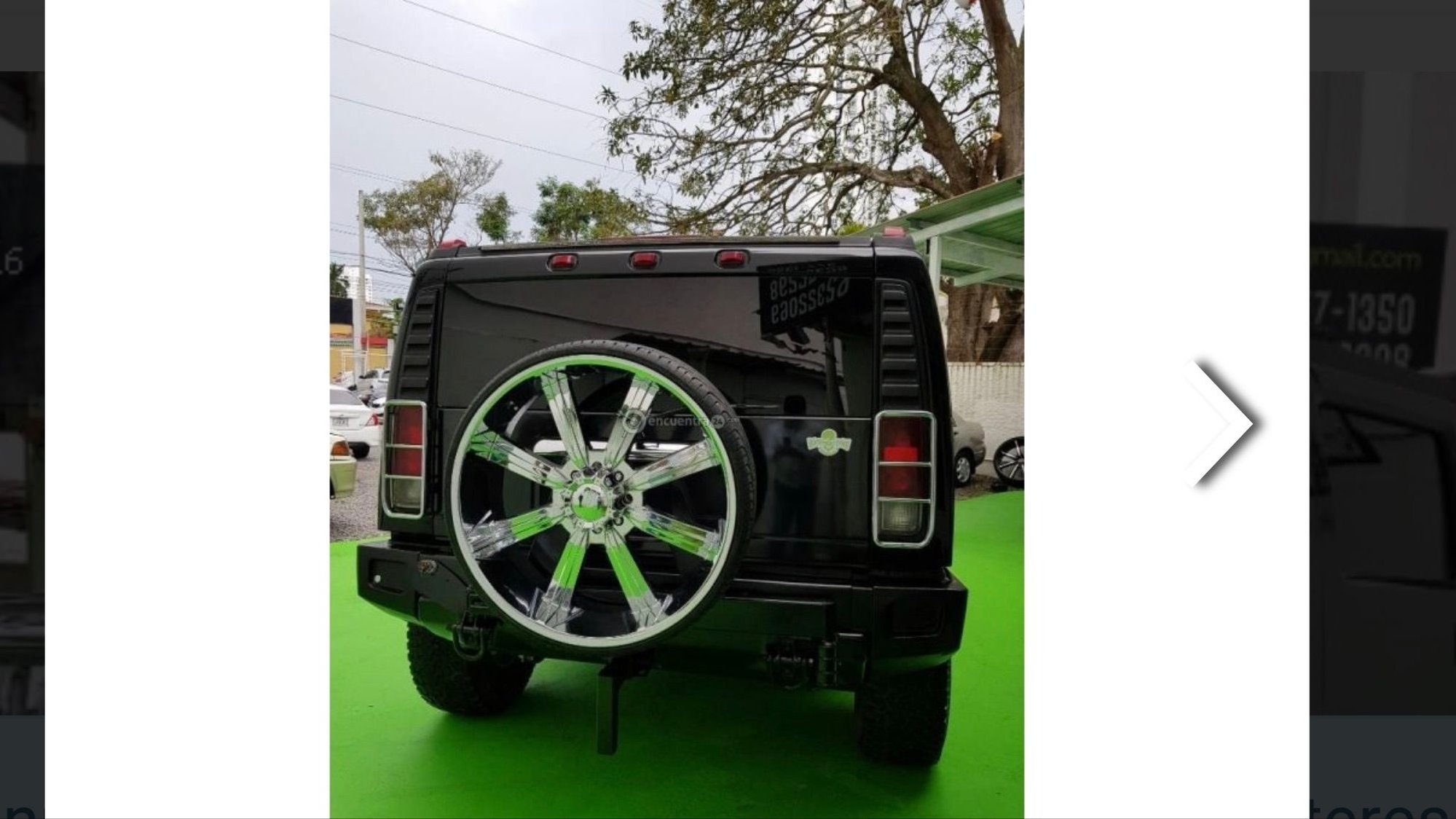

By the way, this is the H2 I’m looking at (the 2nd set of rims and tires are included in the price &#128514

I'd ask if they will take some money off to keep the giant wheels with rubber bands on them. If not I might offer to pay them some extra just to keep them. It will ride like total crap with those. That also gives me pause regarding the transmission. If those are considerably larger diameter with the tire than the stock wheels, they have been putting a huge strain on the transmission trying to make them turn. The transmission hesitating to get into reverse makes me worry even more. That can also account for the mileage discrepancy as well - if those were on it for a long time and the PCM was not calibrated for the larger tire size than both the speedometer was incorrect and the mileage will be recorded wrong.
I Agree 100%... I would never ever consider using those giant wheels! You are absolutely right about what they could have done to the tranny... I didn't even think about it. And yes, the transmission is what worries me the most...
