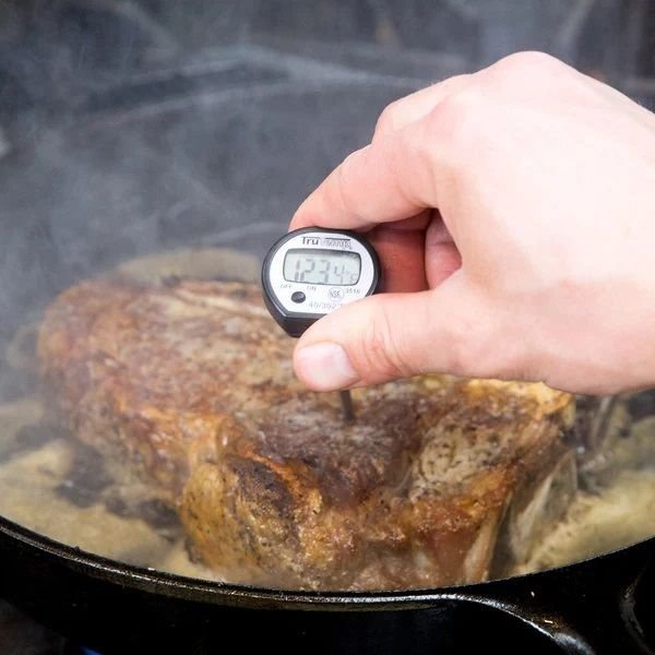

Fan clutch fully engaged can cause a "roar". Few days to check vent temp? How do you check temp when cooking? Any probe thermometer will work!

Not lack of tester....LOL....lack of time. Lot of busy life stuff for the next few days. I have the tester....😁
