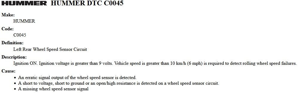

Maybe LR sensor got damaged during brake line install? I had the C0045 a few years back when the sensor failed:::>>>Rear abs sensor replacement

hummerz you may well be right, sounds logical.

These are images are taken from Hummertime1 's earlier post, something you don't want to happen (always wondered how that one went?)
