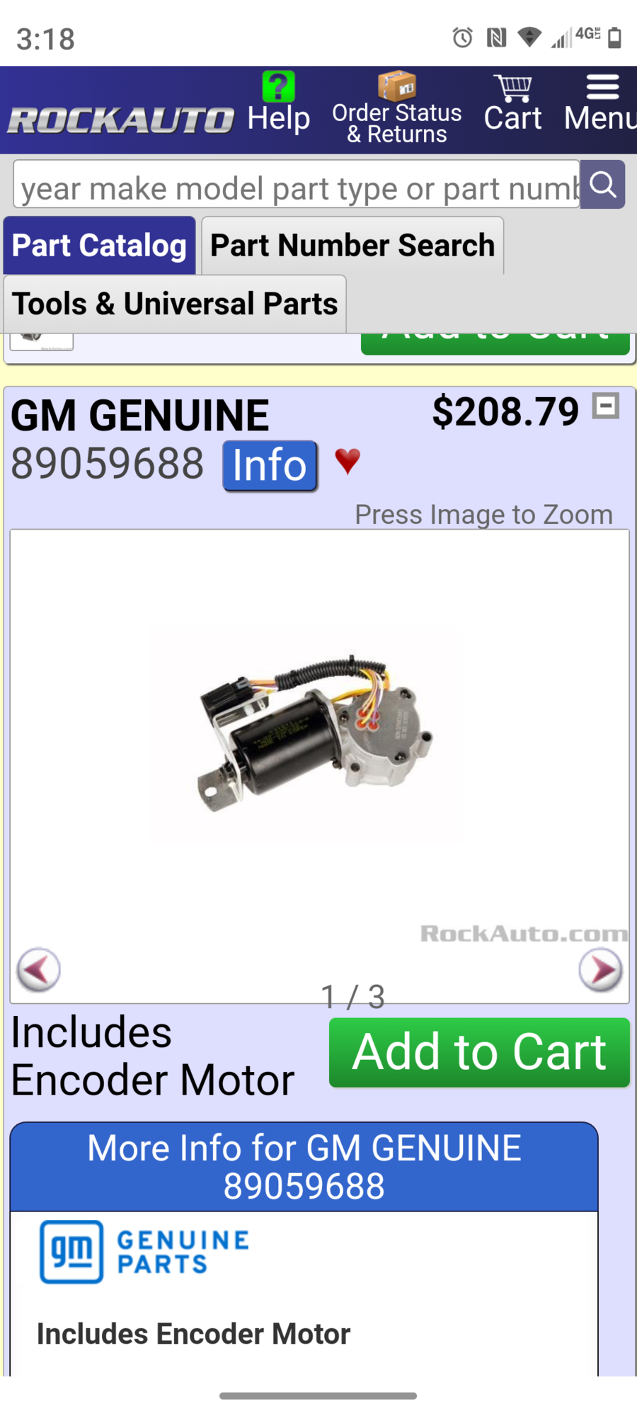

My 2003 H2 was doing that last spring intermittently. Went ahead and changed the encoder motor. It's right there on the back of your transfer case, literally 5 minutes to swap it out with a new one. Solve the issue. If the light is not lit up it could indicate it hasn't fully shifted to where it needs to be. I figured at 22 years old, any grease in it had completely dried up. If you had the fuel tank down doing that fuel pump, check that harness connector to the encoder motor on the back of the transfer case and make sure you didn't knock it loose.
Old Mar 6, 2025 | 05:16 PM
RobertDez's Avatar
Joined: Feb 2024
Posts: 537
From: Oregon
.... And definitely stick with AC Delco. RockAuto likely has the best price on it.
Old Mar 6, 2025 | 05:19 PM
RobertDez's Avatar
Joined: Feb 2024
Posts: 537
From: Oregon
Rockauto.com has the genuine GM for $202.
