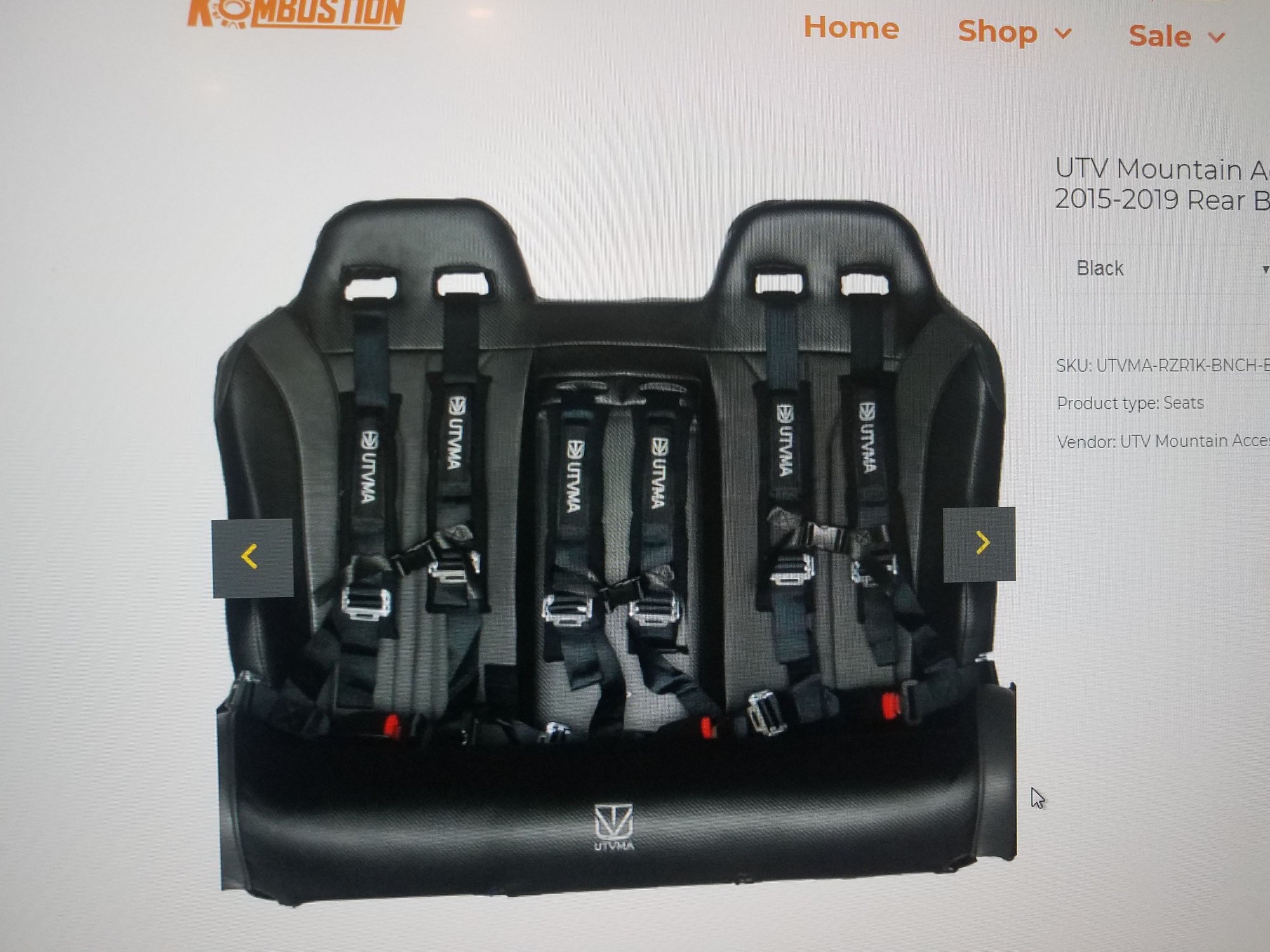

This would be neither tesla or hummer GM but if done right would be equal to what your looking for.
The seat is buggy/side by side, off road recreational vehicles. rear bench seat and two five point harnesses of the desired type retractable or regular. i installed mine in my off road UTV for my kids. but either way it would be custom fabricator install.
