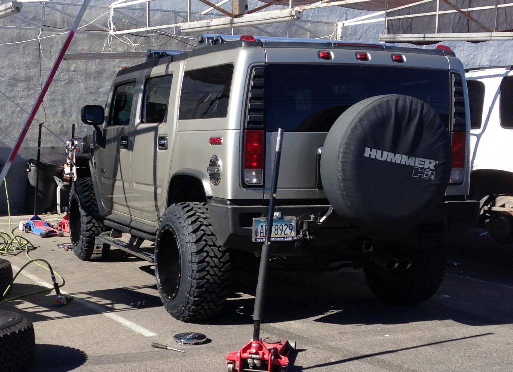

You can get the hubs here Timken Bearings (NEW + Kryptonite) [SP580310-SP580311-580312-58013] - $199.99 : DMAXSTORE.COM, Your Duramax Diesel-Only Shopping Resource They are $199@ which is what you would pay for cheap ones at a parts store. The wheels and tires in the pics are Fuel Hostage 22x14 with 35" Toyo MT's. I don't recall what the offset is. They stick out about 3". If you want aggressive looking MT tires, the Toyo seems to last lnger than others. The 40" Toyo MT's lasted about 65,000 miles on my lifted H2 and that's with a lot of off roading. You will need good hubs regardless if you stay stock or not. Beefing up the steering and suspension components is a good idea too. On my lifted H2 I have Kryptonite tie rods and Moog Idler & Pitman Arm and ball joints. You can find a lot of good stuff on the site in the link. I got the ball joints seperately and pressed them into the stock control arms just because I don't see what difference a control arm itself is going to make. Some places sell the control arm with the ball joint already in it to make it easy on you. I haven't done anything with the bushings as they have lasted pretty well. The 22" wheels and 35" tires aren't going to wreak much more havoc than the stock will.

Originally Posted by Caraddict
I like the hash marks on your fender...where did you get them?
I own a screen printing and graphic design business. I do custom decals and lettering as well. So I cut them my self and put them on using a mat black 3m vinyl.

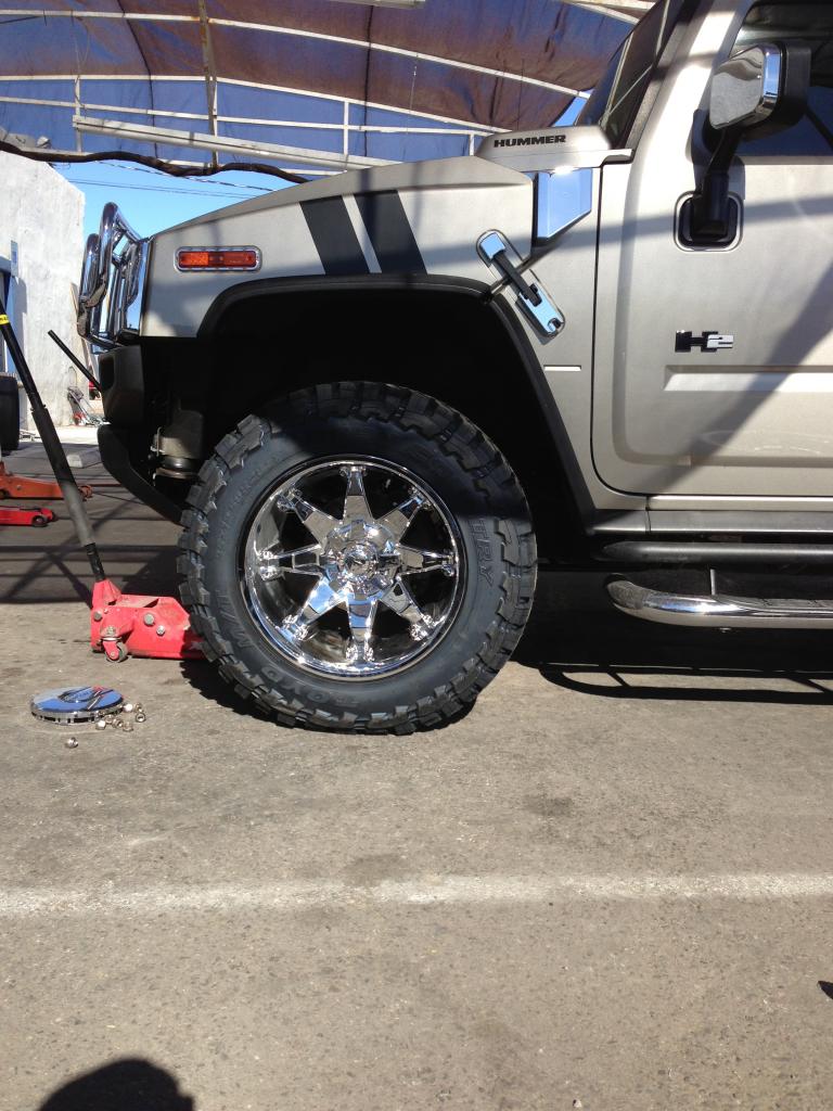

So I went back to the tire shop and fitted some FUEl Octane in Chrome 20x12 with a Toyo 35/12.50/20 MT.
I think the Black looks better for some reason.Name:  IMG_0435_zpsf73be8c3.jpg
Then I had them mount two of those 20x14 Fuel Hostage
I decided that although the 20x14's look sick IMO, they are going to probably damage the suspension very very fast.

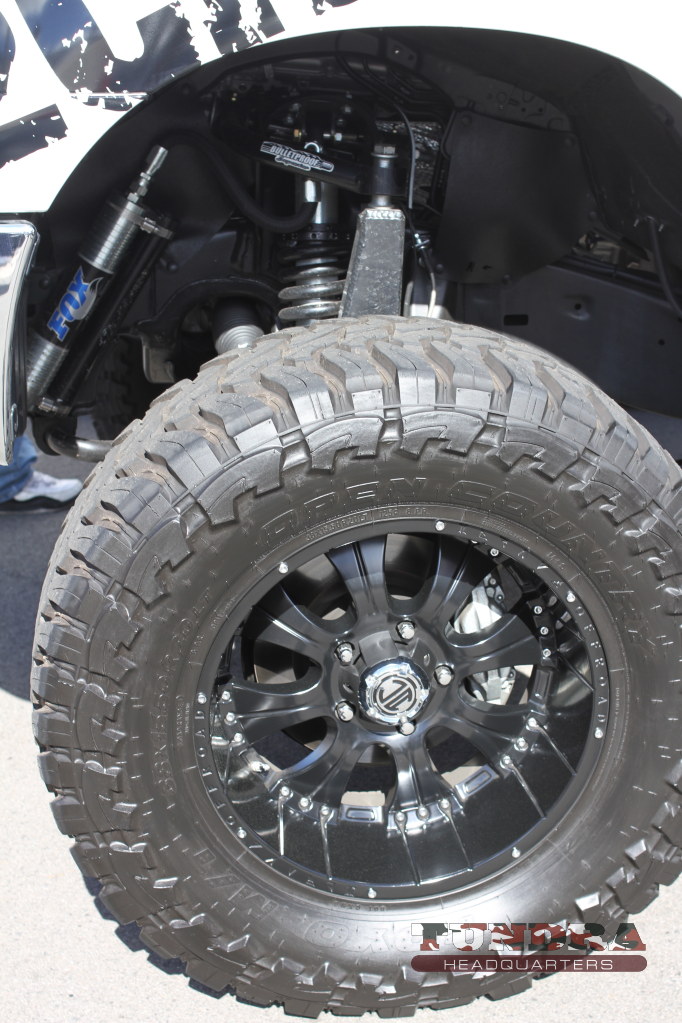

I went to another shop who reccomended me some 20x10's 2 crave nx-1 wheels they mounted them up on some Nito Mud Grapplers and it did look very nice. Not sure if it looked nicer because of the Nito aggressive tire design or the combo.
I did not get a chance to snap a picture of them on but, this is what the design of the wheel looks like.
The guy there said I would probably be safest with a 20x10 wheel. I am a little worried about the Nito Mud Grapplers being to LOUD. I had some Irocks on my Avalance and I did not mind the noise but, after a while the vibration kind a got to me. THings rattled in the cab after a while so I switched out to some Cooper Zeon LTZ's and those were super quite..I wonder if the Mud Grapplers will be as noisy as the Iroks???
