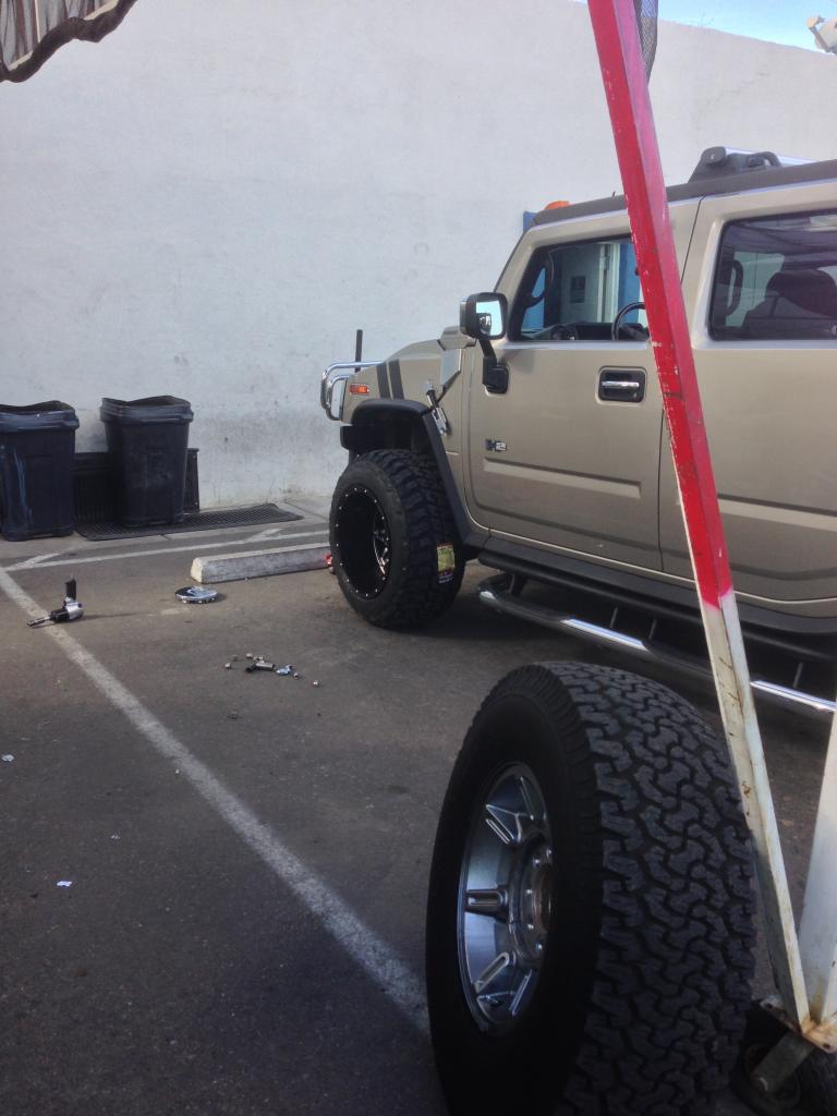

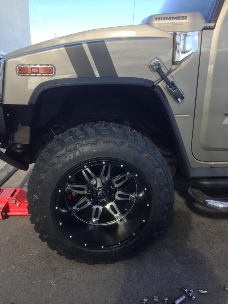

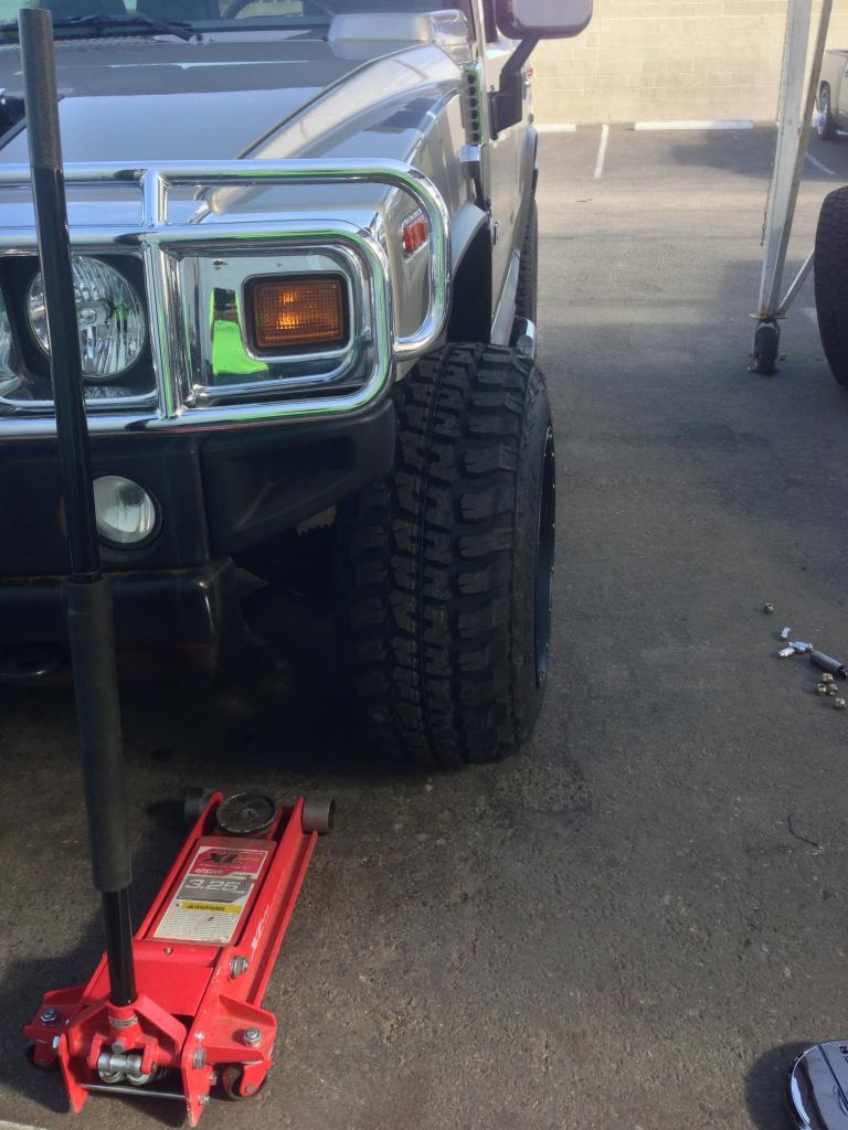

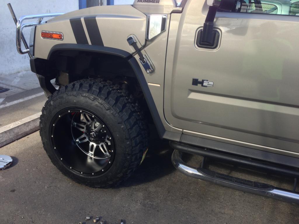

here are some pictures of them on. They don't rub
