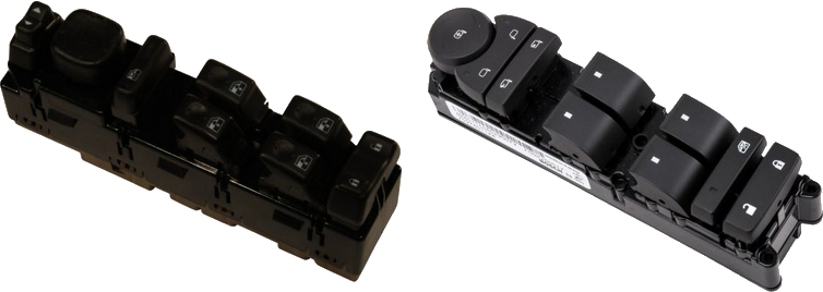

So here's the thing, the '05 mirror, as shown in bronxteck video, I know in great detail about, everything from the DDM electronics (Power Window Switch) power-fold motors+mechanism to the mirror-glass actuator motor mechanism.
However I have no info about the '08 DDM, mirrors and power-fold arms etc, it would be really good to know if the internal mechanics are fundamentally the same and some pictures would help tremendously.
The '08 Driver Door Module on the right looks different, especially in layout as you can see below. The electronics could well be different too, also the '08 DDM seems much cheaper, almost half at $87
For the '05 system, only a DDM IC driver chip fault would cause the motor to keep running. If your mirror select switch & 4-way control pad work OK for the RH mirror, then it possibly is a DDM chip fault (as you say a "defective switch").
