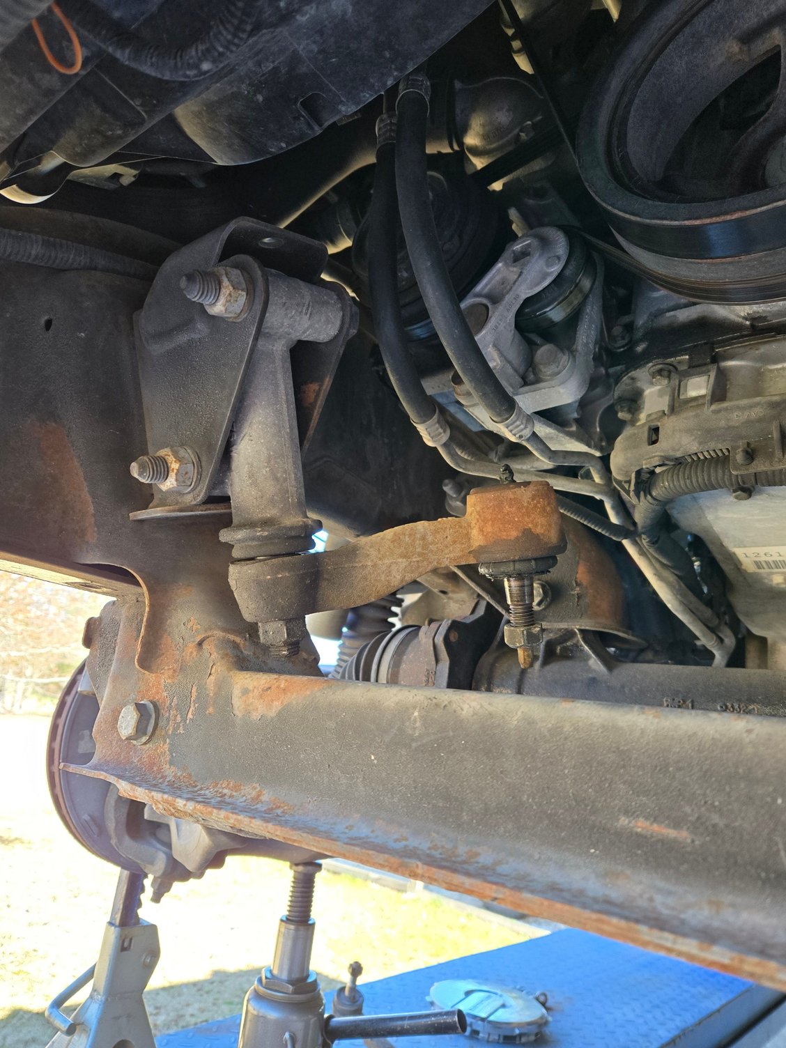

Thought I'd share some work on the H2
I'm not a big fan of Dorman products for the most part but been wanting to give their RD (Rugged Duty) suspension parts a shot and see how it goes.

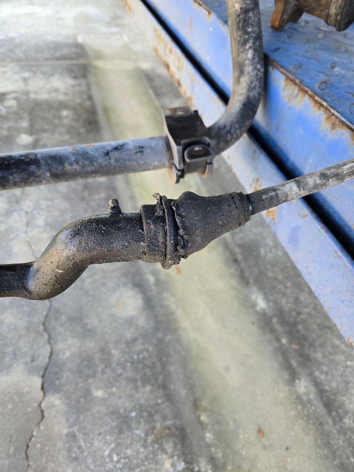

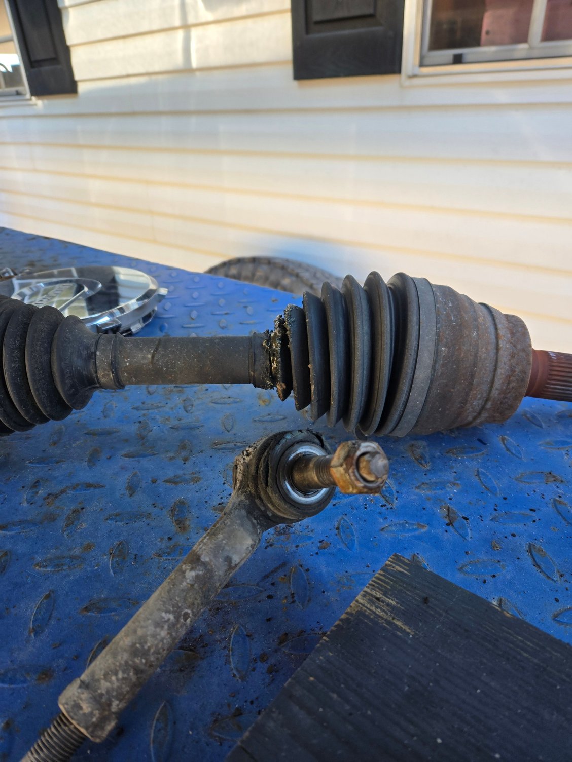

Idler and pitman arms both had up and down movement at the *****, both inner tie rods have torn boots and some play, the outer tie rods feel good but one has a torn boot so will be ordering new outer tie rods soon. While looking things over I found grease on the inner fender well and brake caliper, CV shaft boot was torn so replaced it while in there (not with Dorman).
I got new inner tie rods, pitman arm, idler arm and idler arm mount.
The Dorman parts look very good and were well packaged,

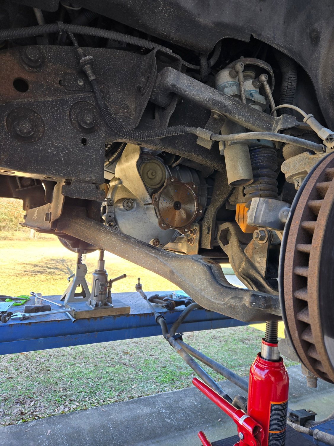

CV Shaft and tie rods are out
driver side CV shaft
Inner tie rod boot
Inner tie rod boot
Idler arm
Idler arm
pitman arm
pitman arm
New idler and pitman arm installed

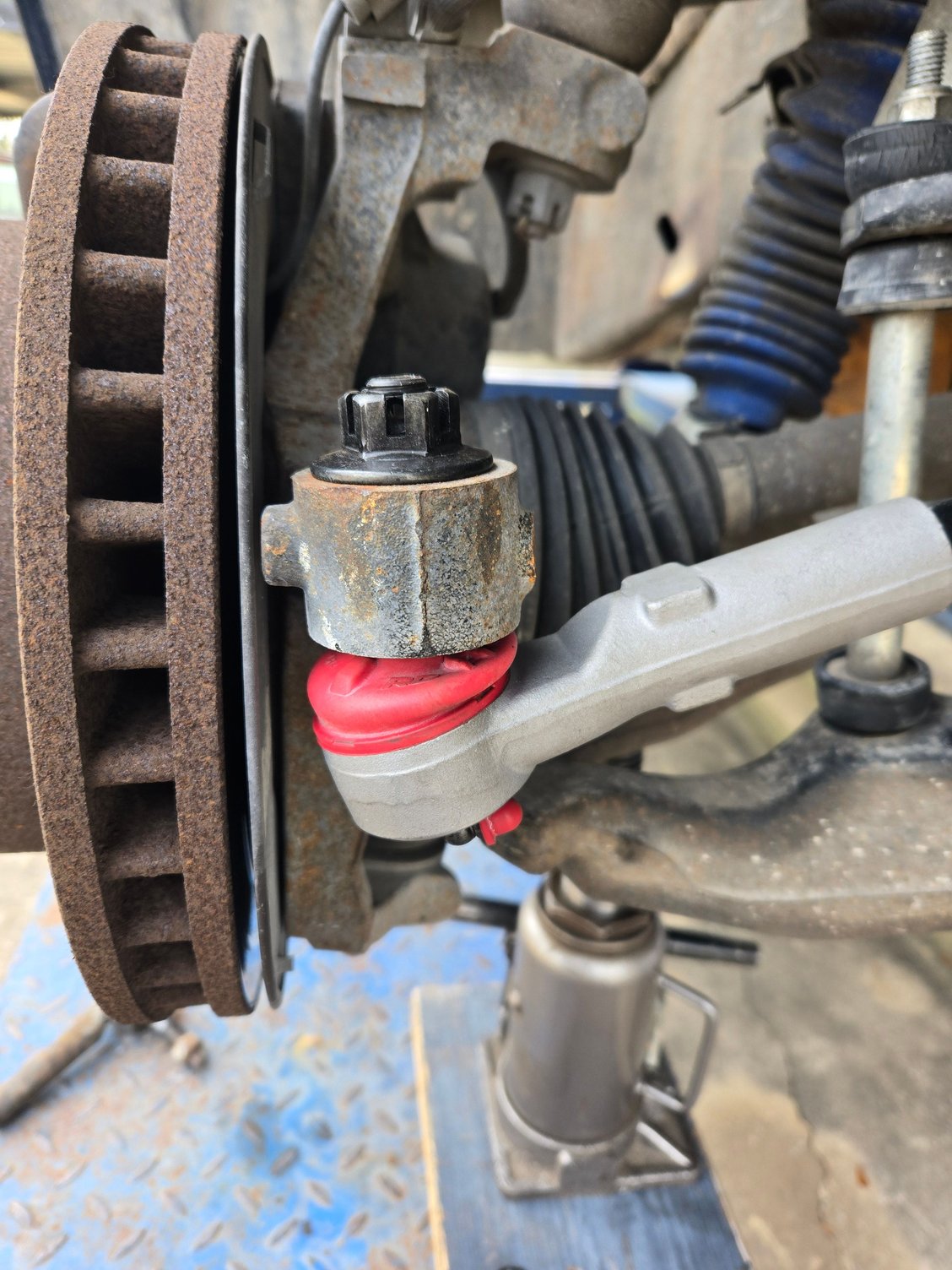

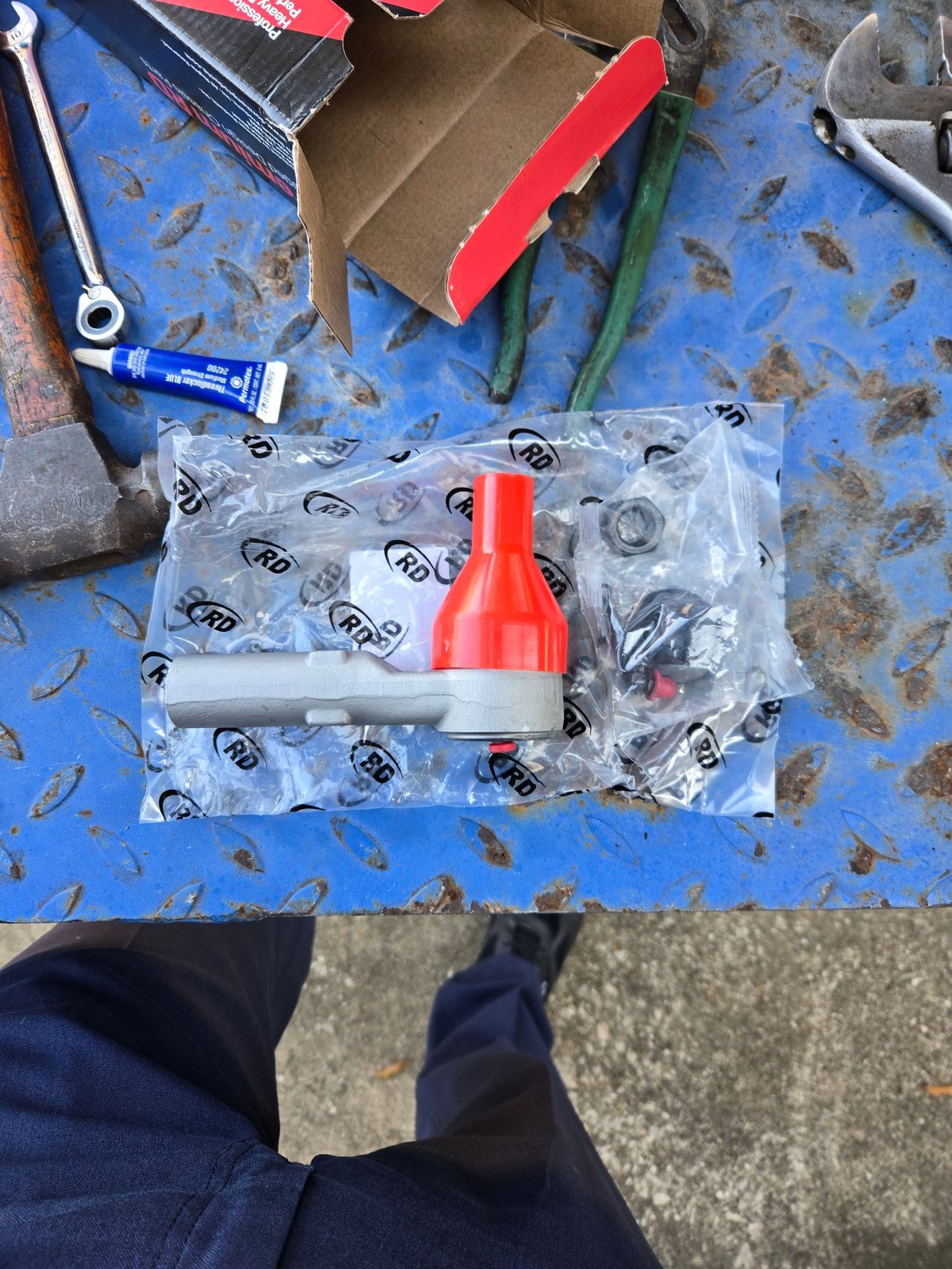

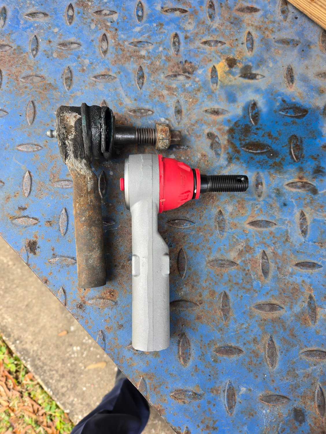

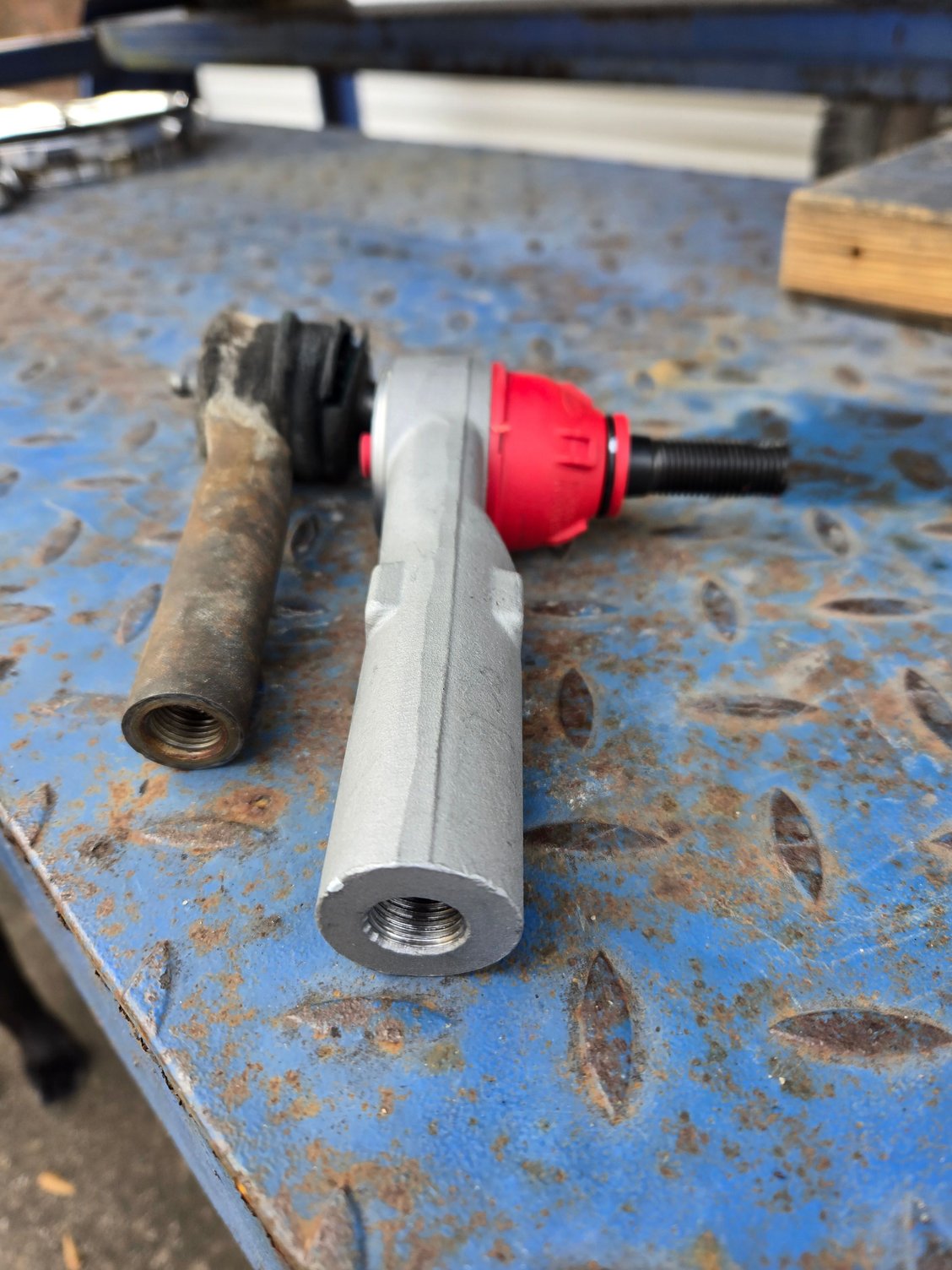

Well, got the new outer tie rods in and installed along with new Bendix brake pads,
This looks to be Dorman's fleet product line, the corrosion coating is better than their normal parts
Straight out the box with the boot protector on it
RD tie rod laying next to what I think is the OEM tie rod
RD tie rod laying next to the tie rod I replaced
for comparison
for comparison

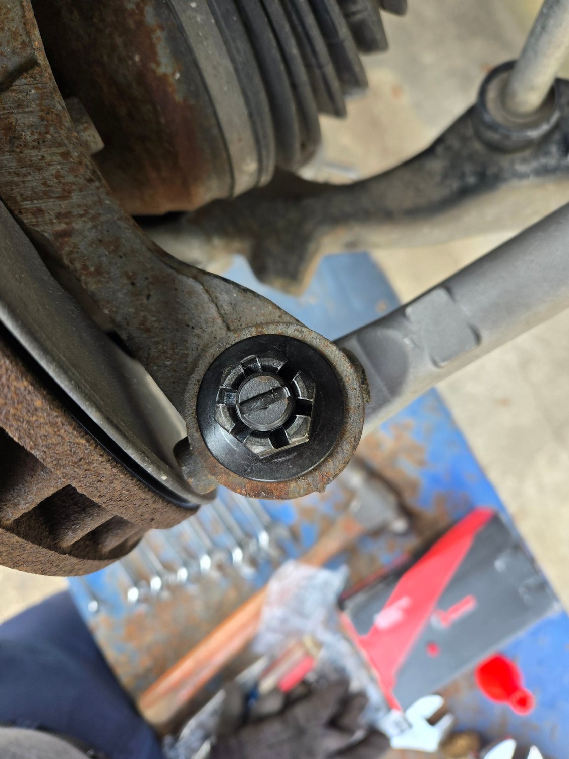

RD has a clot ground in the end for holding it in place when removing it. I is 90 degrees from the cotter pin hole which gives you a reference when tightening the nut
RD has a slot ground in the end for holding it in place when removing it. It's 90 degrees from the cotter pin hole which gives you a reference when tightening the nut
installed and ready
installed and ready for the cotter pin
Neal
