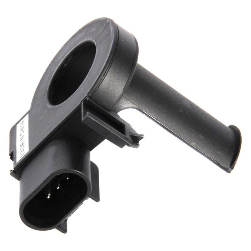

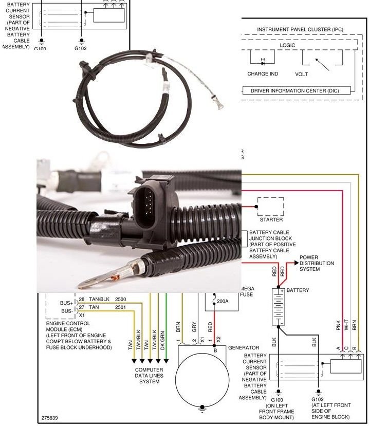

Also, check connector/contacts to the bcs(battery current sensor) or check B+volts KOER when disconnected.

Default Bcs
Where is the Battery Current Sensor located?
Old Jun 28, 2022 | 11:24 AM
  #29
Negative cable.

legerwn's Avatar
Joined: Apr 2010
Posts: 1,010
From: Deep South Louisiana
For the 08 its just down from the battery on the negative battery cable just below the engine side of the under hood fuse box
