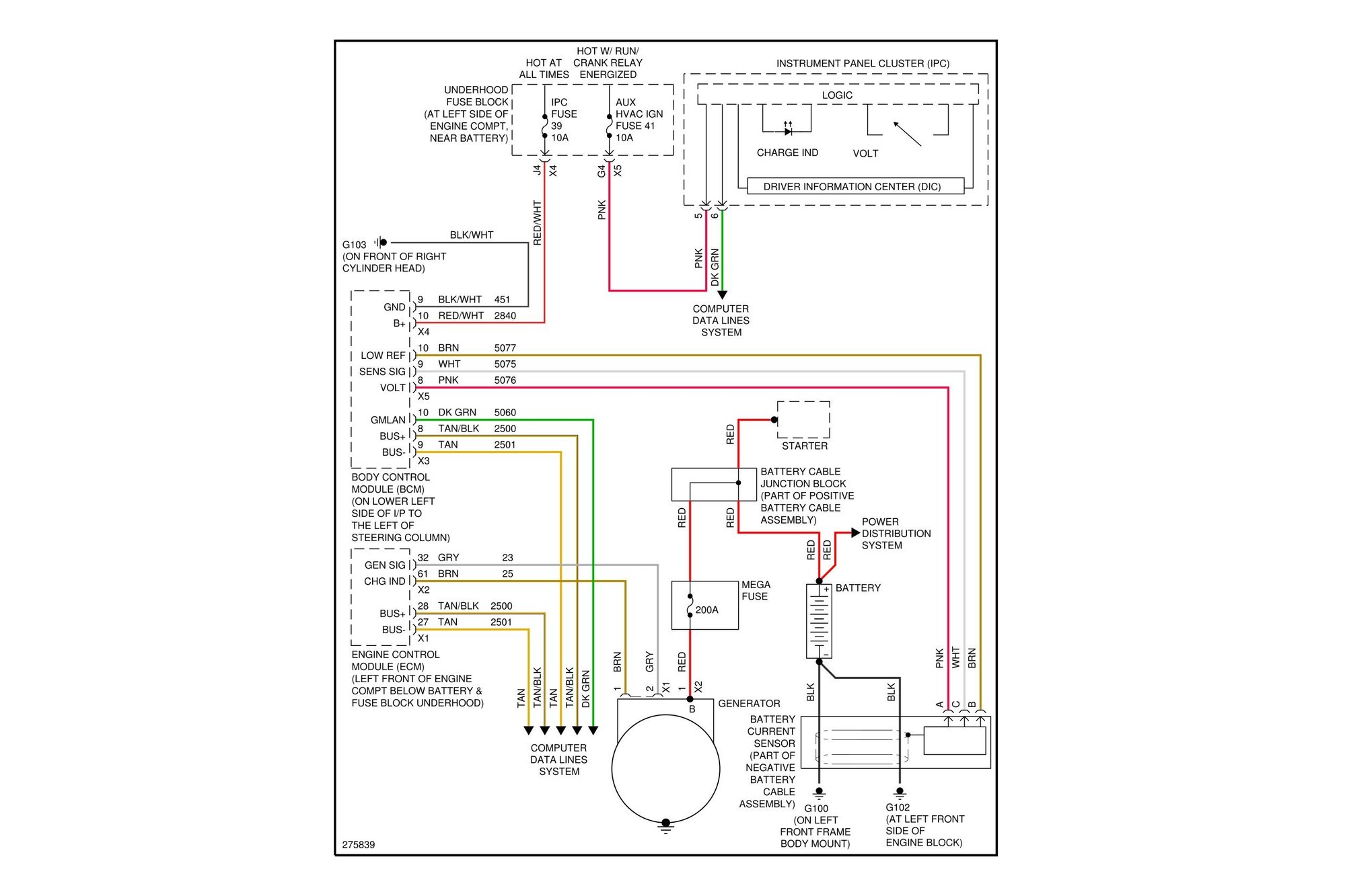

The 08 has a current sensor that measures the current being pulled form the battery and adjusts the charging system to maintain the needed level. There are a lot of other systems that are monitored by the BCM to maintain the charging system. You'll need a dealer level scanner to really get into the BCM and look at what's going on.
I have them and will try and get into it in the next couple days, once I get it figured out I'll update this thread, It may not be the same issue that your seeing but it does sound similar.
Mine is setting a DTC so I'll start looking there

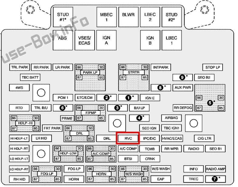

Check the RVC fuse.

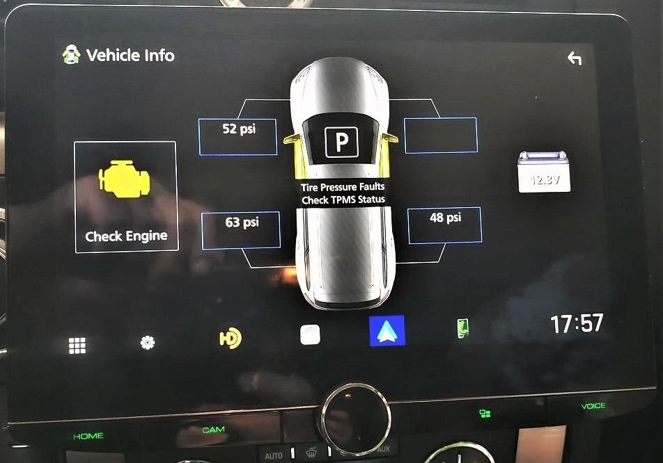

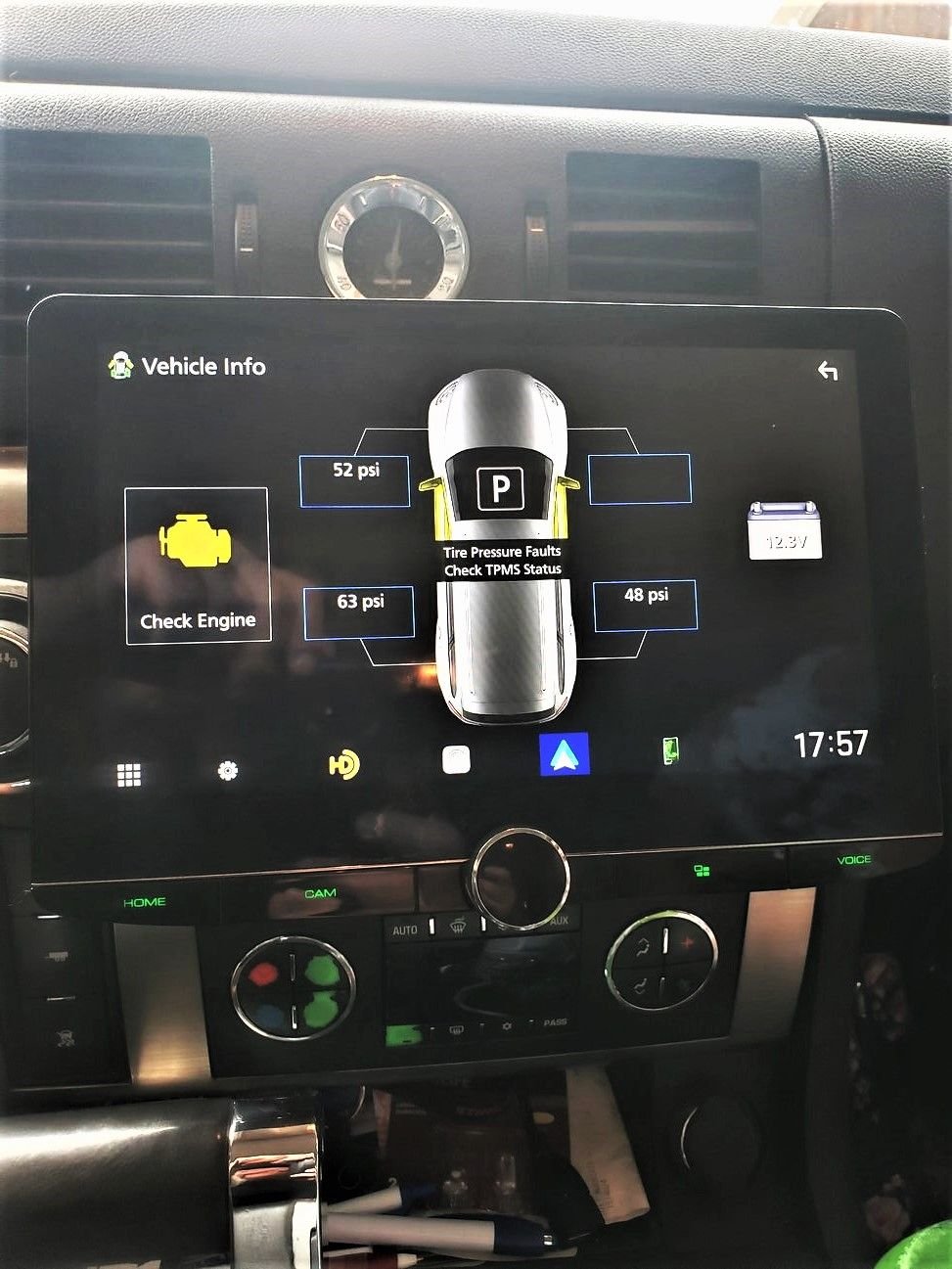

Mine doesn't discharge, but it'll go down to around 12.8 or so. It just goes up and down when it wants. I thought I read somewhere that if you push the tow button it will give you more charging. Lol, I'm sure it read a little different in the book. It's never left me stranded so I don't even worry about it anymore. I can read trouble codes and check engine (OBD) codes on my radio screen, also reset them too. It's came in handy sometimes. Discharging means like 11.5 volts (Example)?

10.1 inch. Lol, go big or go home. I absolutely love this thing. I got the one w/o built in Navigation. It will mirror my phone and show Google maps on it also.

Lol, they're stupid. I need to change all 4 of them. I like the pressure on the high side. They all check out the same with a guage.

was able to pull the code from the PCM today, P0622
While watching the live data stream the GEN F terminal drops to 0 while idling, GEN L is also doing some odd stuff
