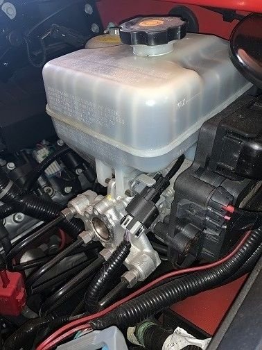

Even though currently I am ok with only an occasional drip through the firewall but I know what might could be coming. Usually with the old Hydroboost this signifies the beginning of the end for those units.
So, what the hell I said screw it and just now ordered the replacement master cylinder part (2586147 only from GM Parts Giant) $632.43.
I have been on back order for the complete assembly (19258789) since the beginning of this year when I first noticed a drip of brake fluid on the pedal rod. No lights or brake problems at this point and the truck is fine, BUT we all know about Murphy's law.
If the complete assembly ever gets shipped (which I doubt at this point) I will put add it to my hard to find H2 parts bin (with the other thousands of dollars of parts I already have on hand) You can all see I am serious about keeping my H2.
At this point I'm all in, I am not going to gamble a few thou on having a vehicle I could never drive again or even worse have to junk because of a stupid brake part.
I really do hope someone here with superior knowledge can come up with a way to use the pre-08 Hydroboost unit on the 08/09 and still have everything work as it should. I don't think retrofitting the pre-08 hydroboost and master would be a problem, getting the ABS working correctly and getting all of the hooks out of the BCM software will be the issue. Gives me a headache just thinking about it. How's that for a challenge!

These unit have now literally become impossible to find. I have not seen one pop up on a search for well for 2 years now. What ever was out there have been snatched up by specialty companies. Retrofitting back to the pre-08 hydroboost units looks like an almost impossible feat because of the integration into the vehicle systems, ie stability and roll control, ABS, the 4wd system and more. And since there were so few 08/09 I don't expect anyone in the aftermarket will come to the rescue.
I do know I have seen just the master cylinder part of the assembly pop up from time to time but don't know how successful someone would be trying to replace just that part.
This is one of those items that's going to be a real issue for us 08/09 owners unless someone come up with a solution!
You could not retrofit an 03-07 system in an h2, but there are plenty of other 08-09 gmt900 trucks that came with hydroboost and an abs pump. If you could find a system from those trucks, it would 100% work. Just have to figure out programming and wiring, but it will work.
Btw I bought the last booster assembly off rock auto a year ago. Sorry guys.
Also that hydroboost conversion from Sweeting just covers the mechanical side. Their listing says nothing about the electrical side, and it deletes the abs and just uses a proportioning valve.

Unfortunately the old Silverado 2500/3500's used the Hydroboost system used in the Pre-08 so there won't be any help there as far as I can tell the one in our 08/09 H2's were not used in anything else and the variants used H3 s are not even close. Toyota also used it in some of their 4WD vehicles again not even close.
So it's not looking good. If worse come to worse and since the electronics are good I will pull the master of the assembly, put it in my lathe, bore it and then make a new custom piston out of billet aluminum. Biggest challange might be getting the correct size and material O Rings for it not something I am looking forward to. I guess that $2500 Sweeting unit is looking better and better all the time even at their gouging price if GMPartsGiants falls through.

the plunger rod inside the master cylinder uses more of a flared seal not orings
Ouch, well, so much for my idea, finding flared seals in the correct materials and custom size will be about as easy as finding a complete booster unit, Oh Well, back to the drawing board.
