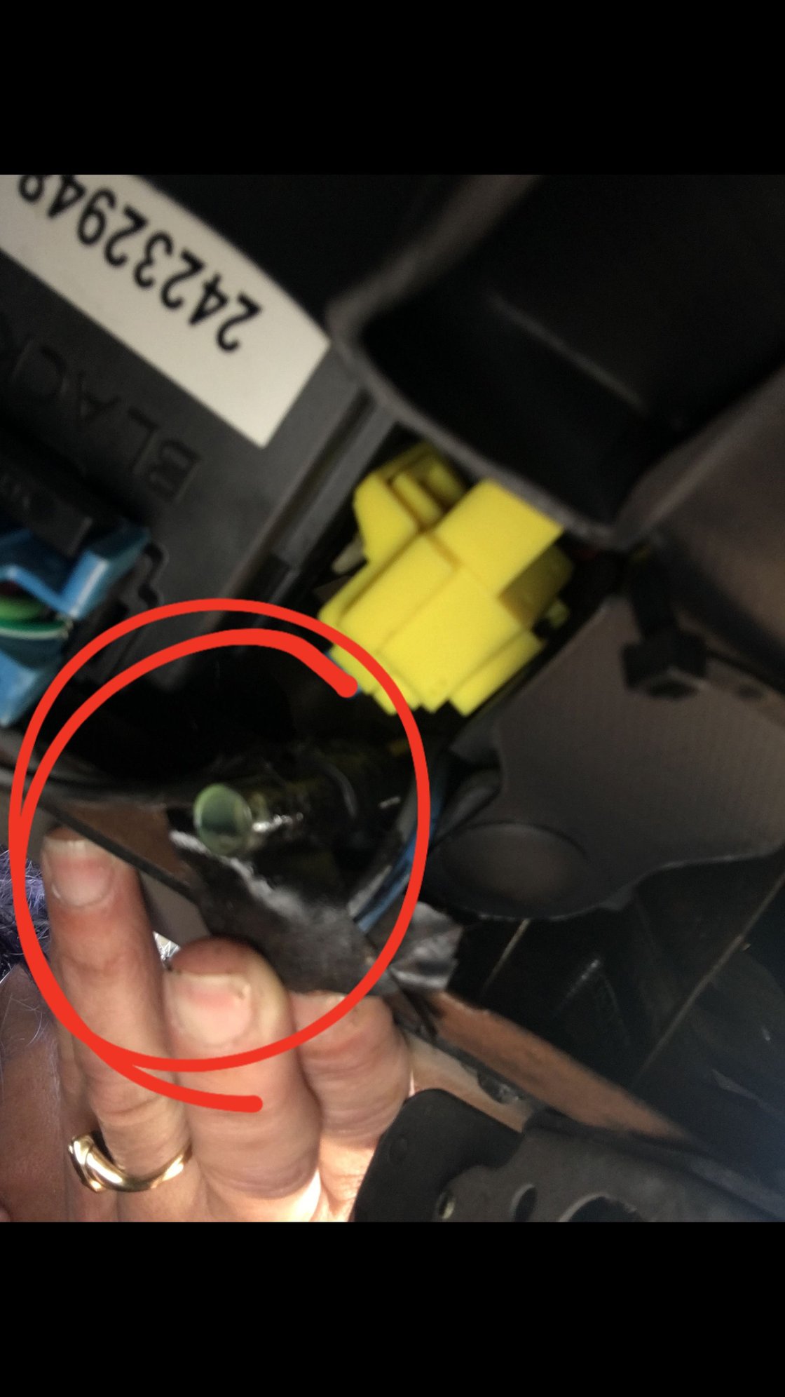

All gauges BUT speedometer stopped working couldn’t turn on dome light, lock doors
So when I got home from work this morning was just looking under dash was going to check fuses. Here is what I saw.
I looked up part so transfer case control module. But can’t find anything about those cut wires or whatever that is I criceld
Old Nov 27, 2019 | 03:35 PM
Posts: 3,204
I guess you would have to take the dash covers off and follow the wiring. maybe it had an aftermarket alarm in its past that's causing your issues.
hard to say what that tube looking thing could be. I don't think its a water drain tube but I could be mistaken.
