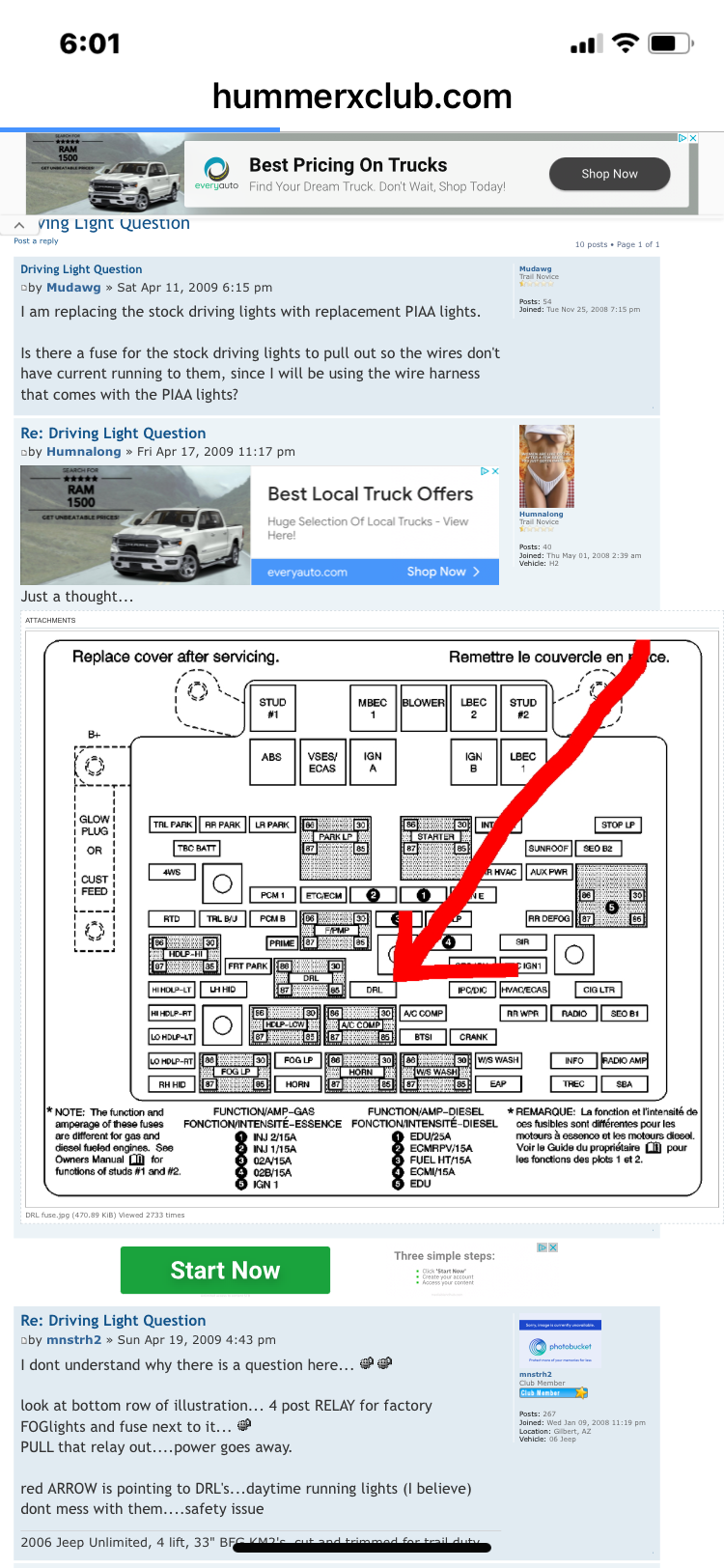

I include the diagram of your fuse box as you can locate them and see if you got a current.
It’s always better just to switch out the old fuses for new ones.
As mentioned before check your bulbs.
you should have three on each side of your tail light, brake, signal and reverse.
