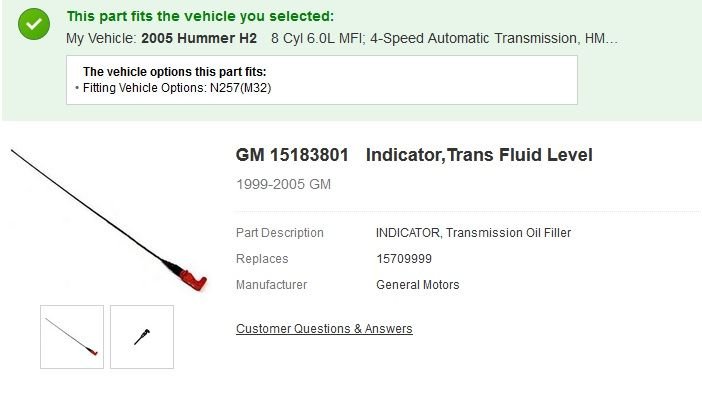

Thanks for the info. Pan ordered just need the fluid. Also, can someone tel me the length of the transmission oil dipstick? Mine was missing for some time, ordered a new one but it seems to be too short. Part number would help. Thanks.
2005 Dipstick = 32 5/8"
Hope this helps
