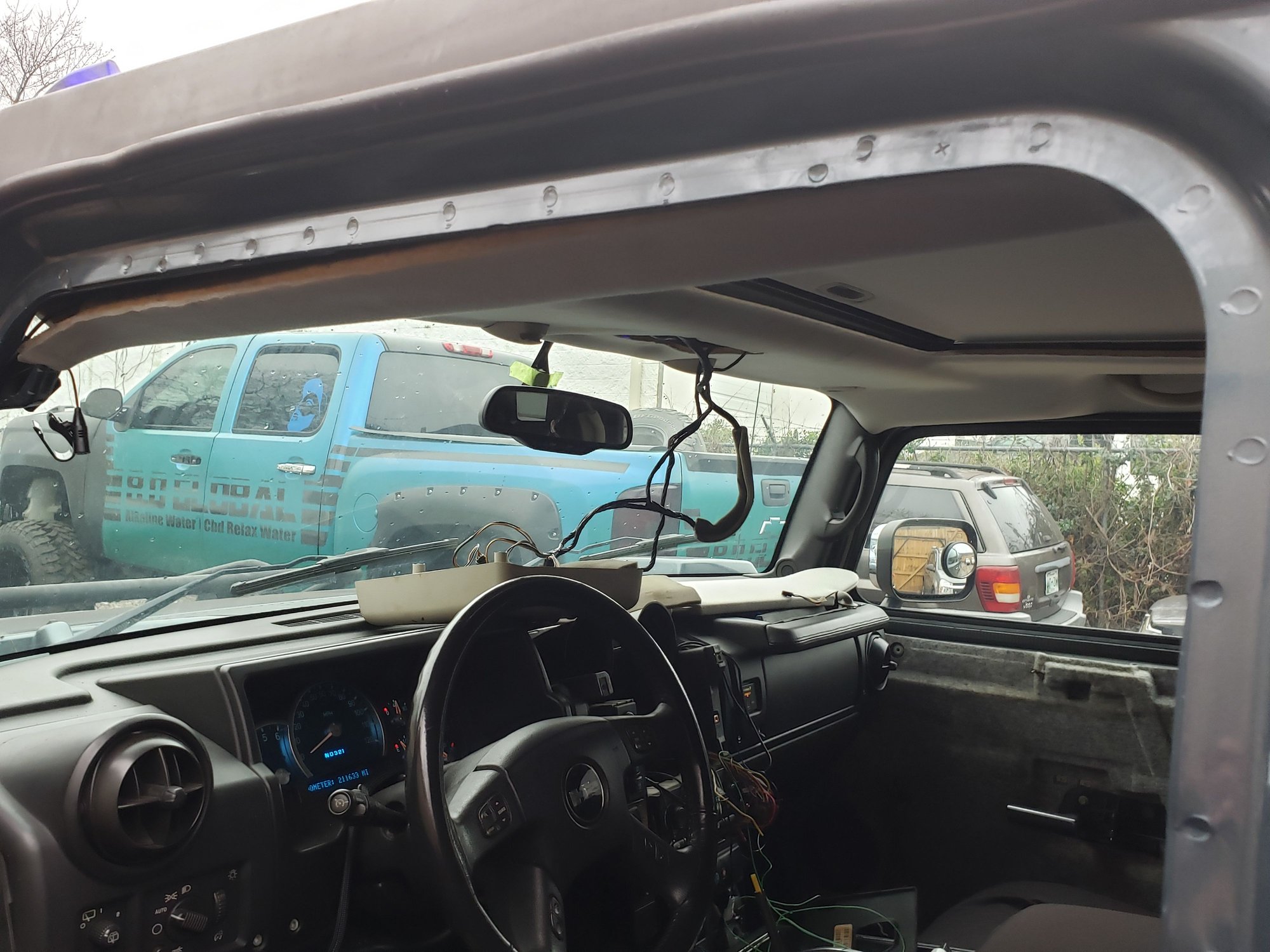

Thank you Hummerz for the advice, I have attached a photo for clarity.
Old Feb 7, 2020 | 07:37 AM
That is the inner one. Those are a more common standard type. Same as used on the full size GM trucks, SUV's, and many other GM vehicles. The only real difference between the many part numbers is the total length. I have a brand new one for my GMC truck out in the shop that I have not installed yet and my H2 is also in my shop. I'll double check to confirm in a bit to verify that they are the same profile/style. On my truck I have both sides brand new and my truck is a 99 3 door so one is much longer than the other. I'll compare the length too. Had not thought of that but if it matches up we might be able to source more commonly available part numbers for the trucks and SUV's for that inner one and would just have to cut to the right length is all.
Now the other one above that that is still on in your photo, that one is H2 specific as it has custom molded sections that are required for it to fit. I'd imagine the others on the sides are also H2 specific.
Always seemed crazy to me that the H2 has so many on the sides yet they still have leak issues.... lol There is the long one at the top, inner door opening ones (what is missing in the photo above), one around the upper perimeter on the door itself, one along the back edge of the front doors (I think that one is for wind noise), and one on the body along the vertical upper edge by the back doors (I think that one is also for wind noise). Finally I think there might be two on the rear hatch as well.

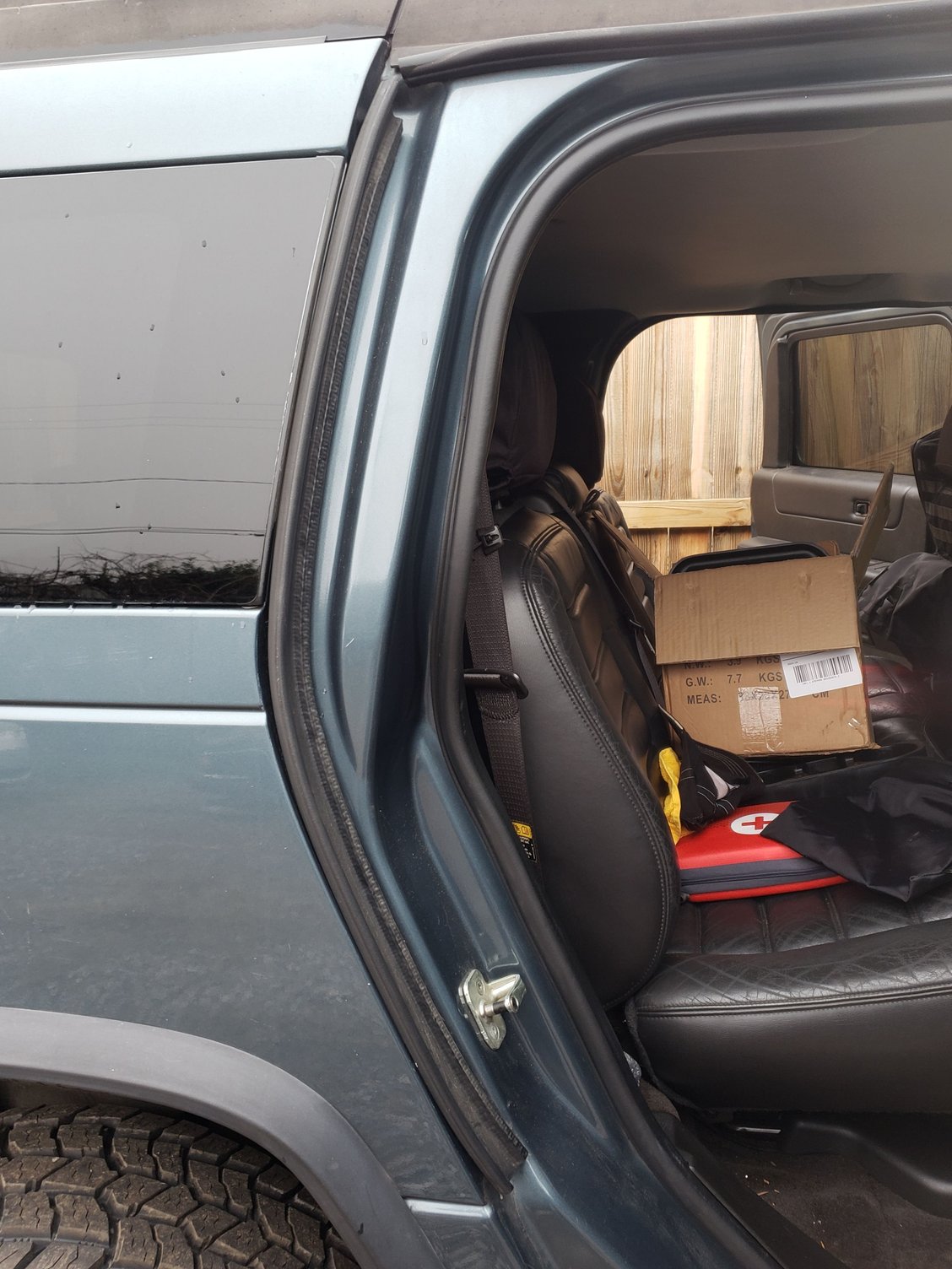

Also, I want to replace the rear passenger side door trim on the out side of the frame (attached photo). It looks like part of it is missing but I think that was way it was when I bought the vehicle back in 2008. I really appreciate all the info and help you have given and if it is possible to buy some of this form you please let me know.
I was thinking that the 3 pieces were most likely going to have to come from GM Parts direct which is expensive. but it sounds lke you may have a better alternative. Please let me know and thanks again MixMan.

the vertical one on the rear quarter you can wash very well and stick it back to the body using 3M panel trim tape. as for maintenance on the weather stripping i use silicon spray or super lube grease depending on how dry they are. but the most important part is to first wash them well.
