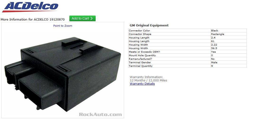

If there is GND on B and 12V on A and D gets pulled upto 12V when the dash-switch is in LOW, then it's the module.
So it could be the controller, I read there was a recall on it apparently it lets in water, but never seen one personally.
The module is
ACDelco 19120870 ACDelco 19120870
, fairly cheap from Amazon (circa $42) , quite small.
Some sellers incorrectly identify it as windshield pulse board.
