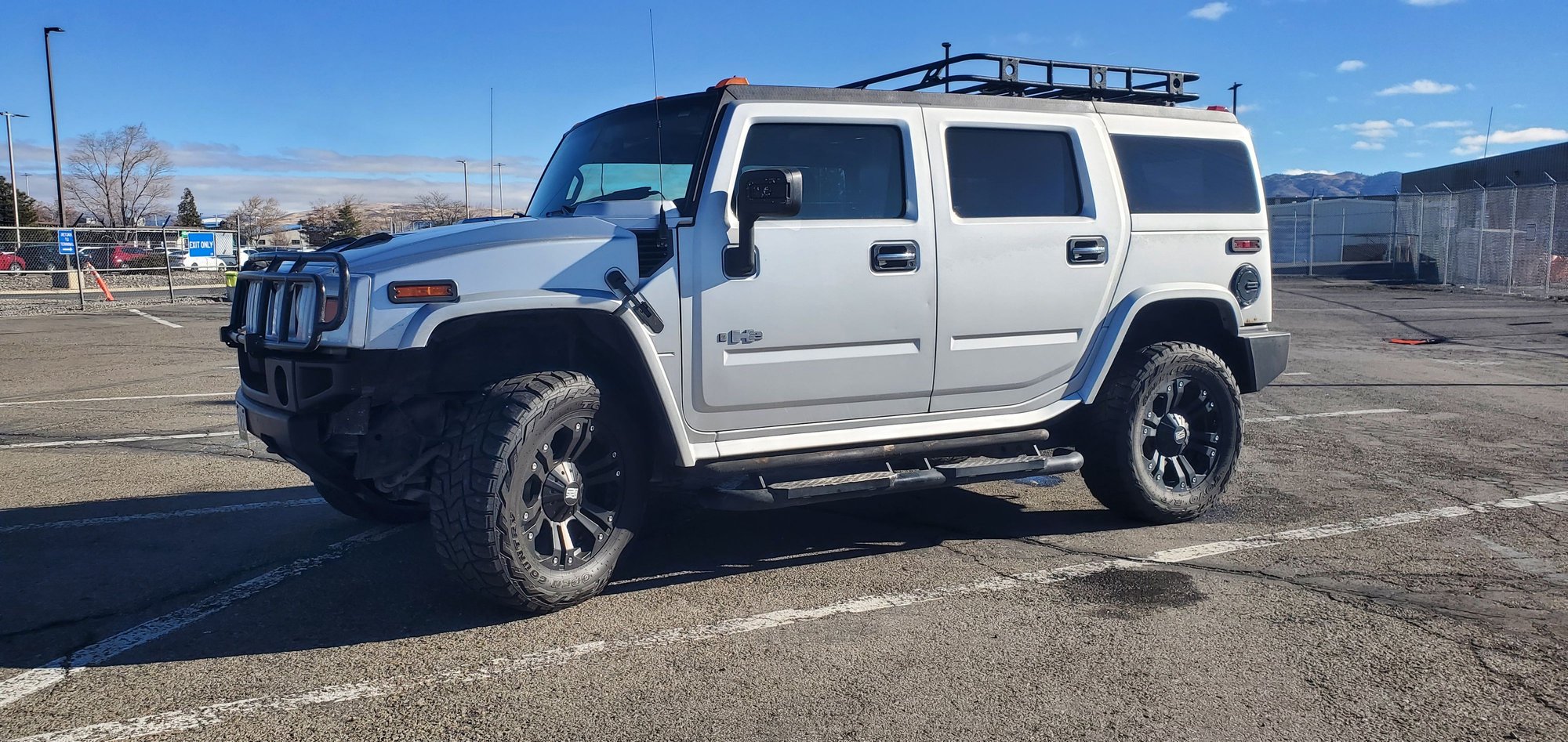

As some of you know I've recently purchased a new to me 09' H2. And because I've never been one to leave anything well enough alone I immediately began the customization process. AKA: Project Bank Drain.
The basics at time of purchase:
•2009 Silver H2 SUV Luxury Edition
•186,000 miles (ouch...)
•Slight crank on the stock torsion keys
•Rear air suspension had been previously removed and coil springs installed
•Stock wheels replaced with 17x20 wheels and 35x12.5R20 tires
Current Modifications/Purchases:
•Green torsion keys
•2" rear coil spacers
•3" Body Lift (blocks on Amazon, bolts sourced locally)
•Front & Rear gear swap from 3.73's to 5.13's
•Kryptonite Upper Control arm kit
•Kryptonite SS Center Link and Tie Rod Package
•Kryptonite Idler Support
•Kryptonite Death Grip Pitman Arm
•Kryptonite Death Grip Idler Arm
•17x9 Raceline Halo #957B-79080-12 (4.5" BS) 5ea
•40X13.5R17 Pro Comp Xtreme MT2's 5ea
•Tech 2 Scantool
•.......more to come......
I'm expecting to replace/upgrade the steering box but haven't gone down that rabbit hole yet.
It's in the shop getting the gears swapped out at the moment so photos will have to wait.
I'll update this thread as things progress, stay tuned....
