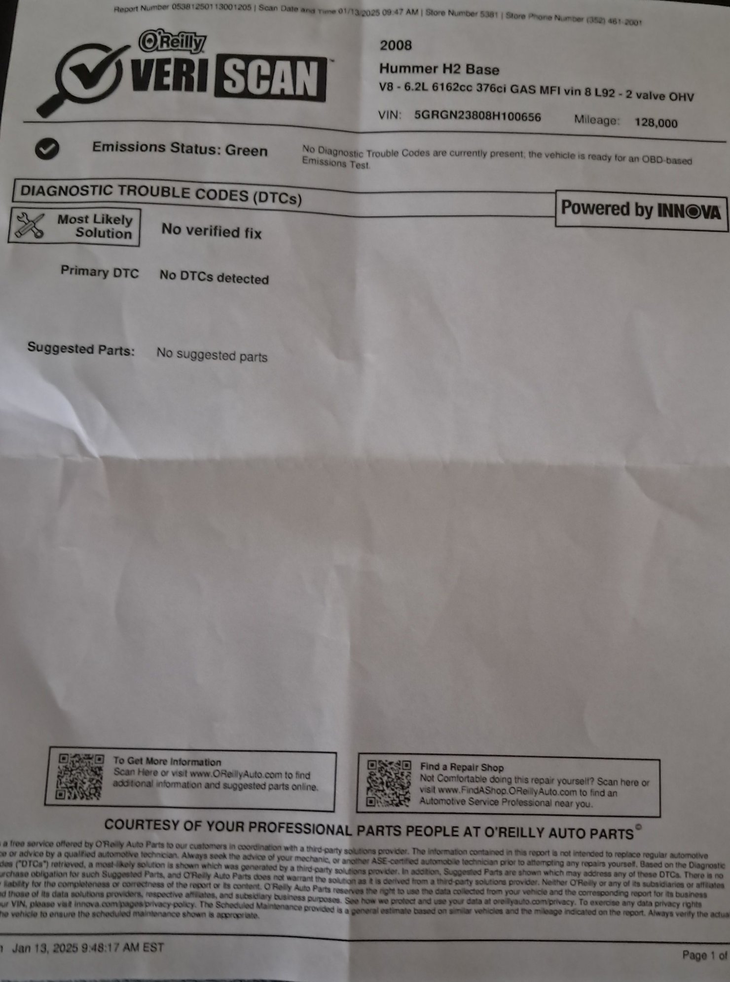

Default Got codes scanned....
Found nothing even though dash is showing 3...
Old Jan 13, 2025 | 12:21 PM
Posts: 9,047
SCAN ALL MODULES! O'Reilly only scans the PCM.
Old Jan 15, 2025 | 08:28 AM
Gavin Costigan's Avatar
Joined: May 2020
Posts: 632
From: North GA
you need to go buy a tech ii scanner that will scan everything. Otherwise just take it somewhere. Almost impossible to diagnose abs/traction control without a good scanner
Old Jan 15, 2025 | 09:39 AM
HellHoof's Avatar
Joined: Jun 2021
Posts: 162
Could be a wheel sensor, could be a module, could be a ground. Having the vehicle scanned by a shop will give you an idea where the fault lies. The AutoZone / O'Reilly scanners only scan for Check Engine light codes, not the rest of the vehicle's modules.
