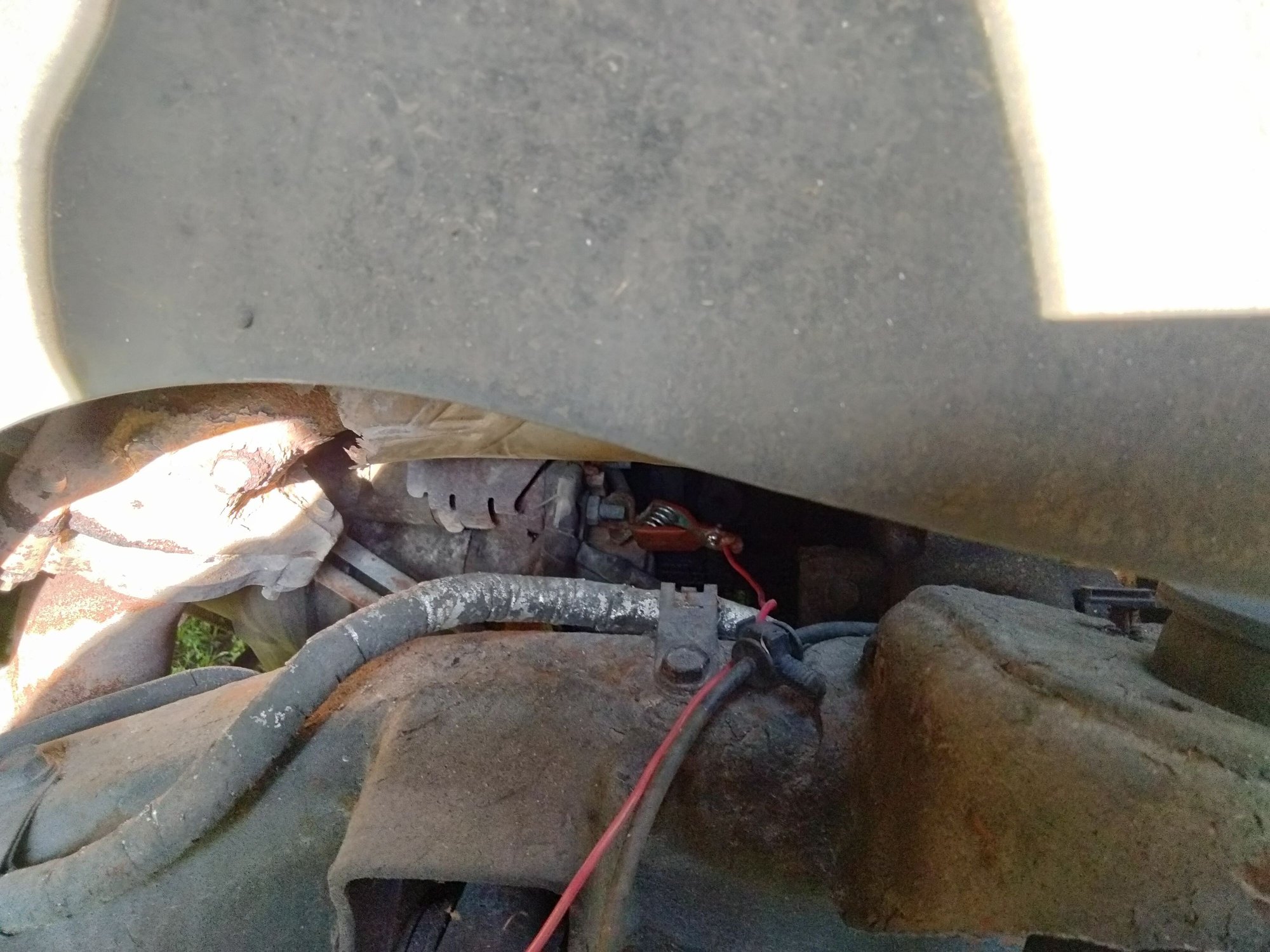

w/ pass. wheeI still on (H2 is in backyard) was able to clip multimeter to the starters constant 12VDC terminal an am getting 12VDC, wasn't able to reach or even see the 12VDC trigger terminal.

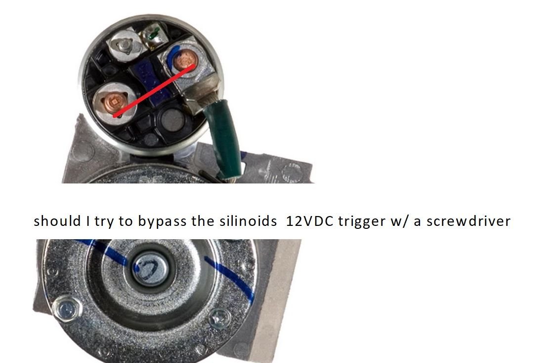

should I try to bypass the silinoids 12VDC trigger w/ a screwdriver in hope of unsticking it's internals? like this
please advice an thanks

I'm in the process of removing the pass front wheel and its wheel well an check if voltage is getting to trigger. which I assume is bc the starter is trying to turn.

I'm considering jumping /bypassing the siliniod w/ screwdriver like maybe the starter hit a weak spot. will report back

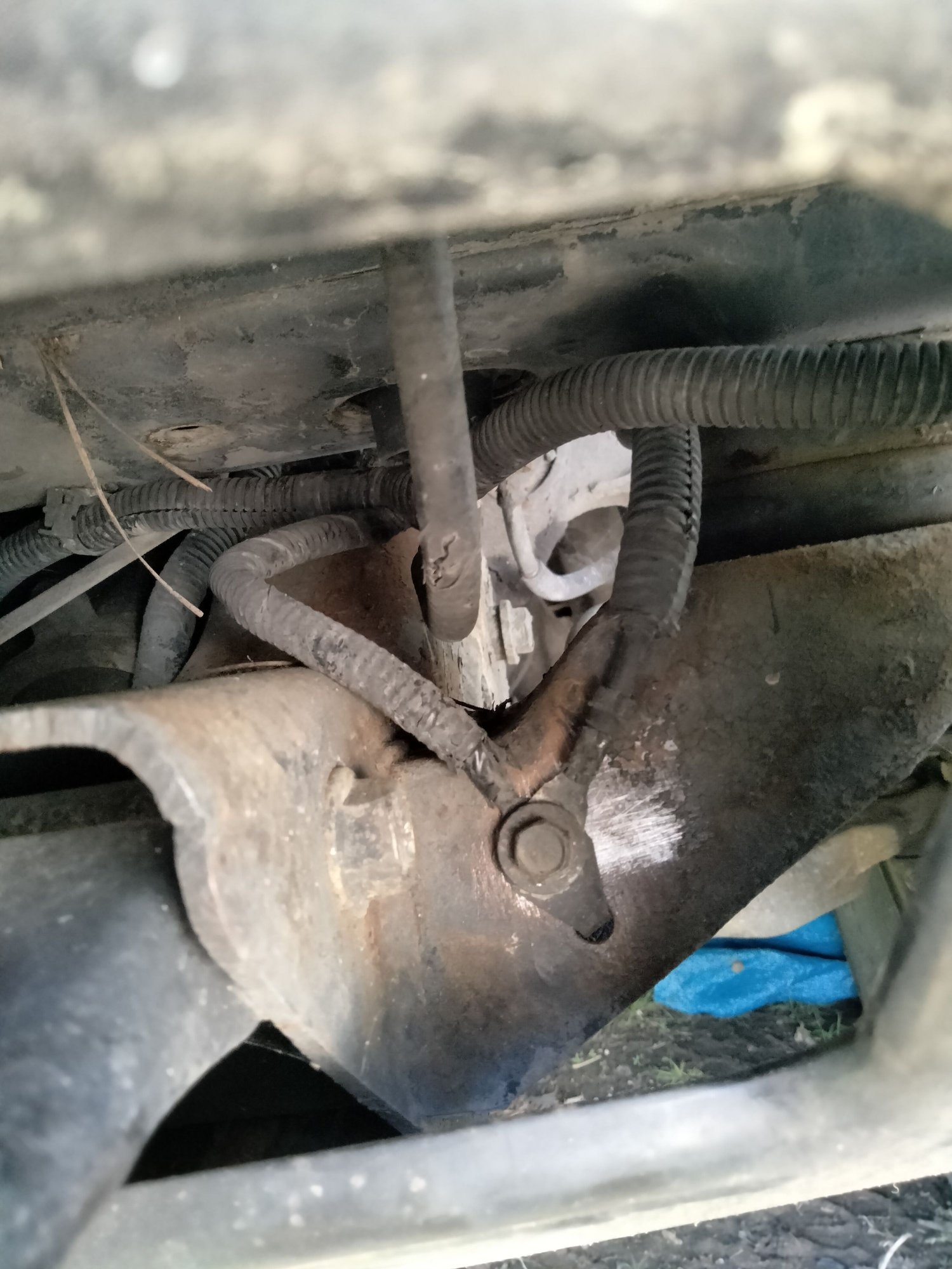

did you clean the battery main ground that is bolted to the engine next to the drivers side motor mount beneath the engine temp sensor?
no I haven't cleaned it yet. I assume the front skid plate must be removed (which I've yet to remove) to access this ground?
can I just add another ground from the frame to neg of battery?

you can get to it from above but the ECU cover and the power terminal are kind of in the way abit. you can see it if you look really good. you might want to also check how the power junction is looking like while in that area. but i quick test to see if it is ground related is to use a jumper cable from you battery negative to a good metal point on the engine block and see if it improves your issue.

battery pos spilt to alt an starter before cleaning an after clean the small alternater was about the same cleaned both
negative jumper cable to firewall ground
initially I cleaned the alternater bracket an clipped the temp ground there an neg battery.
I'll remove the nut off stud an clean firewall. still exact same barely trying to start for a split second.
I do now see where the batterys neg ground goes to middle of engine not very accessable to clean.please suggest where I can add another to the block. thanks bronxteck

there is a bolt hole higher up on the engine from where the battery negative is bolted that is free around where the power steering pump pressure line is so about 6" up from the factory ground. uses the same bolt and thread

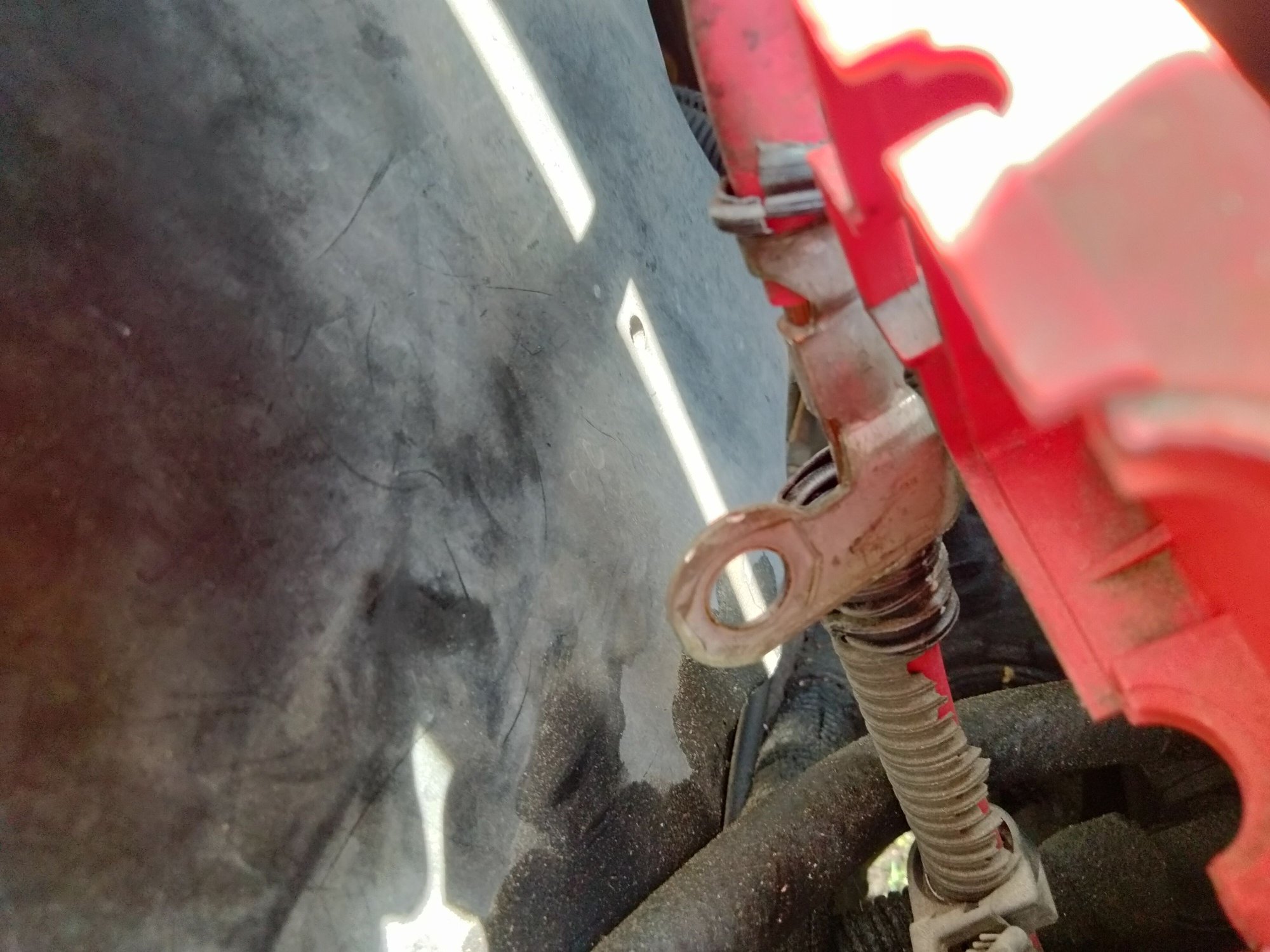

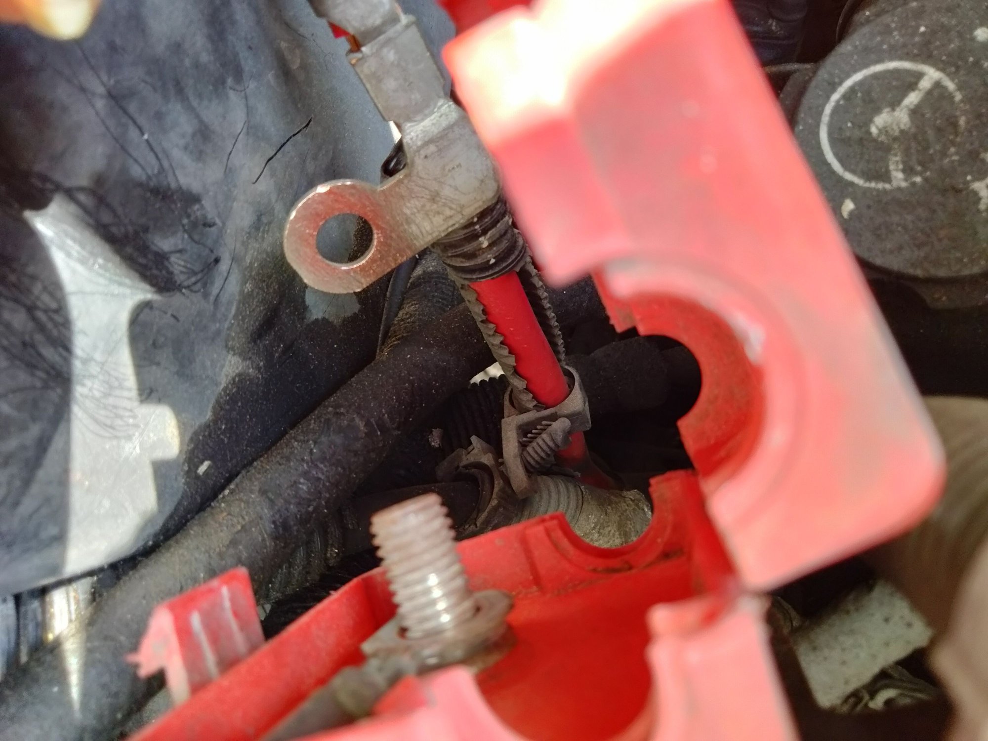

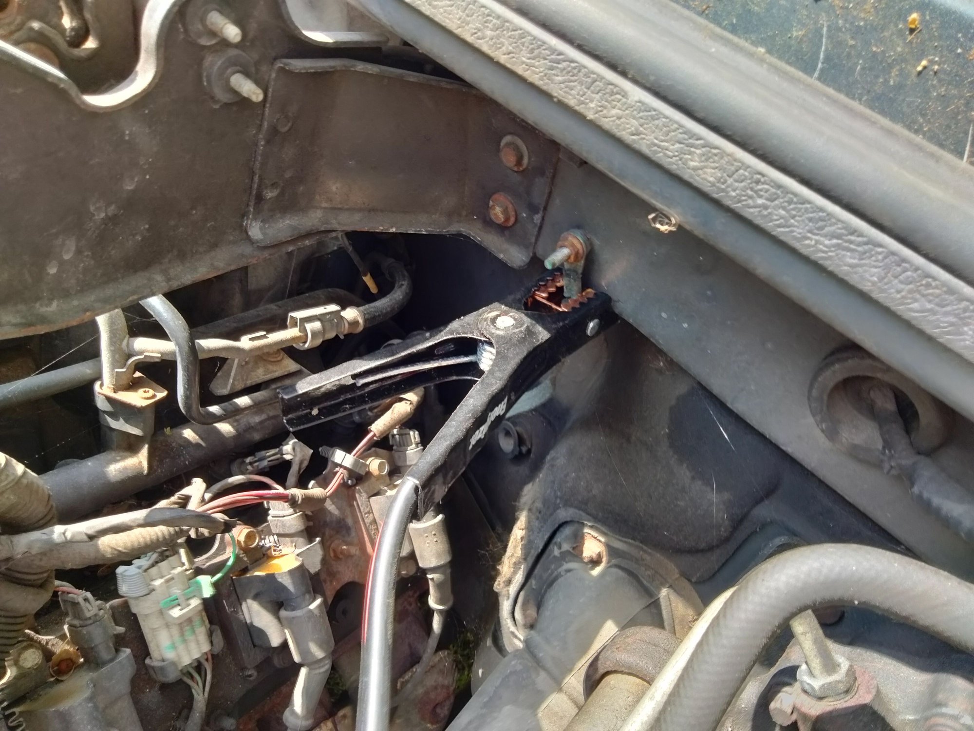

update: I kindof knew it was time for a new siliniod when I attempted to unscrew the triggers terminals nut the stud post snapped same w/ the 12VDC constant terminal. gonna be a pita to remove the snapped post inside the power cables lug.
broken off terminals
starter testing procedure I used plus testing for the constant 12VDC.will document for my notebook.
additionaley I didn't see a need to remove the oil capcity sensor at block,either skid protector as a ytuber mentioned removing this stuff. I do know it's always easier to remove than replace hopefully it's doable to replace same as removing.
I'll move starter forward out it's hole then downward an lay on frame while reconnecting the 2 terminals then diagnally up an back in it's hole.

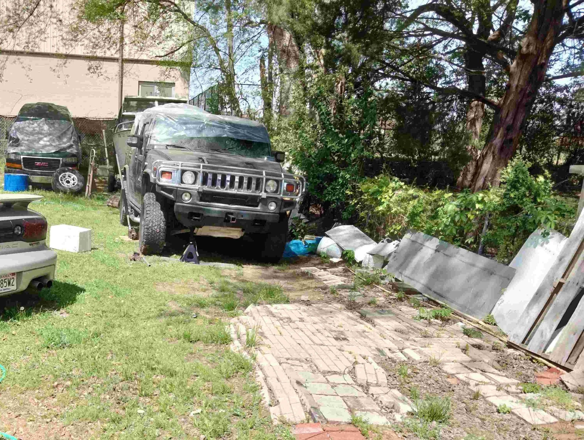

I have the 6ton jackstand just behind the recovery hook. place on 1/4" thick aluminum plate 2x4s under 3ton jack wheels.
