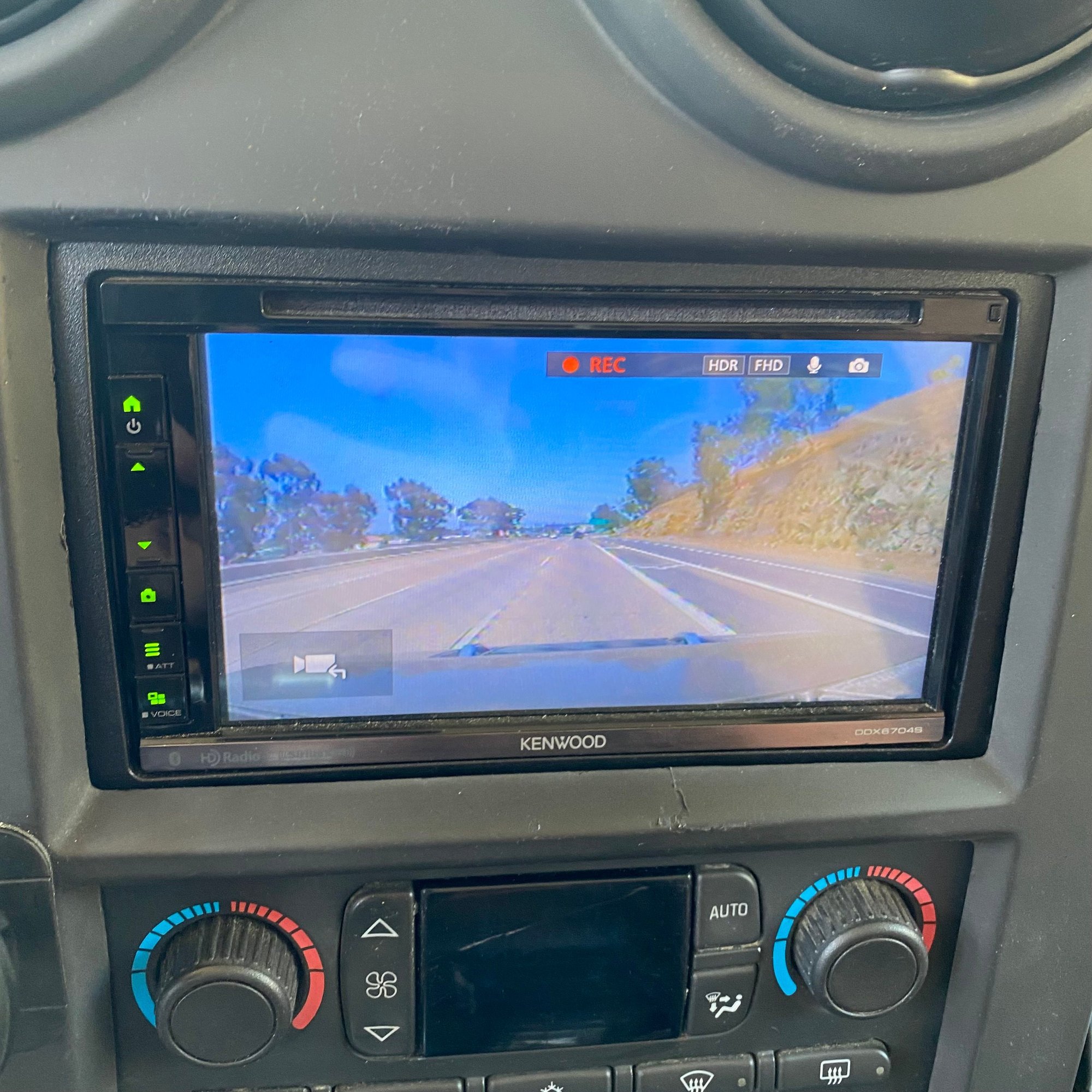

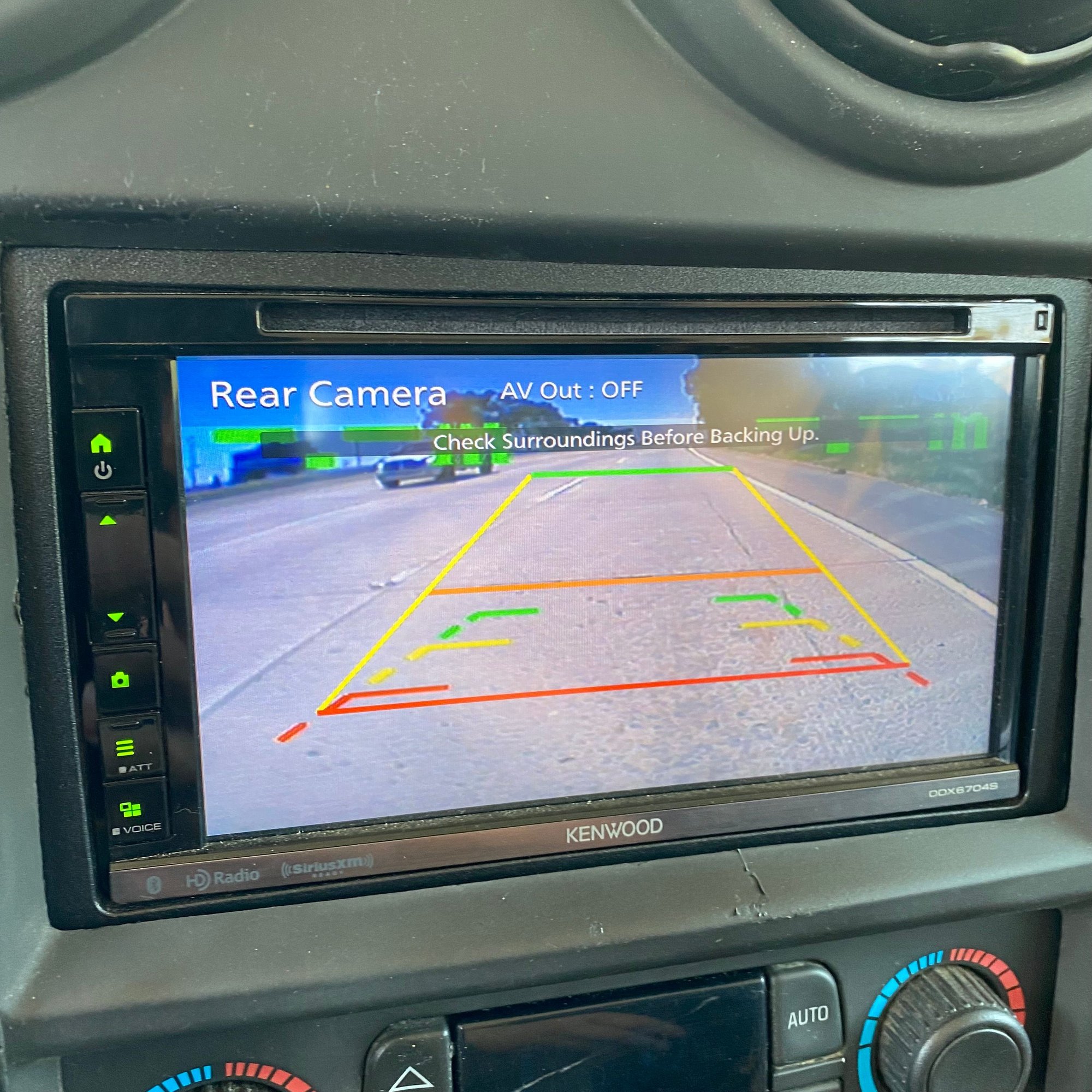

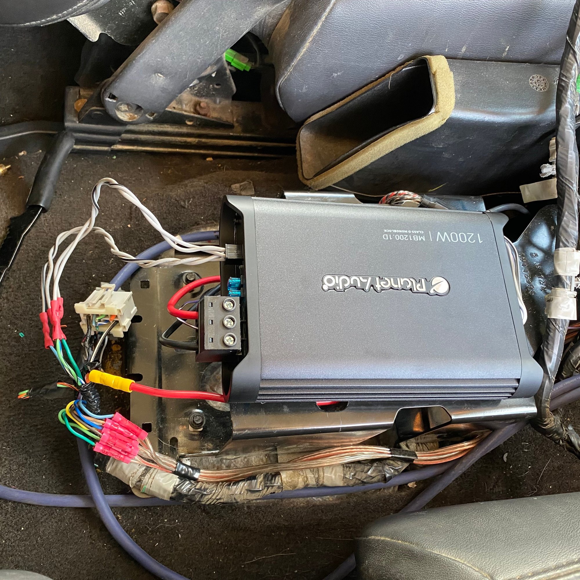

I finished this first phase of De-Bose'ing, the main purpose was to figure out why the audio system did not work while on ACC key position, Only on RUN Key position and also to install Front Camera DVR and Rear Back up Camera, While the head unit was out I ran Monster RCA's for Sub and Rears and Amp power remote wire. After finding and running ACC position power to the HU and installing the front and rear view cameras I got to checking the speaker set up that was already installed, Polk audio Momo Speakers on the doors and each has cross over connected to the A Pillar Tweeters and the rear most 4" Speakers so all eight speakers work and connected to the HU, now I decided to pull the Bose amp and find the Sub connections, once found I tested with a 9V Battery and was able to hear it, it is dual voice coil and working, So I set to find an Amplifier that would match the Sub and ordered it fingers crossed the sub wasn't blown and that the amp could handle. during the wait I finished tucking and tying the cameras wires. once the amp arrived i got to testing it and surprisingly the sub is working and sounds amazing for it size and definitely compliments the rest of the system. Pretty happy of the outcome. Now that I have RCA Rear ready I may start to look for the recommended Hertz Speakers for the rear doors thanks fxgrnd38 and a amplifier for them. also will see how the Sub does now that it is bumping or will look for a replacement for it also for the next phase.
