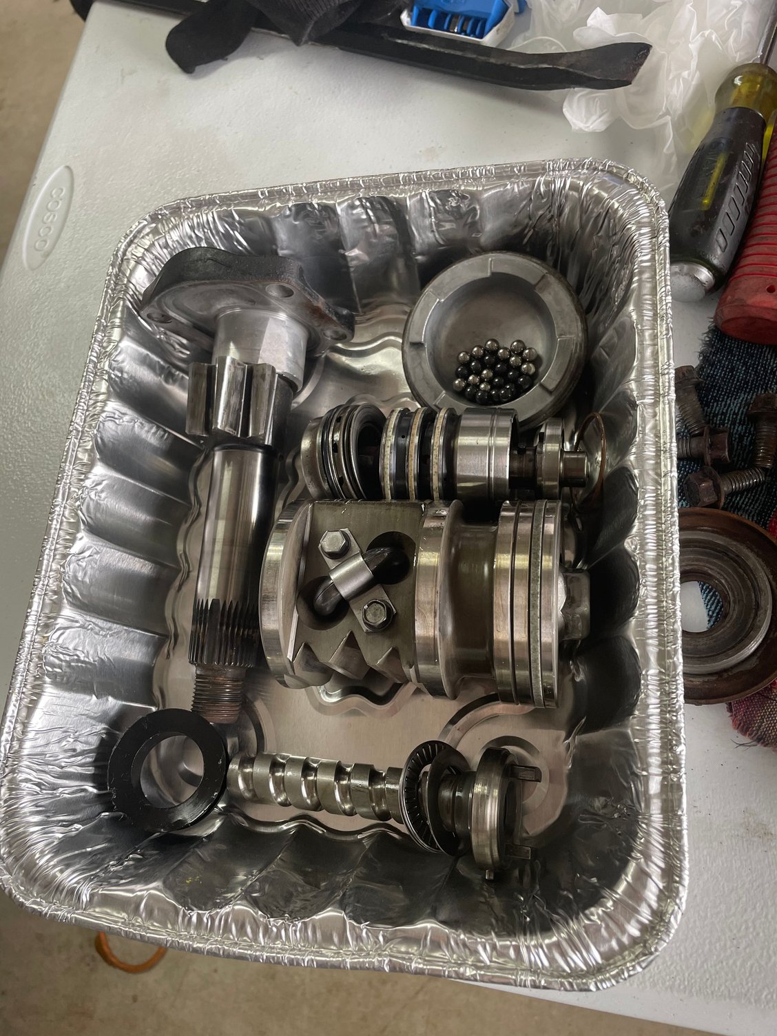

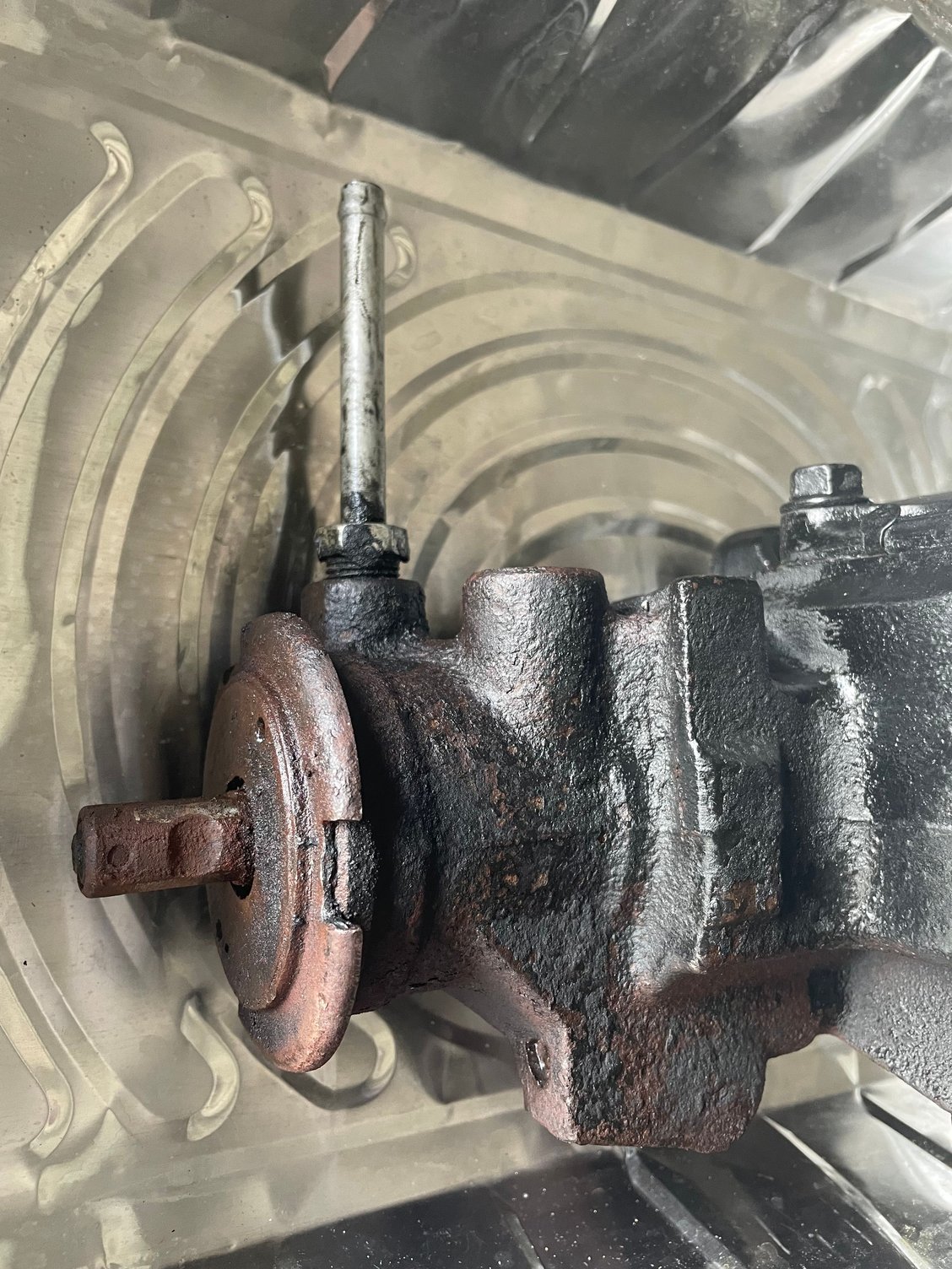

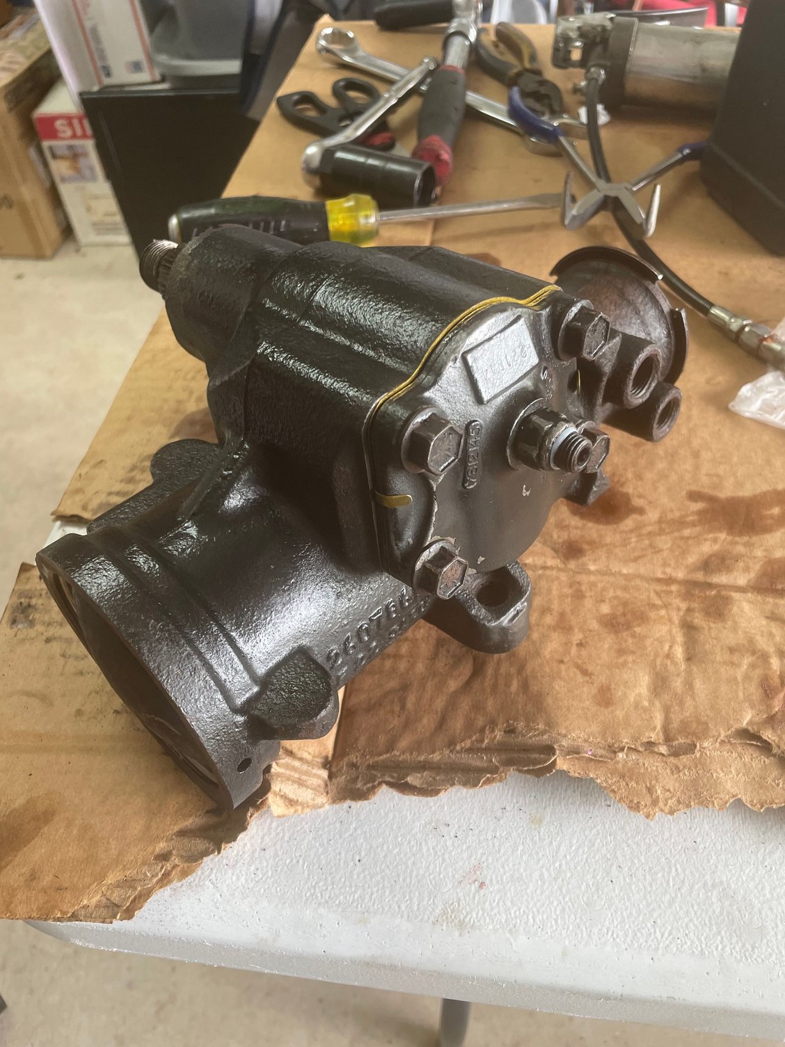

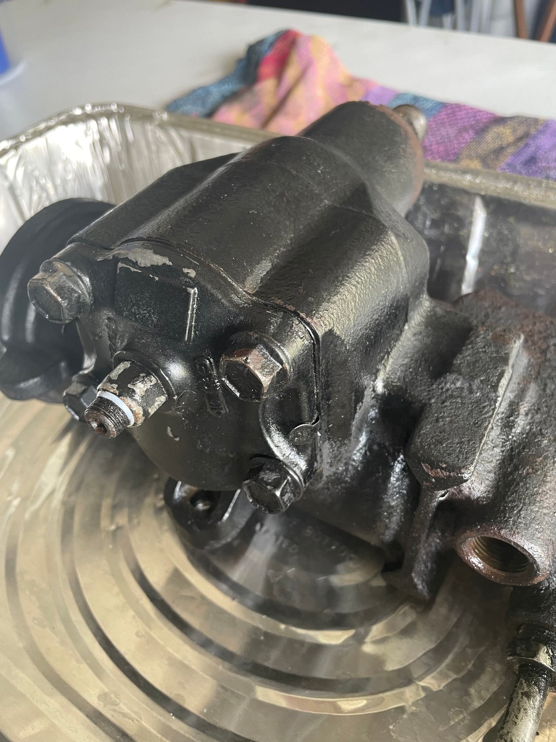

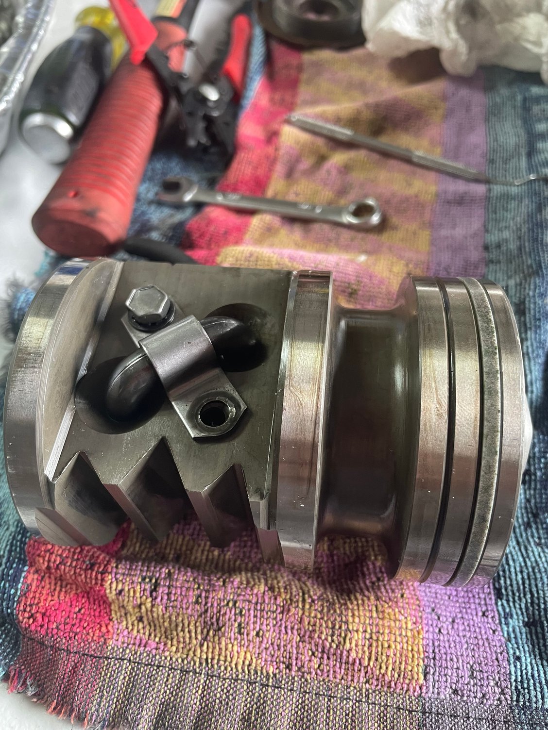

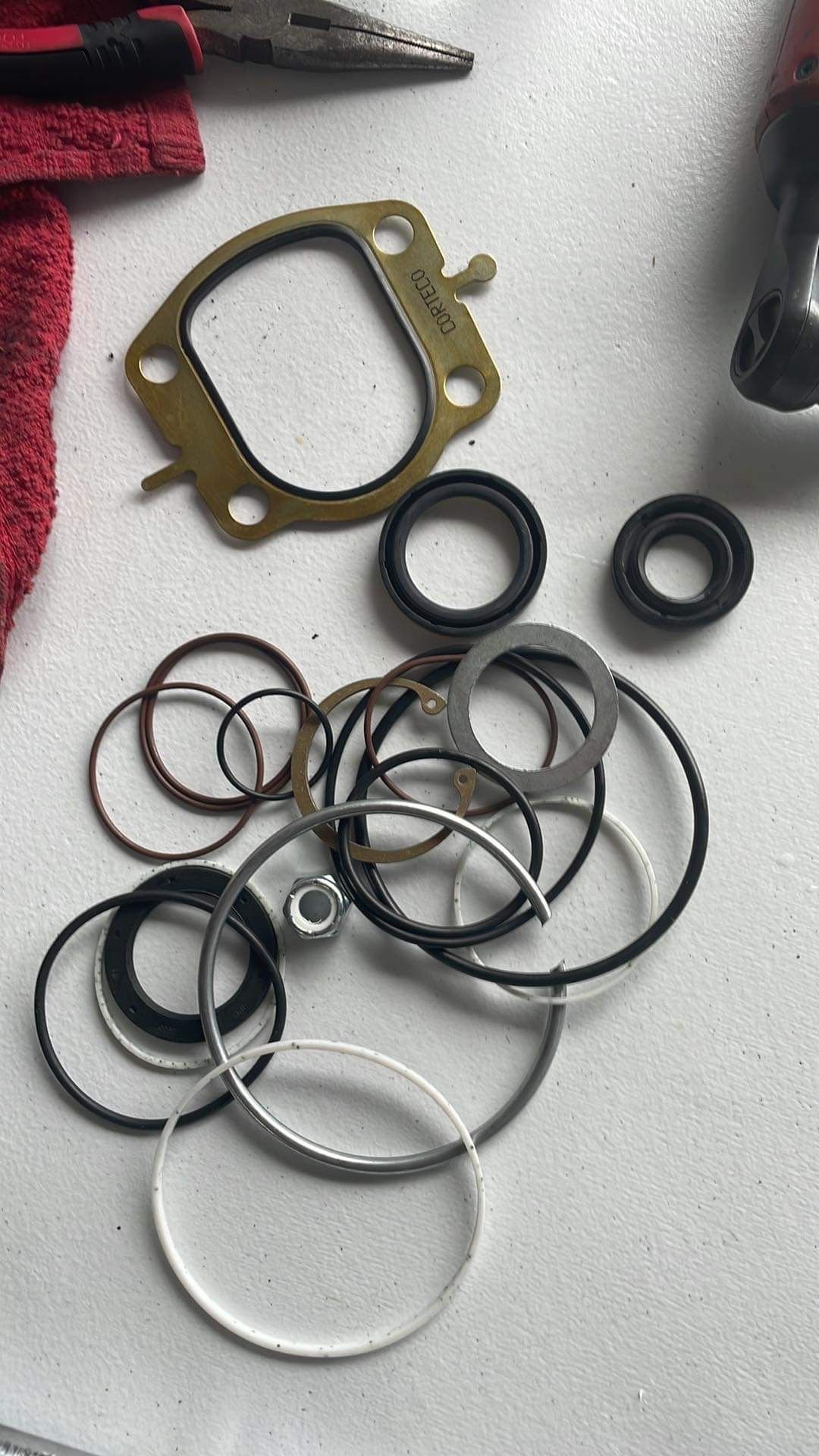

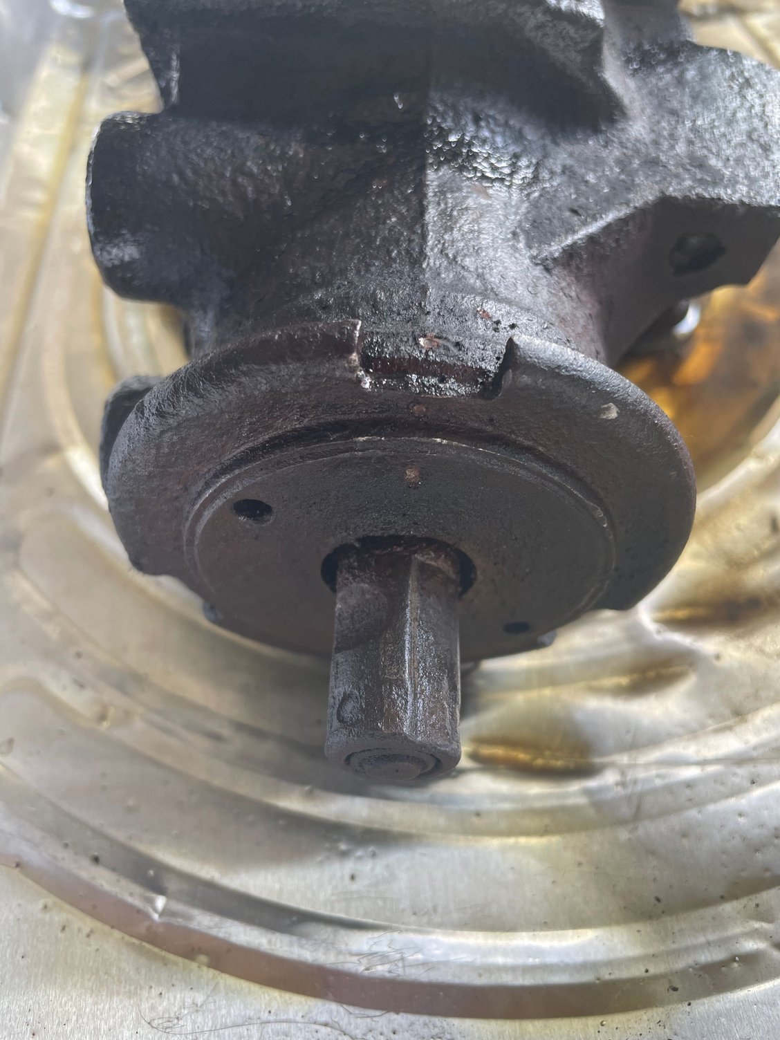

Decided to rebuild the power steering box as it was leaking fluid. Was a fun project, learned a lot and could rebuild another one fairly quick. there were some lessons and tricks to this; thanks YouTube for the endless videos/resources. Let’s see how it holds up. Some pics:
Ready for some work
Made some marks before disassembling. After it was put back on marks were lined up.
Cleaned up parts. used gasoline and a brush.
New O rings
Ball bearings in with grease to hold in place.
Ready to be put back in.
Rebuild.
New hardware.

Usually steering boxes are just worn out and require more then just o-rings and gaskets. Redhead Boxes are a great source for a bad steering box. They do a great job in replacing more then just O rings and gaskets.
I used one in my old Tahoe, it was expensive but bullet proof. (this was after purchasing a Cardone rebuilt unit that was total trash and failed within 2 months, sometimes you get what you pay for)
