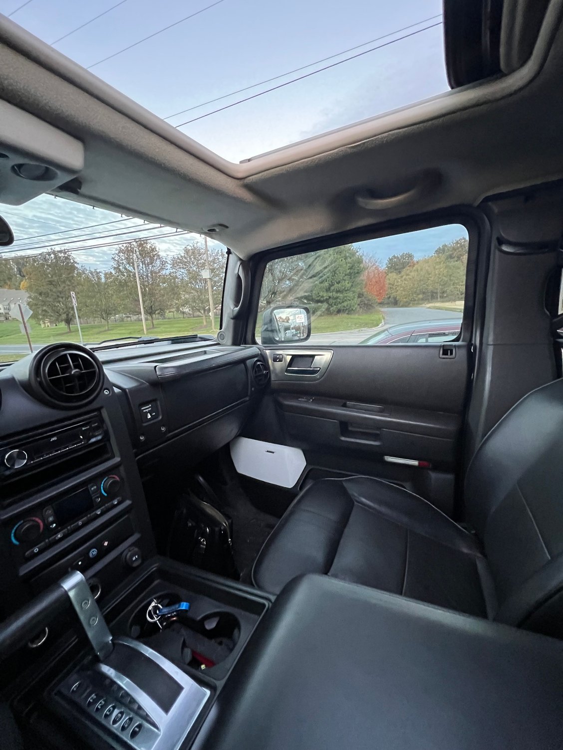

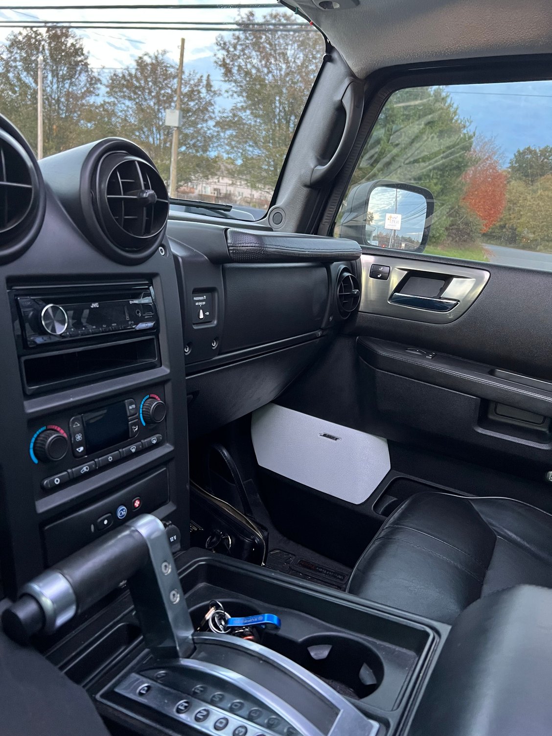

Old Nov 4, 2023 | 09:39 PM
Lifestyle's Avatar
Joined: Dec 2022
Posts: 13
Recently finished swapping 2009 door panels into my 2005 SUT. Wiring was for the most part wire for wire with the help of both the 05’ and 09’ wiring diagrams.
problem I can’t solve is the window module. The 05’ uses a class 2 serial data line to communicate and the 09’ uses a GNLAN low line. Basically both the same but one uses a 5v pulse.
does any one know how to get these to work?
