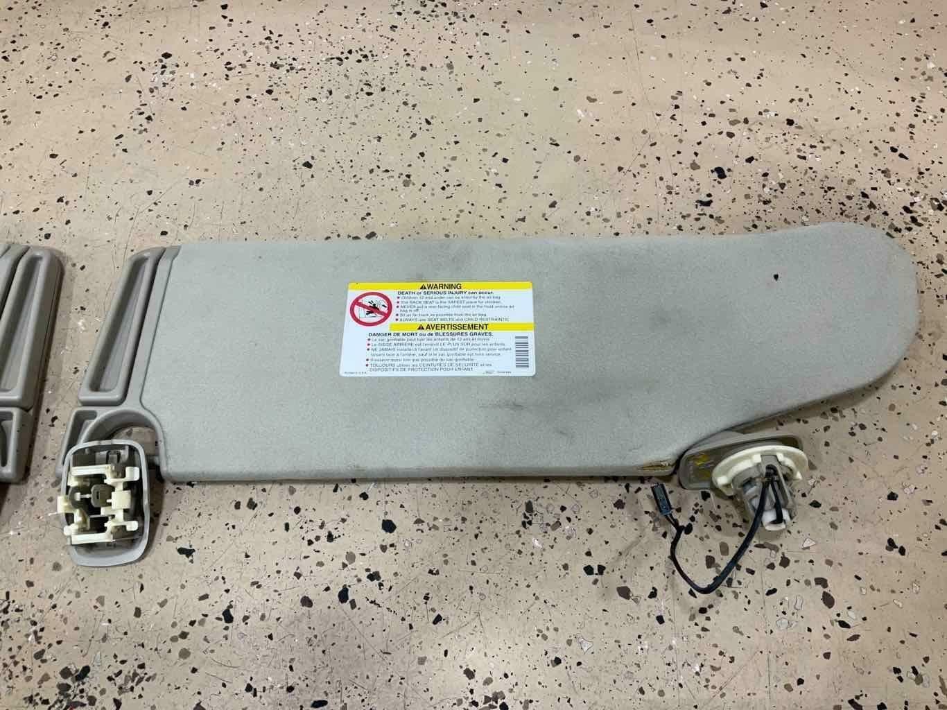

You may want to read up on removing the sun visors, as the clips are a pain in the *** not to break.
Old Jun 14, 2022 | 06:27 PM
Good point. I'd go so far as to say they that the visor attachment, in particular the swivel end, are a total nightmare and are a top candidate for the most aggravating and horribly designed parts of the entire vehicle and potentially could make it into a top 10 list of GM's worst engineering screw ups.
LOL. I have delayed taking out my headliner to put in rubberized sound proofing on the roof, just because of the sun visor clips.
I'll get to it this summer as I'm still chasing water leaks and would like the headliner out to do a thorough water test. Pain in the *** sunroof.

Excellent advice. I wasn't aware of that minefield lol.
I have a headliner removal video on YouTube bookmarked and I plan to watch it several times. My headliner is in really nice shape and I don't want to damage it either.
