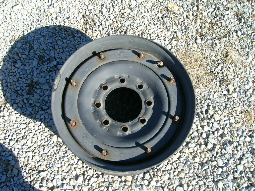

Lets start with the start of the H1 wheel.
The first wheel was the 8 bolt.
This wheel had 8 bolts to hold both the outer ring and the back half of the wheel together. I will start to cover "which is better". It all comes down to who you ask and what their reasons are. We like the 8 bolts. For many reasons. #1. It's the lightest of the 3 wheels. It came stock with a mag runflat and a 36" bias ply Goodyear tire. This tire did great in the mud but was not known to hold up well on the highway as it had a high crown to it (higher in the middle than on the outside). This tire gave the feel of your front end being light as the footprint until either aired down or on a very heavy vehicle was narrow. 36" tall. 12.5" wide and for the 16.5 ring was the 8 bolt wheel.

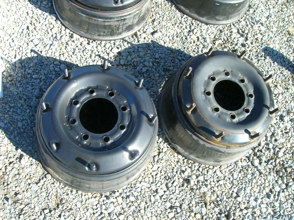

This is the back half of an 8 bolt wheel. The nice thing about the 8 bolts is the fact that your WMS or wheel mounting surface is on the shell (the back half) where the ring is just that the outer ring.
The silver part is the outer ring to an 8 bolt wheel.
Showing the two picture together after paint just so you see the ring and the back half as the other 2 style of wheels are not made/put together the same.
This is a mag runflat. They have 4 bolts that hold them together. These were use with the 36" bias tires and are a pain in the @ss to use on the 37" tires as the bias tires had a thinner bead.
