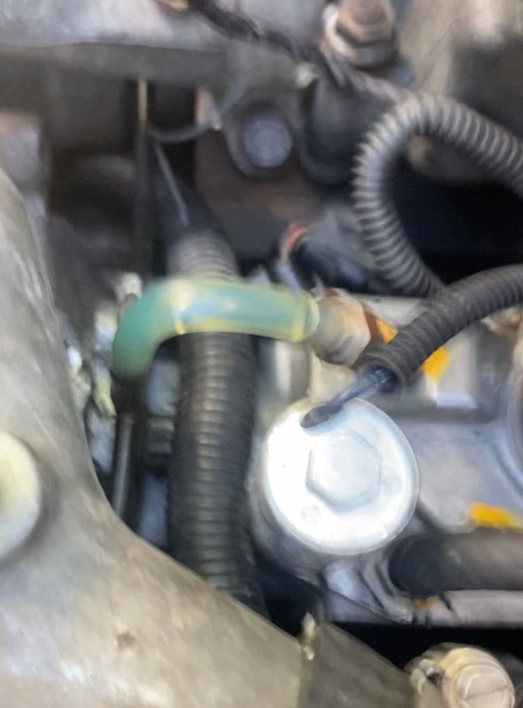

Ok I’m lost. 1997 H1 IP was recently replaced. Ok at first. Now hard starting Code p0251( inj. Pump cam signal) sets current as soon as it starts. No air bubbles in fuel return. Doesn’t seem like TDC learn is working. Followed factory trouble tree leads to replace PCM. I’m uncertain if I may have missed something also can’t locate a PCM. Would a PCM from a 6.5 turbo diesel Chevy work?
