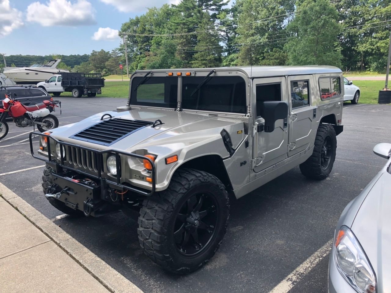

Post pictures of the side view(front to back, both sides) of your wagon.
Old Jul 24, 2020 | 09:36 PM
Rennguy's Avatar
Joined: Jul 2020
Posts: 4
O
