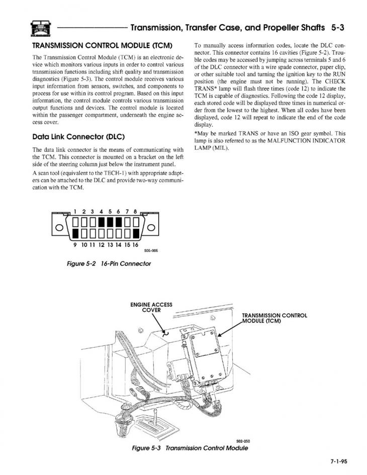

A 1995 is OBD 1. It will only monitor the transmission for that year truck with a NA engine. You need a Tech1 or equivalent to read the codes. It should have an OBD1 type connector. Sometime in late 1995 or early 1996, Hummers went through a transition where it had a OBD1 TCM with an OBD2 type connector. This connector is just below your left knee on the plastic kick panel unless moved by prior owners.

Here is how to get codes via blink method
Gil
