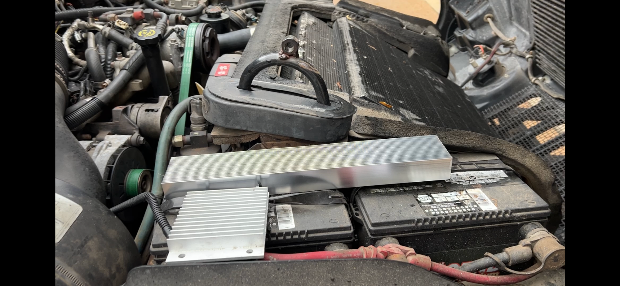

Got the ModMafia Dual PMD heatsink and battery tie down bracket installed today. Had it sitting for a couple months in the garage and finally got time to put it on. I gotta admit, it’s pretty nice. Very nicely machined and the anodizing seems well done. And it was a perfect fit. Video of the install if you’re curious how it looks and fits on the H1.

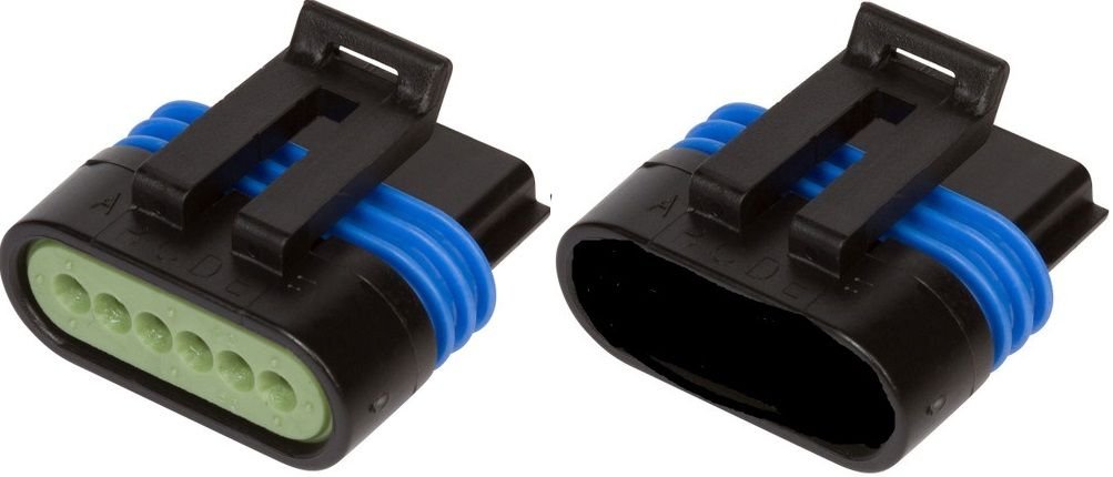

Made a pigtail dummy plug for the spare PMD to protect the terminal and connector from the elements. Took 5 minutes and well worth the effort:
https://youtu.be/X1Myjjgn-jE
Why not remove the terminals and seal the end to make a true DUMMY connector?
A Metri-Pack 150.2 6 Way would be a better solution so there's no wires contacts connected, just seal the exposed end where the wires enter:
You know, you are so right!! Sometimes I guess I overthink things. Just ordered the connector and will redo it. Thanks for the suggestion! :-)

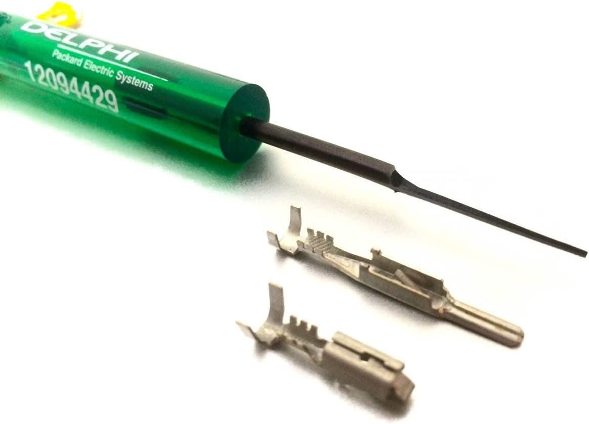

You already have the connector just de-pin it.
Dangit, you and your common sense :-) hehe.... I need more coffee this morning
