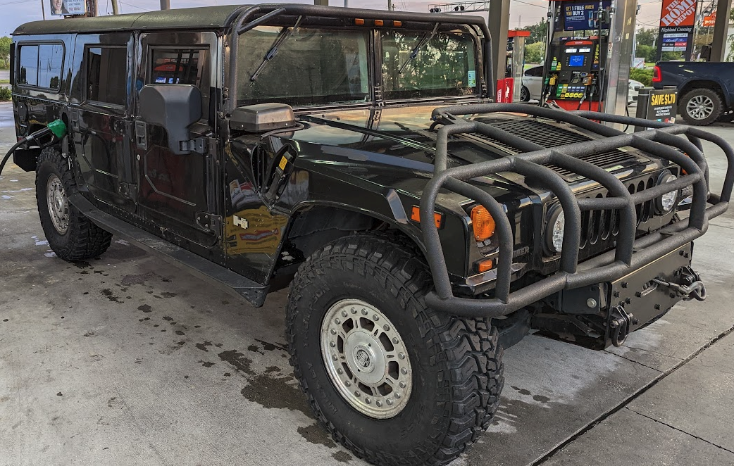

Here is one photo from the day I picked it up from the old owner and stopped for gas.
