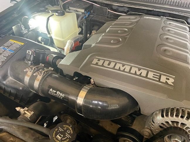

Old Dec 10, 2024 | 01:22 PM
Well Taint, you got me thinking... Almost hurt myself with all that .
I tracked down a nice GM 15990293 and/or 15528774. Ebay has them going through often, most are overpriced, some are in excellent condition with the harness connector and lead wires intact. The Positive wire lead is a light/faded orange, so I used orange 18 AWG hi temp wire. The ground lead was almost 2 feet on what I bought no wiring needed for ground.
Went all out on a set of four 1156 LED bulbs so I got an extra in the glove box and more in the garage.
LED 1156 Bulbs LED 1156 Bulbs
Then spent some time finding a mount location that made sense for my H3 Alpha. Made a mount bracket with a piece of 5" wide 1/8" this 304 Stainless Steel plate I already had. If I had to buy the plate now I would just go aluminum as it is plenty strong, the GM Underhood lamp reel is not heavy, and stainless prices are ridiculous now. Took a bit of license with the idea from Outfitter Design's H3 On-Board Air Mount to use the Air Filter Box Bolt location for one attachment and that same 6MM fender hole for the second.
I am happy with my results and that little bulb is bright as all get out. Mine has the light base magnet intact so it cam be stuck almost anywhere when needed.

Old Dec 10, 2024 | 02:55 PM
NICE WORK DOC!
Mine is in that exact same spot with my ARB diff/trans/Tcase breathers.
With the LED modification that sucker is BRIGHT isn't it?
Brightness surprised me, better than expected!
