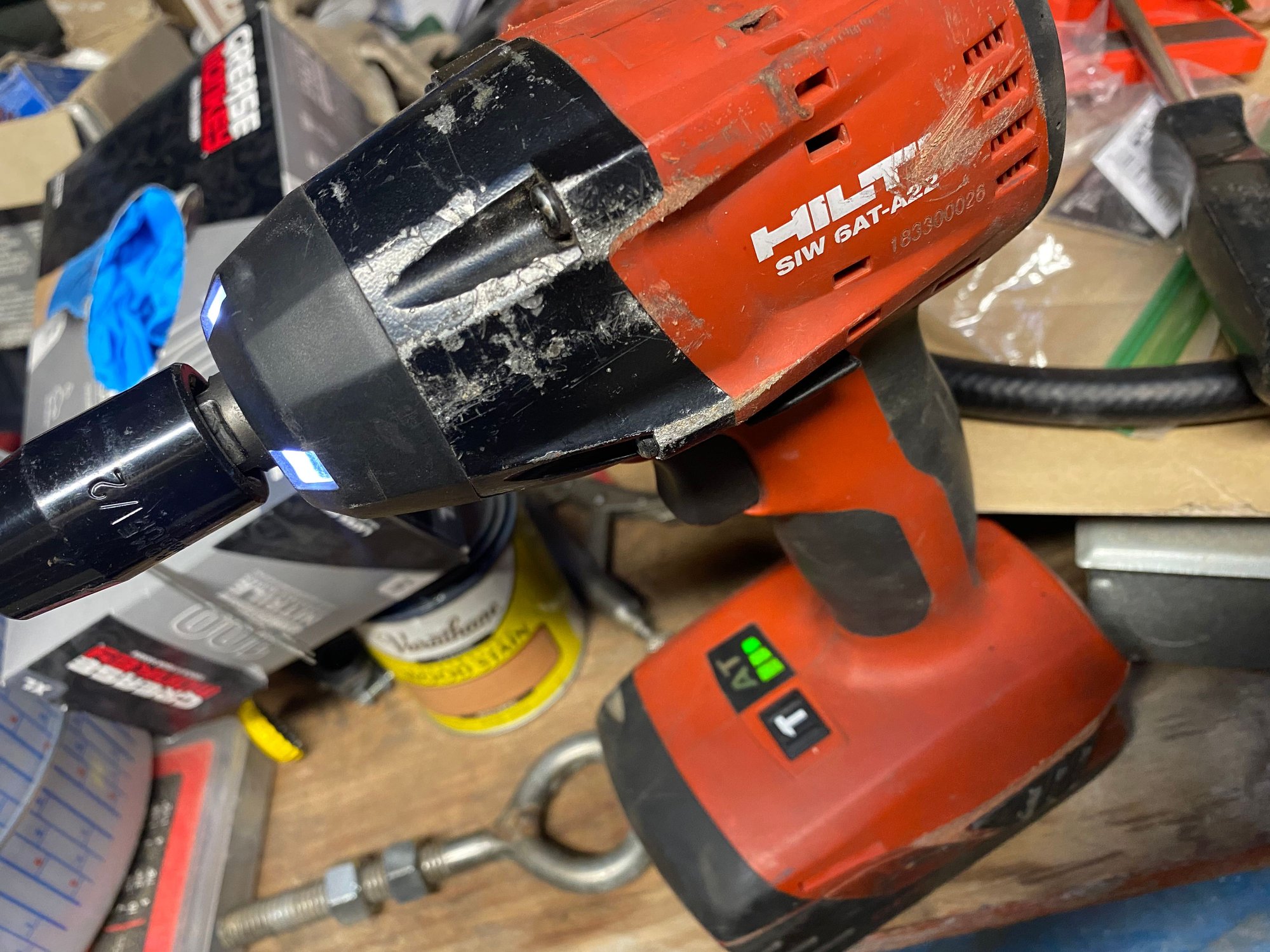

Just took a wheel off and put it back on, here are the results:-
Lug-Nut Removal
Mode 1 350ft.lbs - Just couldn't undo a nut after 5s
Mode 2 450ft.lbs - Removed nut within 5s
Mode 3 550ft.lbs - Removed nut between 05s and 1.5s
Mode 4 550ft.lbs - Worked as described, undid the nut then backed it out at a good-paced constant speed, nice feature!
Note I did this straight-off without checking the nuts 1st as I didn't want to disturb them, I then torqued them up to 140 and repeated, the was no noticeable difference in tool's operation.
Lug-Nut Tightening
Mode 1 - Tightened to approx. 40ft.lbs
Mode 2 - Tightened to approx. 100ft.lbs
Mode 3 - Didn't try just in case.
Mode 4 - 30ft.lbs Max - Quickly wound the nut in then stopped as soon as it hit 30ft.lbs, again nice feature!
I also undid and exhaust flange nut as in the past these nuts proved very difficult to remove.
