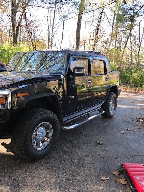

I have plans to do some customizing on my H2. I am curious about others who have experience with Plasti Dip and Line X on their vehicle parts. I took the rock guards off due to some rusting and plan to have them refurbished. This is my starting point. I am planning on eventually painting the truck matte black at some point, but I have noticed you can also have them Plasti Dipped or Line X added. What have others done and what works?

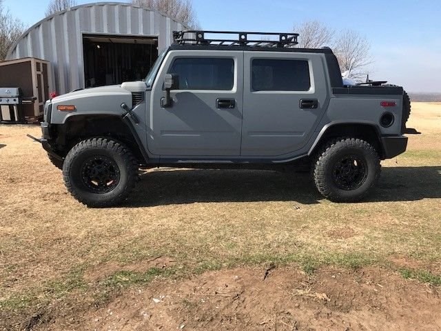

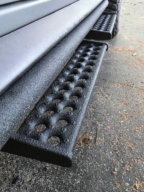

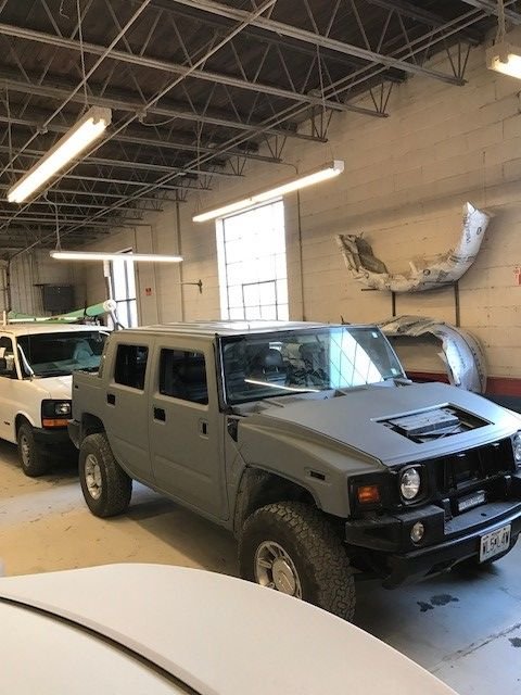

I will try again. About a year ago I completed my project on my H2. It is a 2007 H2 SUT that I had painted flat gray (not primer). I wanted it a little darker, but it is what it is and I'm ok with it. I considered Line X on the whole vehicle, but after talking to the Line X guy and seeing a pickup that had this done, I chose not to. The pick up had faded and was stained due to road salt/brine in this area (St. Louis). I had the rock guards blasted, primed and Line X put on them. I had some custom steps made, blasted primed and Line X sprayed as well. I had the chrome parts such as the grill, hood handles and door handles wrapped with a flat black wrap. I tried the various ways to paint it with little luck. The chrome pieces that could not be wrapped due to shape such as hood latches and mirrors, I used Plasti Dip on. At this time it all still looks good.
