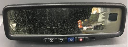

ACDelco 94725971 This mirror is listed only for the H3T, not H3.
The silver mirror backing is spotting. Is there a way to just replace the glass, and if so, a reasonable place to source the glass?

probably could use one out of a taho or escalade or any that look like it.

Thought I’d follow up for anyone else. $135 repair glass only replacement from Bob's Automotive Mirrors includes shipping back. He repaired it the same day it arrived to his place. Only difference is the Temp Compass window, but it shines through just fine as does the rear camera.
Before
After

does it still auto dim?

I don’t think the sensor is behind the glass so I have no reason to think it wouldn’t. I can test that this weekend though.
