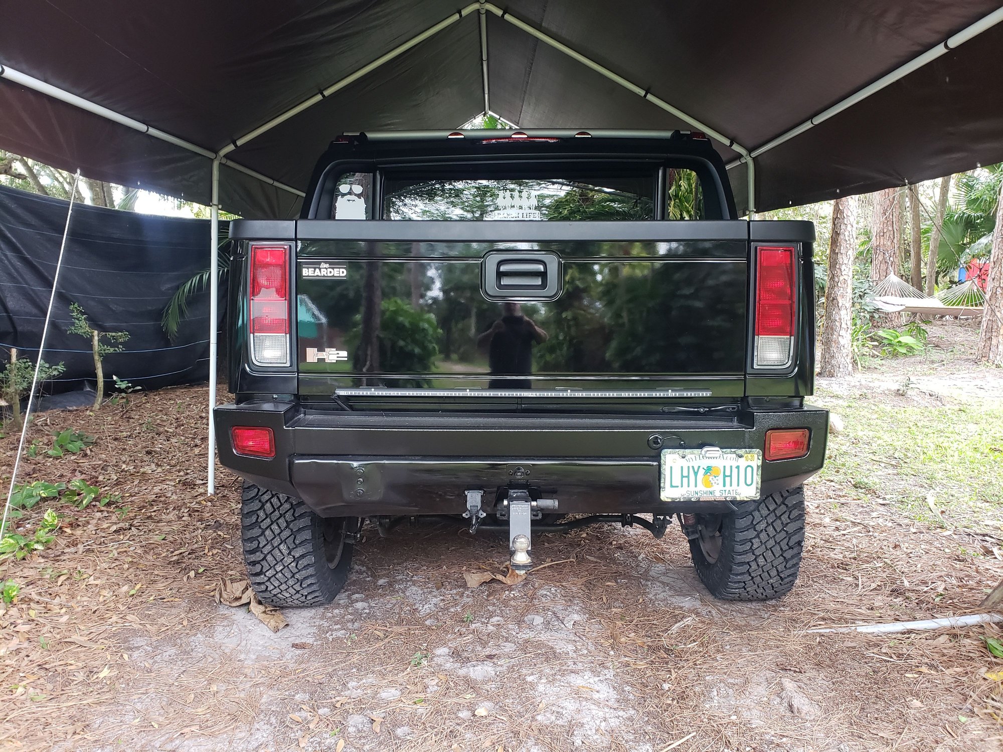

Pull the carrier, replace the bolts and buy a license plate holder and trailer light on Amazon. $20.00 and a couple of hours and your good. I attached a pic of the back of my 07 SUT after removal of the tire and rack. Good luck!
The back of my 07 SUT less the spare tire and holder.

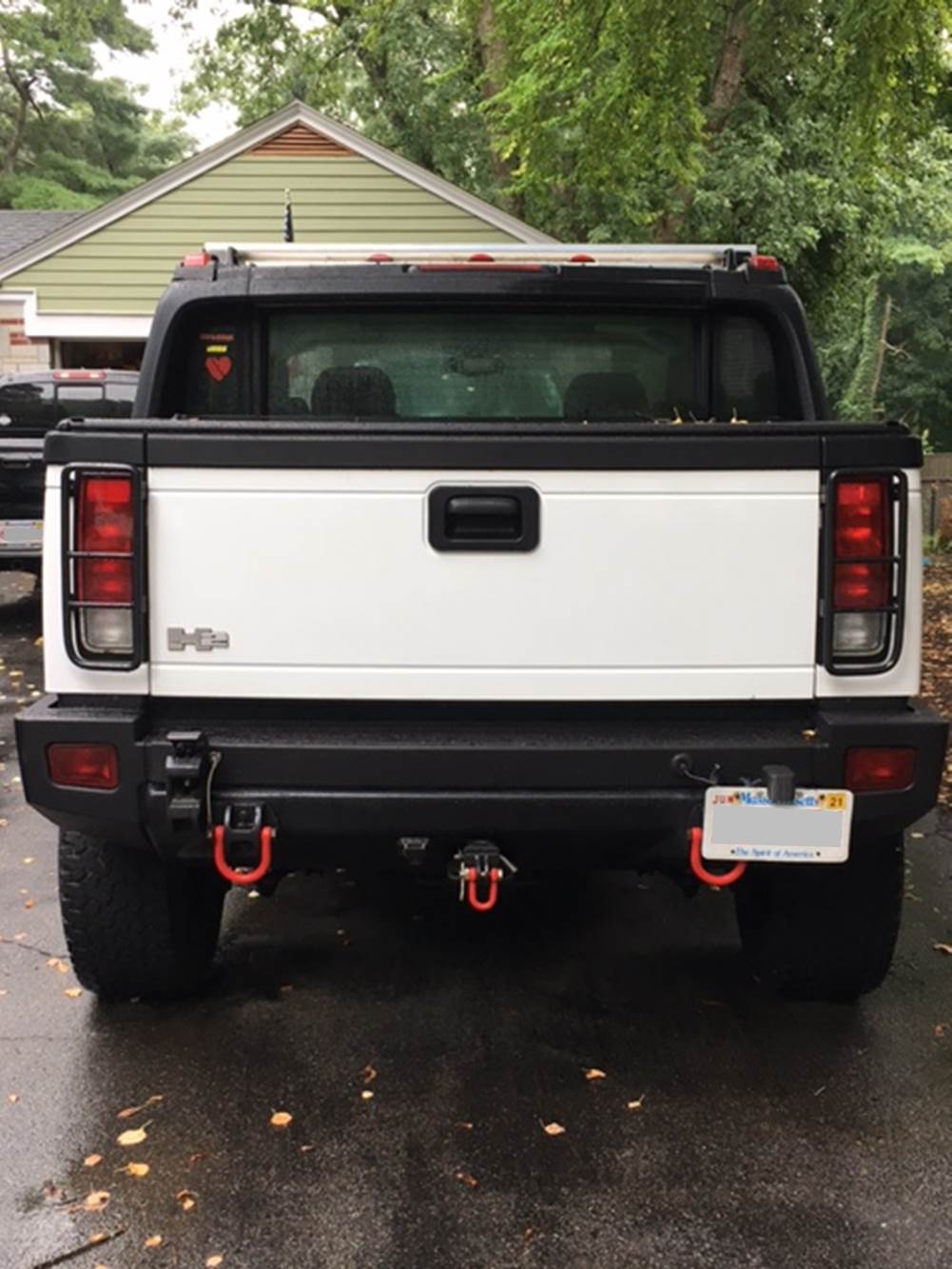

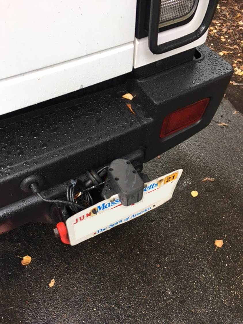

I designed and 3d printed one that uses the OE shackle mounts (and spare tire pivot). I could post files at Thingiverse or email them to anyone who wants to make their own. Just need a length of pipe to fit the pivot bore.
It maintains the original lamp which resides inside a small housing on top. I printed it in a carbin fiber reinforced nylon plastic and painted some of it with Rustoleum semi-black (I should buy stock in Rustoleum).

Here are a couple of more shots: (small hitch shackle is from Harbor Freight painted with red Rustoleum (I should buy stock in Rustoleum....)

very creative looks great and solves the problem. nice work.
