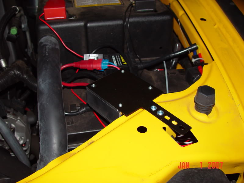

Here's where I mounted my ballasts:
Lights on:
Bieng that the BCM controls the lighting systems I don't think you'll be able to get the high beam systems to work...not sure cause I never tried it but I doubt it. Also the reason the systems for the h3 are not true plug and play is because the H13 plug is still under patent so no aftermarket companies can make them...thats why you have teh spade connectors. As far as changing the fuse, you should not have to change out the stock fuse to a higher wattage one. If you are blowing the stocker then you are doing something wrong or have defective or cheap stuff.
